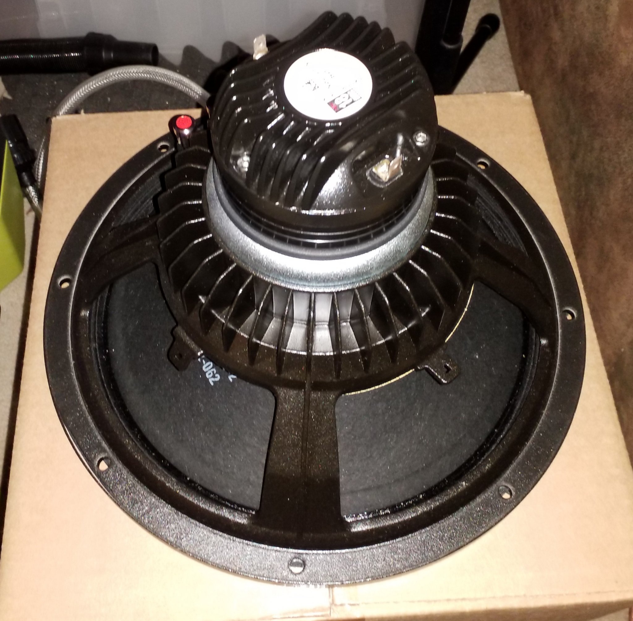

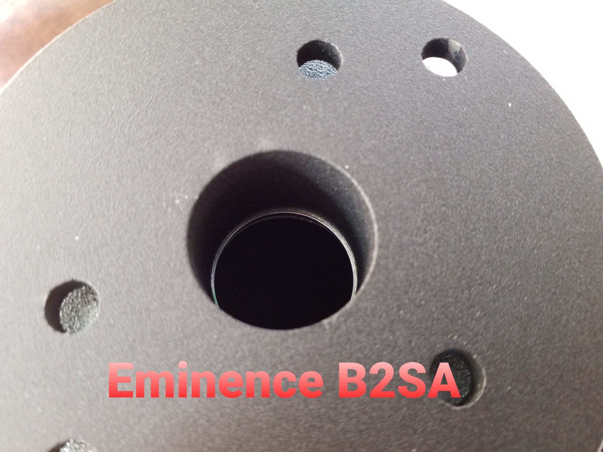

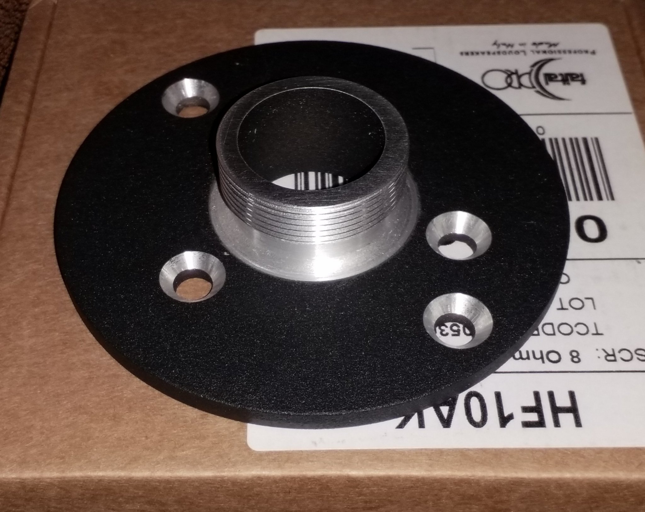

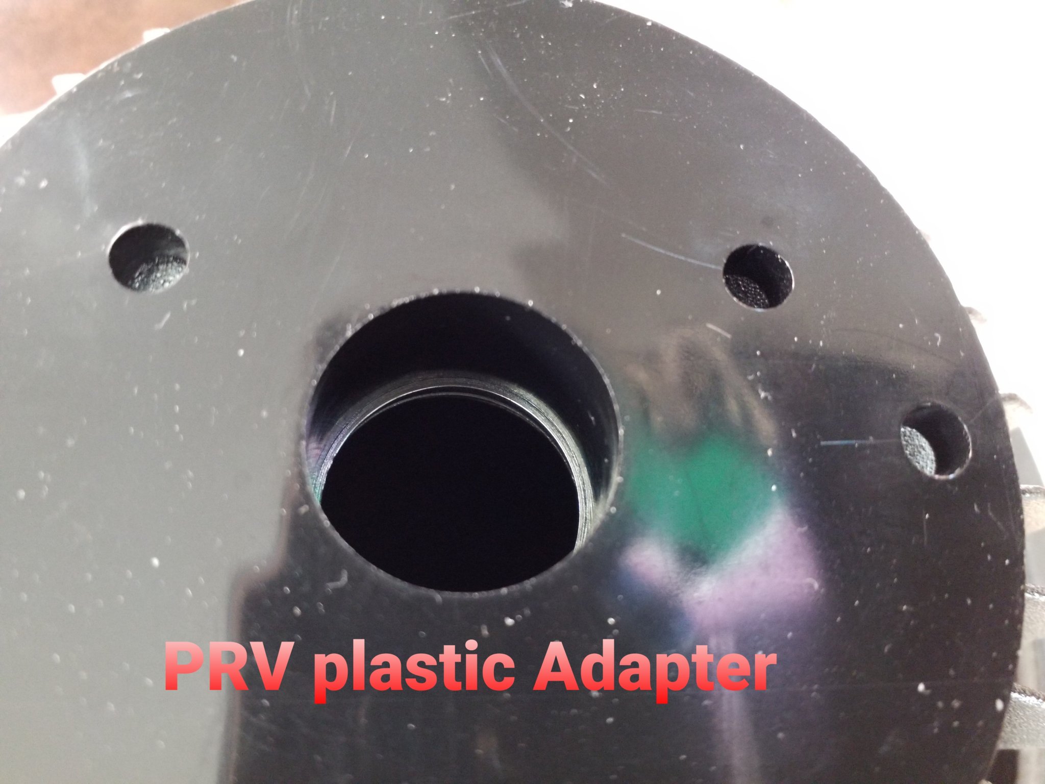

So now I have three different brands of screw on adapters (Eminence, PRV and some no name type) to make all my bolt on drivers work, but there are some let downs so far with the way the adapters run larger than the KL3021CX driver throat opening diameter. Its not just the adapters either as some screw on drivers also fit this way. Not sure why Eminence machines their screw on driver stuff to fit this way, but I'll have to at least get some measurements done to make a driver choice and get a crossover thrown together. My large 3 way project is taking much longer than I want, so I need at least something to get by while everything's in disarray.
That sounds strange. Could you measure the length? I have had no such problems with the beta coax and the eminence 1” tweeters APT50, ASD1001 and PSD2002 fits right in there. I did struggle a bit with the Selenium though but that was more on the thread size itself it seemed - not as smooth to screw in.

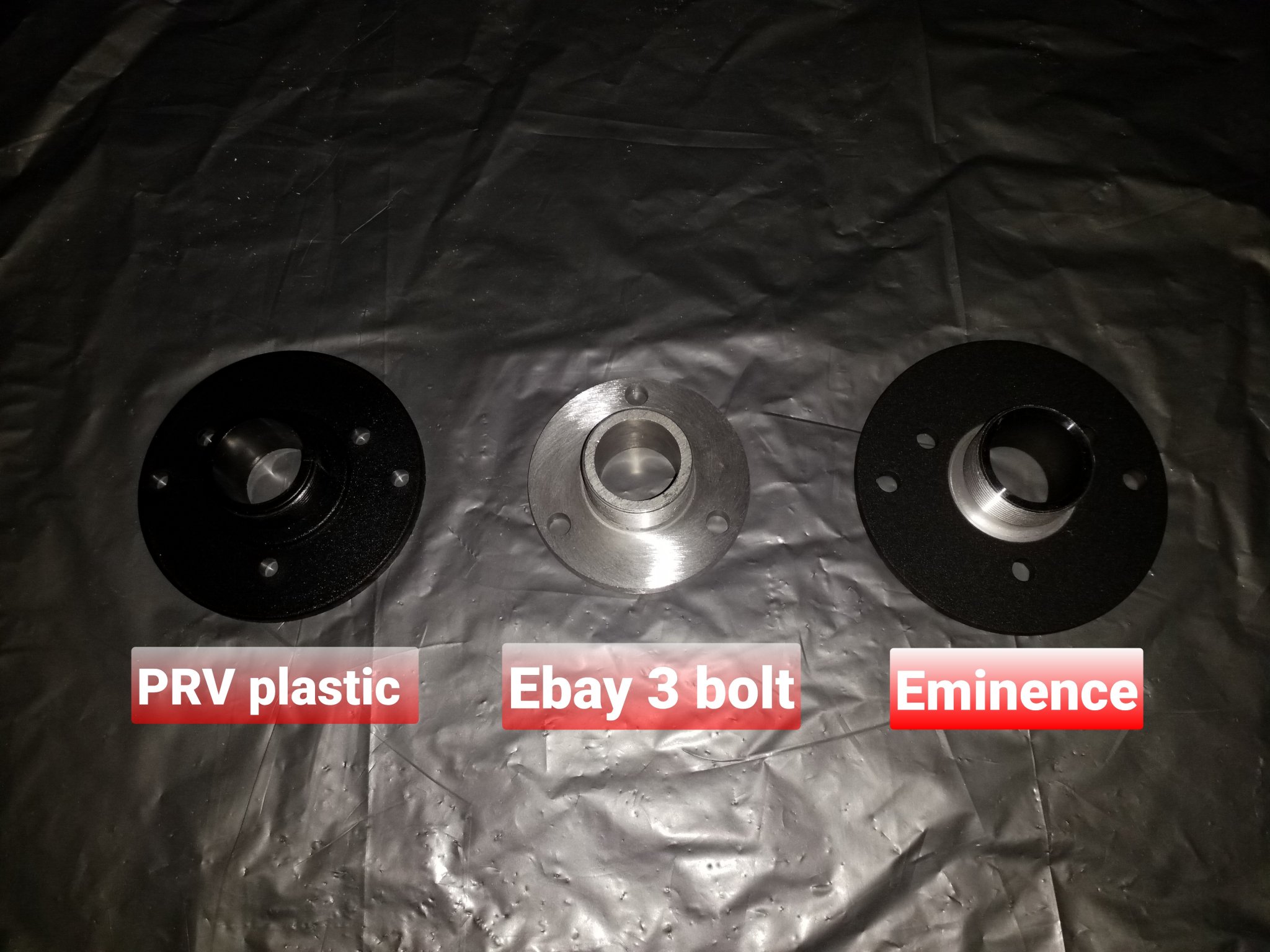

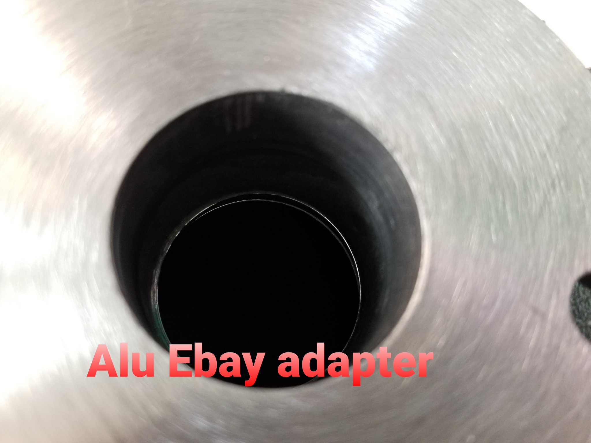

Here are the main 3 adapters i have. The best fitting one is the generic small 3 bolt adapter from a Chinese Ebay seller, which ended up having less than a .010" step inlet). Ironically its the best machine work of the 3, even compared to the Eminence B2SA. The worst one was the PRV plastic ABS adapter, yielding about just a little under a 1/8" (.100") lip on the throat entrance. Sadly I can't get the Ebay adapter anymore, unless there's a way to 3d print it (thread and all).

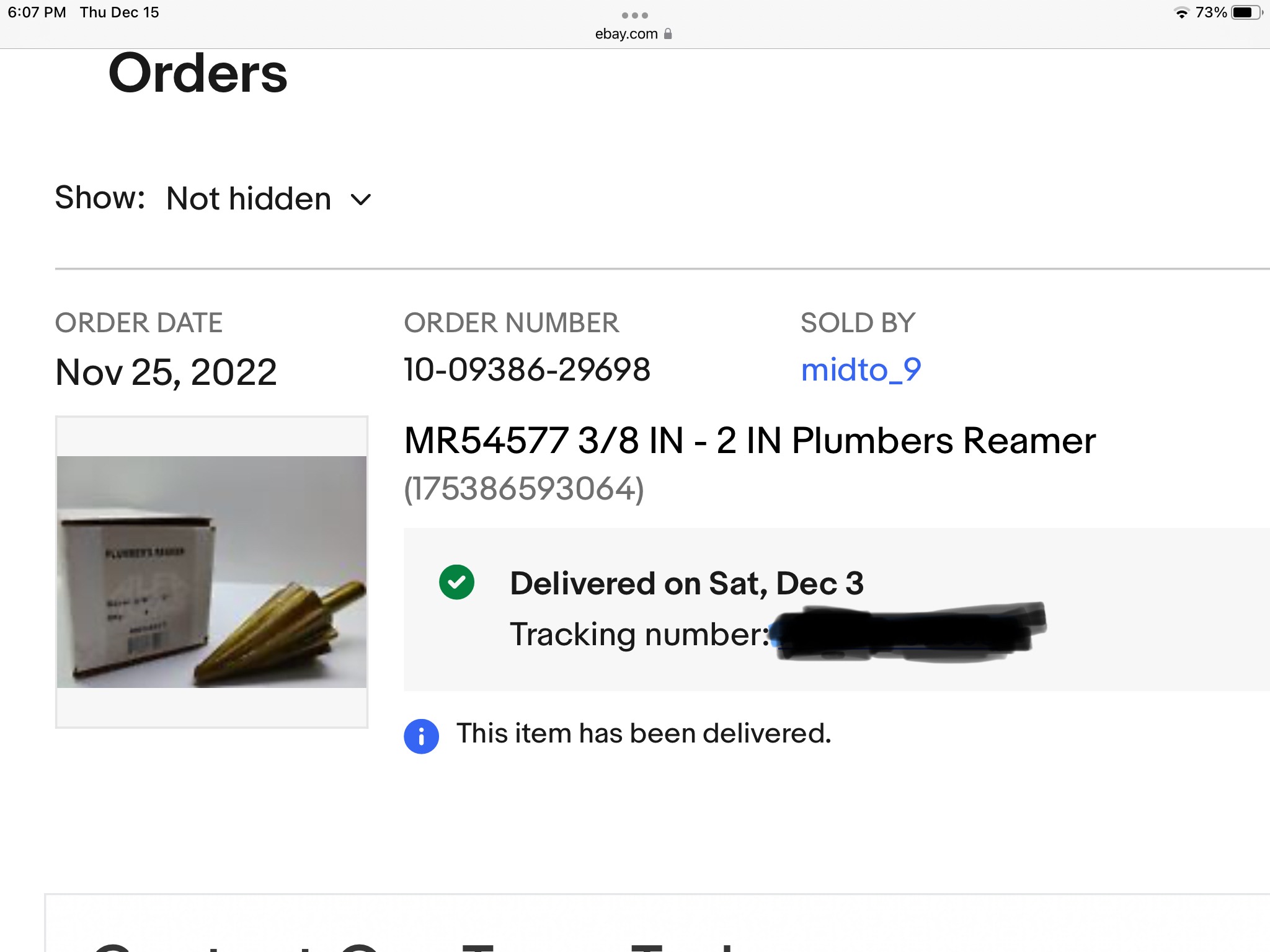

The little waveguide is aluminum right?
I just bought this tool for a similar problem to widen the mouth of a plastic waveguide to clear the surround of a tweeter. Its tool steel so im sure it would cut aluminum, you’d need a good drill press and a jig to secure the woofer.
does 3/8“-2” Was $51.99 ……he has a couple more in stock.
I know the angle is opposite but much better than a ledge! food for thought 😎
edit…..thinking about it, tool might not clear the threads though 🙁
edit 2 …….. unless one ground down the cutters just above the size you needed (and fit past the threads) 😎
edit 3 ……. I suppose this would require removing the dust cap to protect the voice coil from shavings, at which point you might as well come in the topside with an automotive reamer, longer taper up to 1 3/8” I believe…….the taper would be the right way, and clear the threads on the bottom.
Thanks for the pics! Now I have a clearer understanding of the bad fit.
So, to fit exactly, what should the 1 3/8" adapter's ( inside diameter ) actually be to properly mate to the Eminence woofer ??

@EarlK - Measurements taken (with calipers) from the coax and adapters.
PRV plastic adapter - 0.945" dia inlet, 1.075" dia outlet, 0.925" total depth, 8 deg total average
Ebay 3 bolt adapter - 0.995" dia inlet, 1.030" dia outlet, 1.010" total depth, 2 deg total average
Eminence adapter - 0.998" dia inlet, 1.050" dia outlet, 1.010" total depth, 3 deg total average
KL3012CX-8 WG - 1.025" dia inlet (give or take a few thousandth). This (or slightly smaller) is your target exit dia for a screw on driver.
The taper angles were averaged as the adapter flares weren't exactly cone shaped.
The Ebay 3 bolt adaoter would be my first choice, but it won't accomodate a 2 or 4 bolt driver. It is the most precision made piece IMO, allowing for a lot of correction to suit a specific driver exit angle, but also for initial fit. This won't be an exact science. As precise and defined as the taper in the pole piece is, the step and gap created by the VC to cone interface will affect things (negatively) far more than anything else IMO.
The Eminence would be the next best choice, depending on the driver exit angle. The PRV adapter isn't very well made. The bolt holes don't line up well on it and the main issue for me is that its plastic, so no good for a heavier driver and won't allow for a solid and secure mechanical coupling in general. The massive step in the throat it creates in the KL3012CX will certainly cause issues in the upper HF FR range. The mismatch with the Eminence adapter could be negligible, but that would have to be verified using various drivers. I suspect it will be noticeable, but the inner design of the coax itself may overshadow that considerably. We'll see...

Hmmm, yeah thats not good for the taper going the opposite way. That will hurt FR and likely increase HD.

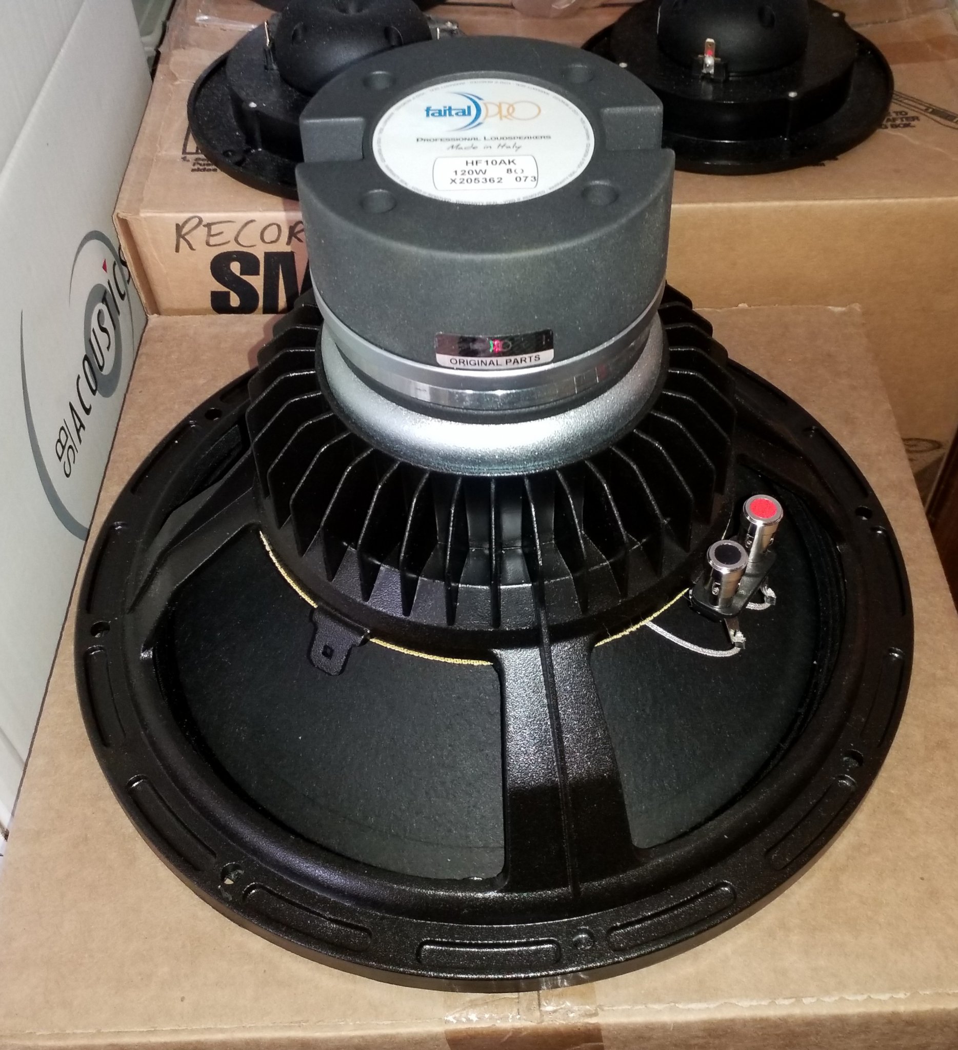

I've decided to cut down the thread height on the Eminence B2S adapters and recheck fit with the KL3012CX. It looks alot better and I've also moved the acoustic center closer together by doing so, which is a bonus. The amount to remove from the adapter thread is .200", which requires the bolt holes to be countersunk, so you will need tapered head M6 fasteners as well. It took me about an hour to modify the adapters, but now things look much better. Removal of material moves the opening further up the taper in the adapter, reducing the hole diameter by about .030" in my case. Now I can test the other drivers.

While waiting for the weather to clear up down here, I've done some quick and dirty manual FR sweeps with the HF10AK coupled to the KL3012CX.
The CD is SMOOTH AND EXTENDED well past 14 -15k and the LF cone loads the driver evenly way down to 550 hz. Everything in between is balanced with the predictable few wiggles around 10k. No weird distortions or other typical non linearities around the CD cutoff as far as my trained ear can perceive. The LF driver sounds shockingly linear with just a small bump of 2-3 dB between 3.5 - 4k as reflected in the Eminence data and measurements. Its quite a nice driver for the price if you compare it with other pro coax drivers.
This is all currently based on what my sine generator and my portable RTA with small IMM6 mic is telling me, but I'd say it's very promising until I get some more factual measurements outdoors. Its definitely enough though to keep me excited about the whole project. What blows me away is how clean the HF10AK sounds through the cone as a WG. I played some solo trumpet and alto sax stuff through it (Miles and Cannonball) with a series 20uf poly cap and wasn't expecting to hear how clean, snappy and full it sounded, specifically the reach down jnto the mid 100s of the CD without the usual artifacts you hear with coax setups like this. These drivers are pretty nice.
