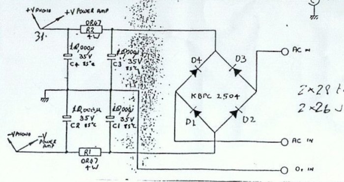

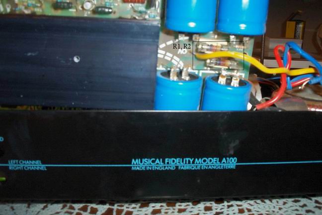

otaku said:I measured the voltage across the reservoir caps. C1,C2,C3 measured 42V, while C4 gives 0.9mV!! I'm now confident that this must be one of the reason. Does it mean both channel can completely die? Can I simply change C4 only ? Obviously the original brand caps are not available and 22000uF is extremely expensive..
No, it means that R2 has failed open-circuit. Replace that before worring about the other stuff. Look at the power supply schematic (I know it's from my A1, but they're similar)
Wow, you're absolutely right, Mark. R1,R2 are fuses in my PCB(not sure if it is originally so) as you can see in the attached image. One of the fuse was blown before and I replaced already. But after reading your post, I rechecked to find that one had been blown again.
It's kinda funny as when the fuse is mounted in socket, if I measure conductivity both end of the fuse , it shows it is closed. But once taken off, it is obviously open. So your diagnosis was correct. Thanks!!!
1. Can I simply replace it with some wirewound 0.47ohm resistor? Or should it be kept as it is and just a new fuse should be replaced? It's so called bleeder resistor that discharges the caps when turned off, I guess?
2. According to Randy Slone's book, I feel that 22000uF anyway is a bit excessive. Bigger ones wouldn't do any harm, but if replacement is needed, 10000uF will do the job without any vicious effect?
3. The reservoir caps are rated 35v, while giving out 42v. They've been working ok, so no problem. But 42v is a bit too high, while it's supposed to be 32v, I guess?
4. Power LED are remaining bright for a minute or so even it's turned off. Is it normal?

otaku said:Wow, you're absolutely right, Mark. R1,R2 are fuses in my PCB(not sure if it is originally so) as you can see in the attached image. One of the fuse was blown before and I replaced already. But after reading your post, I rechecked to find that one had been blown again.
Not sure... I believe that the origional amp would have had resistors, but fuses are a good idea, especially at this stage. I'll check my archives this weekend - I think I've got a copy of the correct schematic.
otaku said:2. According to Randy Slone's book, I feel that 22000uF anyway is a bit excessive. Bigger ones wouldn't do any harm, but if replacement is needed, 10000uF will do the job without any vicious effect?
Again, if I've got the correct schematic then I should be able to confirm this at the weekend. Bigger values will cause the rectifier and mains transformer to run warmer - not recommended...
otaku said:3. The reservoir caps are rated 35v, while giving out 42v. They've been working ok, so no problem. But 42v is a bit too high, while it's supposed to be 32v, I guess?
Actually, this is bad! You shouldn't exceed the working voltage of a capacitor under any circumstances - if you do, there is a very serious risk of them exploding. I'm not kidding!
So, are you definitely sure there's 42V across them? Are you measuring this at the tags of the capacitors? Does the voltage rating of the amp match your local mains supply? How accurate is your volt meter?
As the power supply is running with no load, it's normal to find a bit more than the normal 32V. But not 42V...

Thanks for the picture. I've never actually seen inside an A100, so please feel free to post some more. You could send them to my home email rather than posting them here if you prefer...
Mark 😉

If the fuse keeps blowing, It means that either there is a short from the +24v rail to ground or more likely, a fault in one of the channels which is causing too much current to flow through one of the output transistors.
Can I suggest that you don't replace any further components until you have established exactly what and where the fault is. Definitely don't think about any modifications at this point or you are likely to end up with an expensive dead amplifier which will never work again.
You have established so-far that the first part of the power supply is alive and well. Next, you need to work out which channel is faulty. I normally do this by disconnecting the supply to each channel in turn, powering up the amp slowly on a variac and measuring the current being drawn. Chances are that one channel will be fine and can be left alone.
I don't have a schematic for the a100 anymore but it uses a fairly simple push-pull design set for an idling current of about 600mA I think.
Unless the fuse is blowing violently (blackened tube etc) the output transistors are probably fine. I would be looking further back in the circuit for shorted transistors, leaky capacitors etc. Again, the easiest way to do this is by using a variac and a good multimeter to check voltages at the different stages of the circuit.
Push-pull power amplifiers are not that easy to troubleshoot as they are mostly DC coupled meaning that a faulty component anywhere in the circuit can cause the output transistors to draw too much current and melt or blow fuses.
Whatever you do, don't think about replacing the fuse with a low value resistor. The fuses are there to prevent serious damage to the rest of the amp in the event of a fault condition such as the one that you have.
Also, I wouldn't worry too much about the high off-load voltages across the power supply. When the amp is running, it would be drawing over an amp at idle unlike a more conventional class AB circuit so voltages should return to normal once the output stages are fixed and drawing the correct load. Obviously it's not a good idea to leave the unit powered up for any length of time in it's present condition - 42volts across a 35v rated cap isn't good!

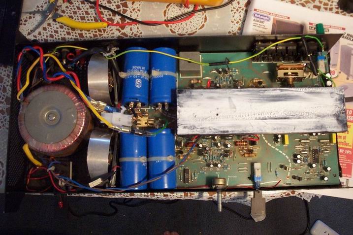

Re: A100
Remember the white **** on the heatsink? 🙂
Fortunately, it looks like the fuse was blown during the careless soldering. Stupid me, but I don't make the same mistake..I have sharp learning curve 🙂 Not as serious as what you are suggesting. But I'll look into these problems too.martinab2 said:If the fuse keeps blowing, It means that either there is a short from the +24v rail to ground or more likely, a fault in one of the channels which is causing too much current to flow through one of the output transistors.
Good suggestion. I'll replace the fuse and transistors though, as I know they are wrong anyway. If it doesn't fix, I'll then take it to the service person. I'm sure that I didn't make it any worse, but what I have now is all caps rated at 105degrees.

I'll check if my meter is ok. I don't think I'm missing any transformer wiring...They are back to where they should be..
Is your meter reading accurately? unless it's a good one, I would have my suspicions about that reading. Don't suppose you disconnected the transformer secondaries at some point? If so, check they are back where they should be.

Otaku,
You go through the same process as I did some months ago. I bought a secondhand a100 that did not work properly and went to the repairman just too many times during the last years. Of course, the price was in accordance with these facts (only 50 Euro).
I took me a complete day and a lot of parts but now I have a so good as new A100 that works very beautifully. It is worth the time and trouble: this really is an amp that sings.
I did:
* replace all small caps.
* replace the main caps (blackened).
* replace the bigger power resistors (darkened)
* replace the power transistors by MJ802/4502 (here was the real problem of the amp not working properly).
Furthermore:
* several versions of these amps have different idle current ranging from 600 mA to 1,5A. After a lot of trying and testing I choose 600 mA as best sound/longest life combination. This is done by inserting value 2M7 x 2 in the circuit and .47 Ohm/5 Watt in the output (sometimes this is .22 which doubles the current). The circuit can be found in this forum at several places.
* I disconnected the pre- and main amps by sacrificing the tape in-out connector and making them pre-in main-out. Especially the main-amp is very special and worthy of a better (tube) preamp.
After one month of listening to the as new A100 I was so happy about the sound (comparing it to amps costing 5 times as much) that I decided to built myself from scratch 2 monoblocks using 300 VA transformer per channel etc). Remember that the generic circuit of the A1/100/MA50/MA100 was tested in HFNRR of 1988 as coming close to ARC D240 and Krell KSA80 sound, the reviewer wondering what the hell could be the explanation of this!!!

I have the circuit schematic and fortunately, my circuit has 2M7*2 already and 0.47ohm as well. Taken 2M7*2 off, I guess it becomes class AB, doesn't it?

I put a picture of my veroboard A100 somewhere on this forum.
Hi otaku,
Thanks for the picture. I assume those are fans between the transformer and PCB?
I'm still troubled by this 42V. You say that the transformer is giving 26-026, which sounds right - this should give DC of around +/-36V off-load - not 42V. Check very carefully for broken tracks and bad soldering, because something very weird and probably silly is going on here...
Those fuses are definately mods, but you'd be advised to leave them in there for now - they might save your new output transistors.
My copy of the schematic is a bit strange about the smoothing cap values - see what you make of them:

Hi Mark, Yes, these two are fans. Good eyesight!mhennessy said:Hi otaku,
