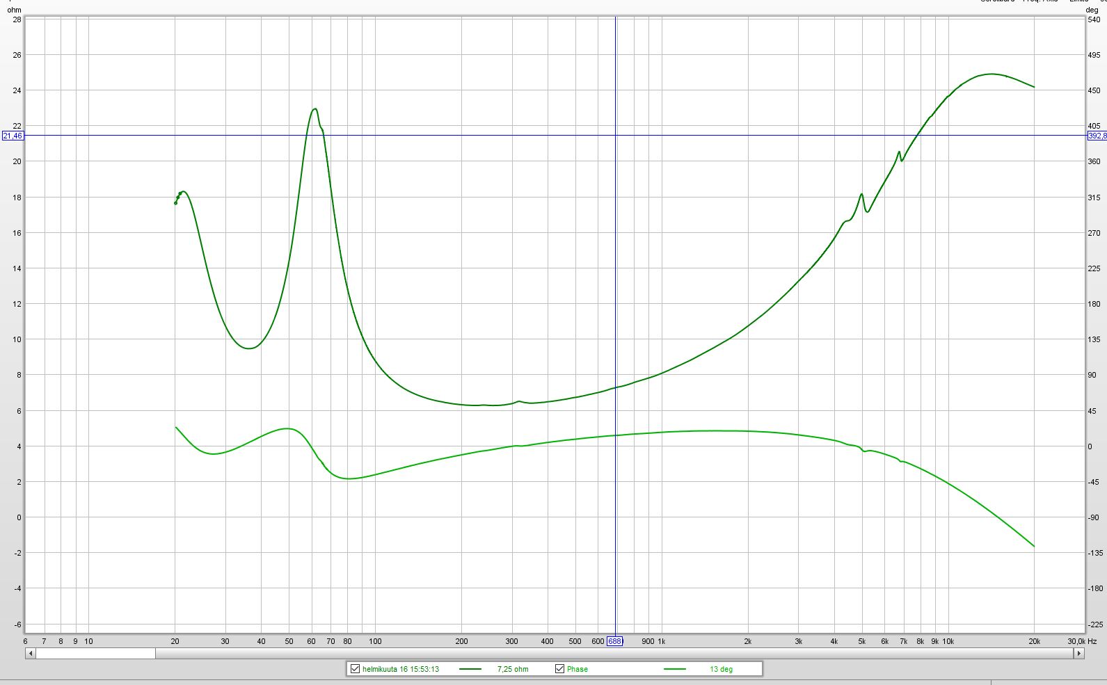

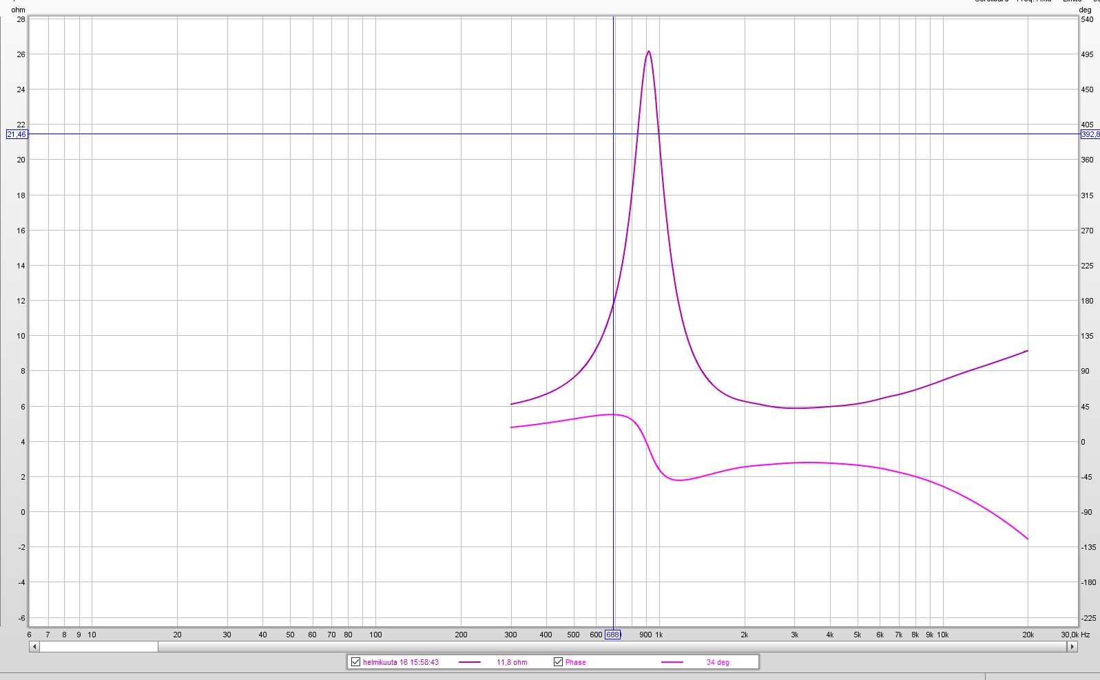

Now that I checked the zma-files it appears that they lack the phase information altogether! I used traced zma-files this far.
I'll measure the driver impedances myself with RoomEQWizard and use those for the sim. REW seems to do pretty good job judging by some component measurements I tried out (inductors, capacitors and resistors). One can also export the measurements as zma-files with phase info directly from the REW. While at it, I'll probably also check the acoustic offset distances w/o crossover using a sweep starting from 300 Hz or so.

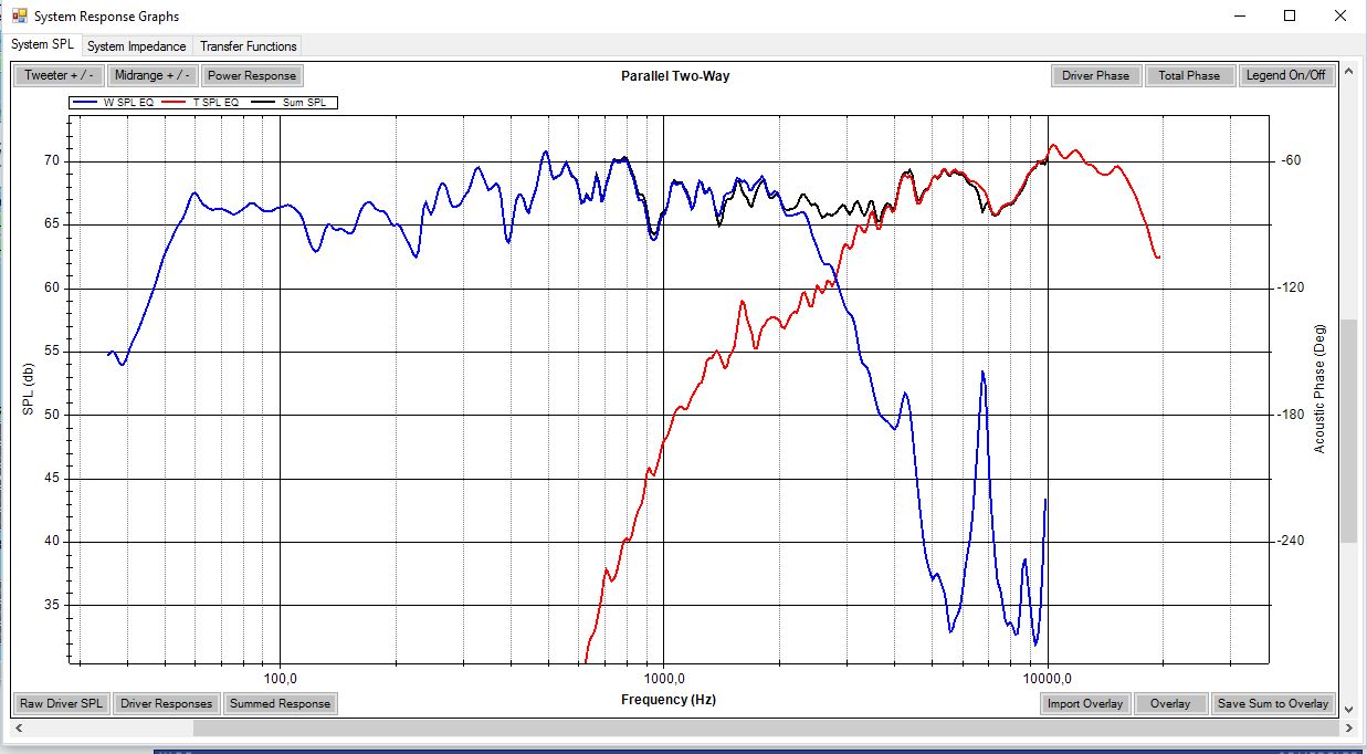

I made some new measurements which gave a lot better simulation results! Something was wrong in my SPL-measurements previously. I measured raw SPL and phase (phase corrected in REW with time reference channel) for both drivers (images 1 and 2). On axis, mic at tweeter height, 50 cm distance from baffle.

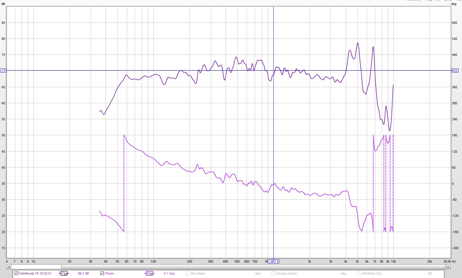

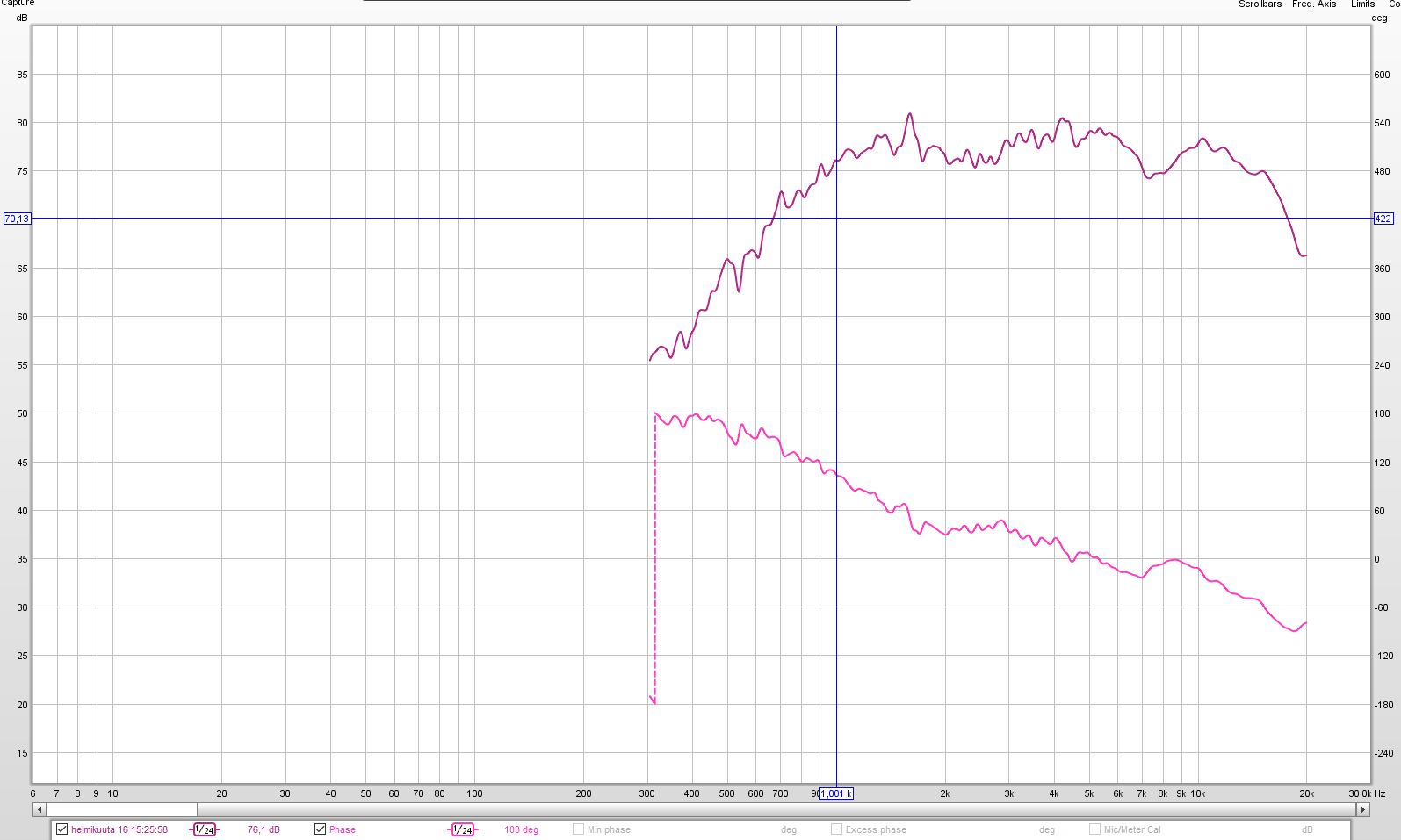

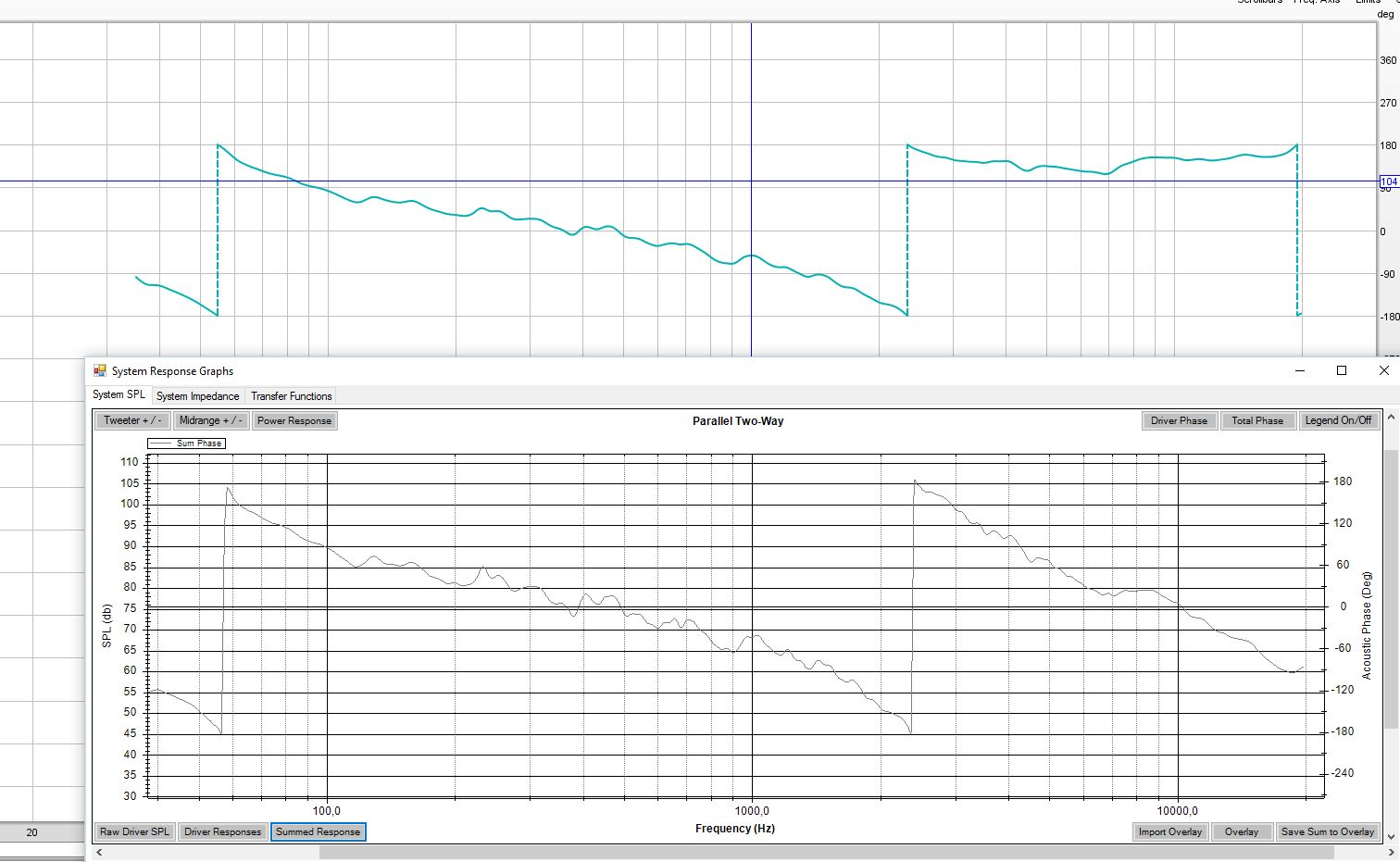

I also measured impedances including phase (images 3 and 4).

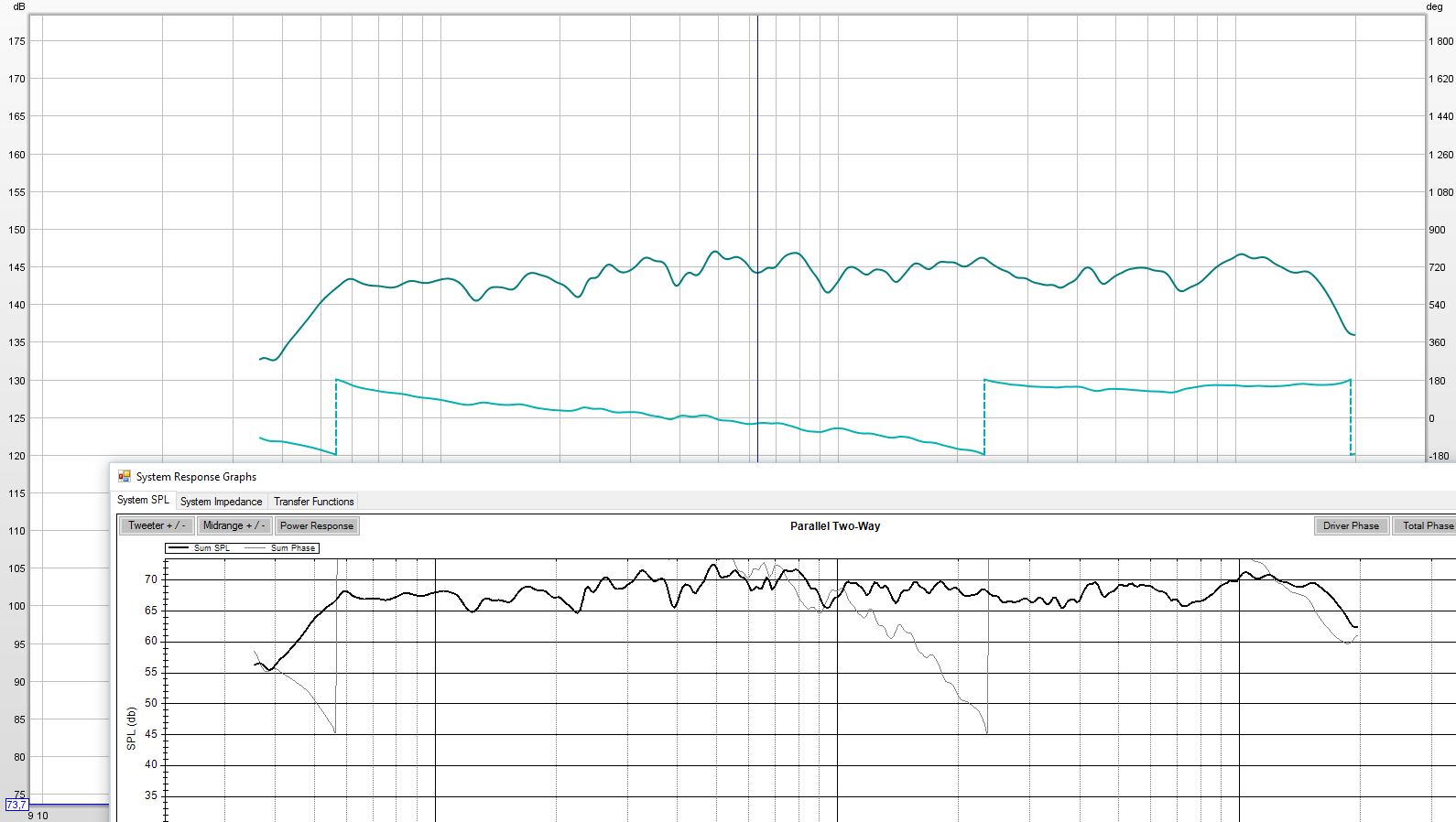

These SPL and impedance files give a pretty accurate simulated sum response in Jeff Bagby's WinPCD (comparison in image 5: upper, green curve from my speaker measurement; below it the black sum curve from WinPCD simulation).

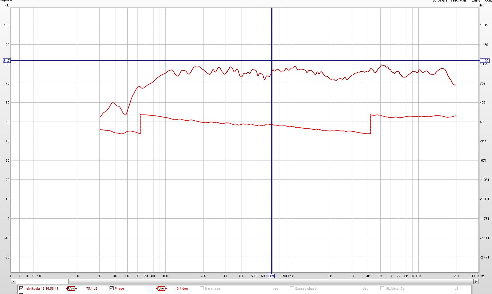

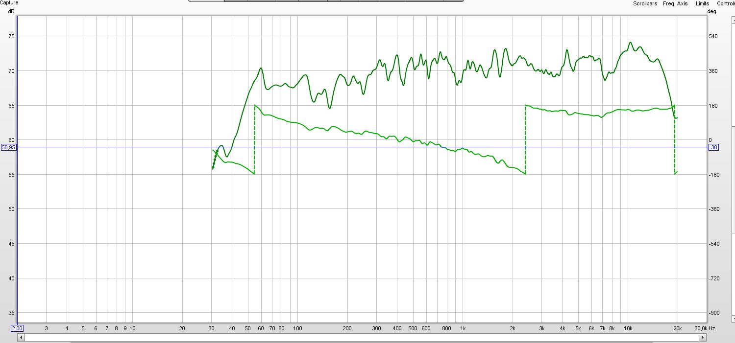

Simulated phase and measured phase don't quite match above 3kHz (image 6).
I didn't do any fiddling with acoustic offsets since I used measured phases instead of calculated minimum phases. I made a measurement of the raw drivers in parallel (above 300 Hz) though, so it's still possible to try minimum phases and acoustic offsets if necessary.
My measurement rig might be flawed at high frequencies, for I get a quite steep roll-off above 15 kHz. I measured for reference a Boston acoustics A25 that has been in use for couple of months now and shouldn't have any tweeter issues. Also a similar roll-off (image 7).

This looks like a delay difference, ie they could have the same phase. You could try adjusting the offset for no reason other than to make this comparison.Simulated phase and measured phase don't quite match above 3kHz (image 6).
Measured is generally better than a minimum phase esitmate. This kind of baffle with the driver offset vertically and horizontally is designed not to optimise the baffle behaviour, but to balance the errors at the listening position and the baffle contribution isn't necessarily going to be minimum phase.
I did try adjusting the offset now. WinPCD did take the offset adjustment in and changed the SPL but didn't do anything to the phase. XSim didn't do anything to the SPL but corrected the phase.

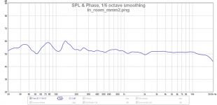

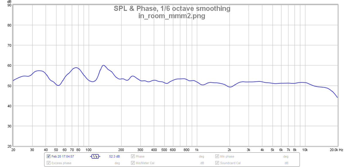

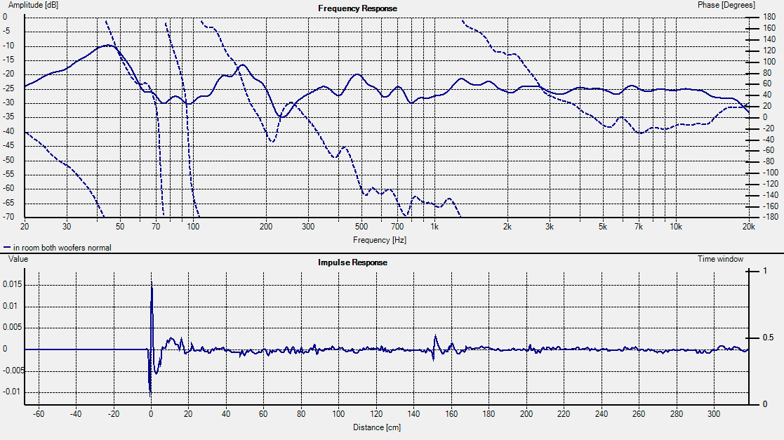

Just as an example, here is an in room measurement I did this afternoon after some adjustments, using mmm (moving mic measurement) technique.
RTA 1/48th with periodic pink noise. then smoothed to 1/6th octave.
The big humps and dips below 200Hz are mostly the room, but there is a dip in the woofers response at around 70Hz. In general look at it from 200Hz up you can see that it is tapering down. I was noticing some brightness, and have adjusted the bass (crossover freq is 270hz) up about 1db, definitely sounds a bit more balanced now I think. Will need some listening time to get used to the change.
As a comparison, the second is a normal swept sine measurement at the listening position. Mic positioned to ensure equal distance between speakers (only one pieak in impulse). You can see the MMM smooths out the peaks below 200Hz somewhat.
Tony.

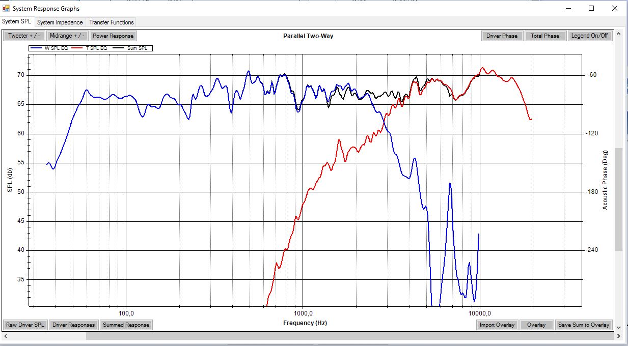

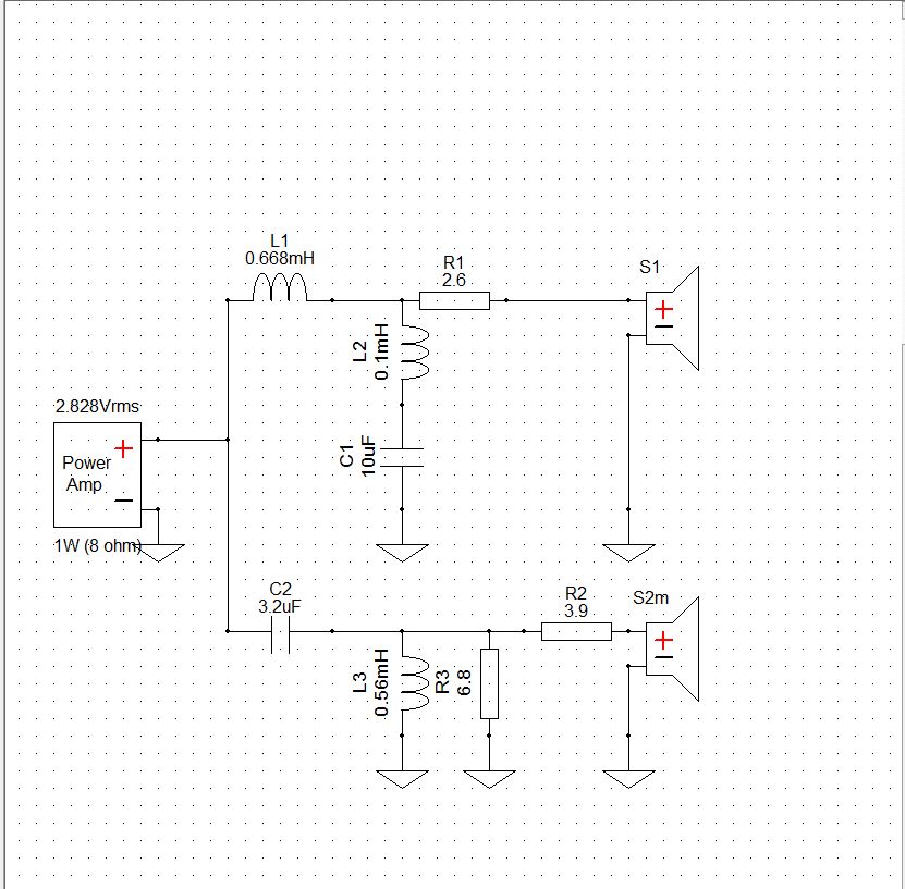

I'll take another try with a bit flatter response. What I think I really messed up with though is the RLC circuit parallel to the woofer. I altered the capacitor from 8,6 to 10 µF. I aimed at smoothing the response at 4-5 kHz, but I think the 7 kHz resonance spike is now pushing through especially off axis (Image 1 with 8,6 µF and image 2 with 10 µF - simulation in WinPCD). Although the woofer off axis response rolls off pretty steeply from 2500 Hz the resonance spikes are still there at 60 degrees off axis (image 3 - manufacturer spec sheet).
That is a big breakup peak!! Have you tried a lower q notch centered at around 5.5Khz to try and take out both the 4K and 7K at the same time? I've played around in sims with multiple RLC's in parallel with the woofer and it seems doable, not sure how well it works in real life though.
I take it the dip around 7Khz is not inherent to the tweeter, but is the woofer breakup interfering (out of phase) with the tweeter at that frequency?

The 7 kHz dip is unfortunately inherent to the tweeter (or caused by baffle geometrics). Also the tweeters are on the edge of adulthood at age of 18 years, so there might be some side effects from maturing. 😀
I really liked the original design by ear. Now that I look again at the SPL curve from that one (image 1 from the book by Pekka Tuomela) I notice that
- there's no ascending towards high frequencies
- the 7 kHz dip is there.
There's also a slight roll off from 200 Hz towards low frequencies by design. It's due to a bit "over sized" box and made the speakers very light to listen and also extended the bass response a bit towards 40 Hz. My current woofer handles a bigger box so the roll off isn't there anymore (image 2 - a WinISD box response simulation of the old woofer, green curve, and the new woofer, yellow curve).
I did also try with two RLC circuits. They manage the resonance spikes really well, but the problem is a really steep roll off caused by the two RLC circuits together. With two RLCs I ended up crossing at 1,5 kHz or so. I think I'll have to give it one more try though, for I'm using a lot smaller inductor now.

The measurements are in a room. Unfortunately I can't take measuring outside, for I live in a densely populated area and there's always quite a lot of background noise outside.

In room is OK if you can't go outside, but you need to be careful, and I would use gated measurements.
Try and set the speaker up in the middle of the room, about equal height from the floor and the ceiling.
Try and get furniture away as much as possible.
Set your mic up (and speaker) so you are not at right angles to any wall (try and aim diagonally accross the room).
Try and put some thick quilts or similar on the floor between the speaker and the mic
Don't put the mic further away than the distance from the speaker to the floor or the ceiling.
Doing this and gating the measurement before the first reflection should see you getting good measurements down to 300 - 400Hz.
I've not really tried gated measurements with REW (I've use holm impulse for gated) but It should be able to do it.
Even doing outside measurements, the best I've been able to get gated, is about 200Hz.
