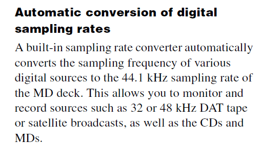

(This is from the user manuals of both MD's)
So thinking more on what you say... I wonder if the Pure (which doesn't cause the problem) perhaps outputs everything at a resampled 44.1khz and standard 16 bit depth. Remember that MD is 'old' technology really. Or am I talking nonsense.
