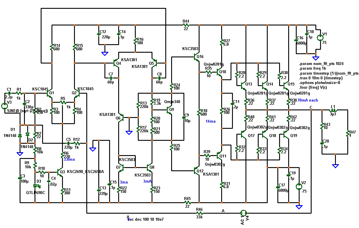

I bought a 5.1 home theatre system years ago which include this main amp, this cost me around a 100 USD. It plays music but I hear no hifi since it does'nt fit my listening preference even i had replaced the speakers with other pair and player its just the same.
Last month it broke down frying the ouput pair on one channel. I had replaced the output and measure the offset voltage which is to high about 400mV. So I measure the good channel and to my shock its around a volt offset. So i tried to play music, upon power on musicseems okay but after 30 seconds the sound of the busted channel is going low and distorted other is just fine, So i shut it off and investigate why.
Upon re-engineering the schematic I found out this Schematics. Attached)....
I am wandering why at first it sounds but just a little bit harsh and now totally no good.
What's your comment and suggestion for improvement?

That has got to be the sloppiest implementation of the balanced VAS I have ever seen. NO WONDER it has a volt offset. It must sound truely horrible.
Q9 should be NPN , C7 is reversed ,diode is reversed , general circuit is overcompensated (100pf caps) with very low VAS current (output droop) cheap low gain transistors. Is there a Vbias adjustment ?? (near R14) very low input pair bias . .5ma ??
Below is how it should be done..

Did you measure the idle current in the outputs and/ or the drivers? (measure voltage over R16/R17 and over R15)
...because if C7 really is the wrong way it could shortcircuit the bias-circuit, leaving the outputs in pure class B.
What about the D1... does any current go through it? (measure voltage over R12+ R15)
Or you could just reverse C7 and D1 and see what happens.
It might just be an assembly error ( which is bad enough) and after you have fixed that, the circuit might have a tolerable sound quality.
Edit: the C7 could allready be damaged. Try pulling it completely out of the circuit ( no big difference in function) and if it works you could refit a new cap.

Hi OStripper and Nrik....
Yes I've already reversed the diode and replaced C7 and it works. I already replaced Q1 and Q2 matched so offset now is at minimal around 20mV. Also reduced C3 and C4 to 47pF.
As for idle current i can't adjust it since no trimmer around. my voltage reading is almost zero on R16 so i wired a 5K trimmer in parallel with R13 and adjust to to around 0.013V or at least 50ma on R16 since my heatsink will not get hot.

1k$$$ I could build 2 complete 250w/2 channel amps with 4-500 watt peak capacity ... chassis and all for 1000$$
20mv is pretty good for no offset trimmer. I am glad you got it working and even happier that I build my own amps.. I did not mean to degrade the quality of your amp.. but the transistor choices are 20th century , sort of like MJE340/350's 🙁 .

Just look at the schema above , best , most cost effective choices.
