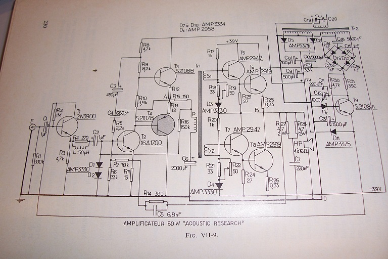

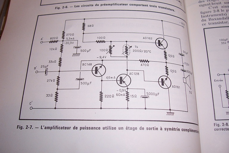

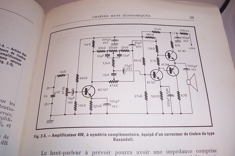

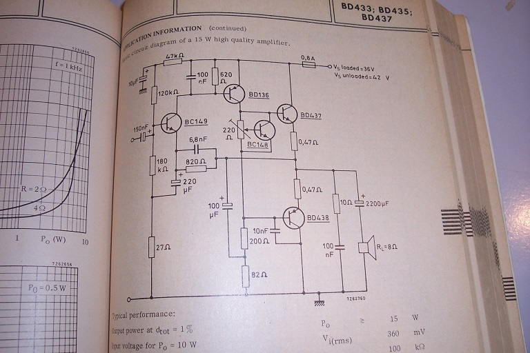

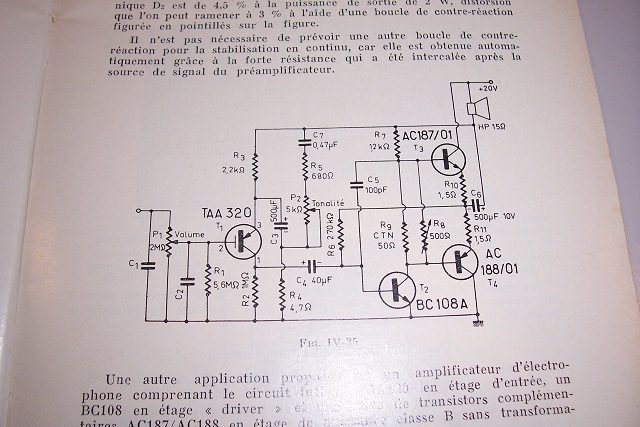

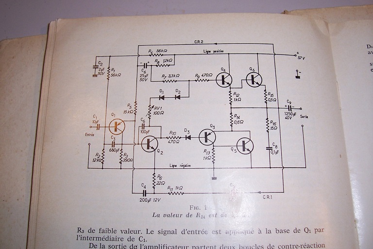

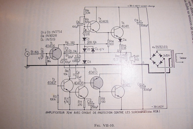

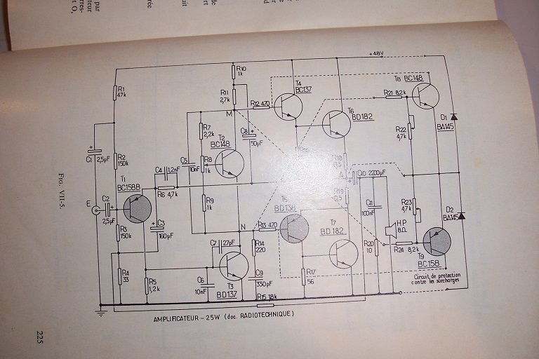

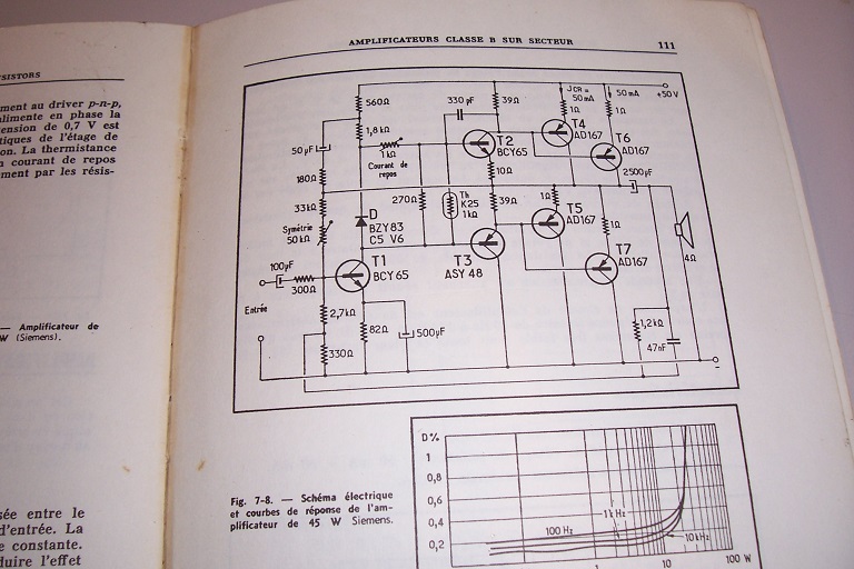

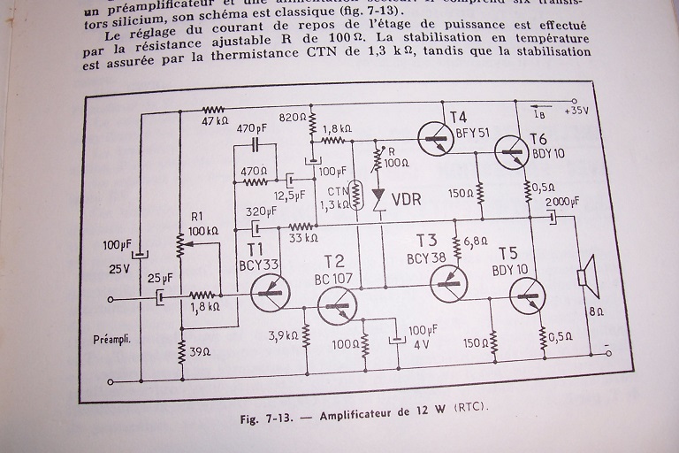

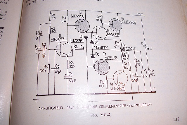

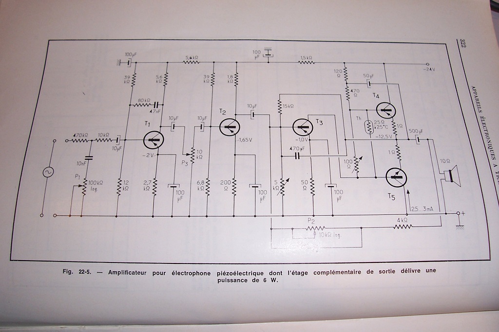

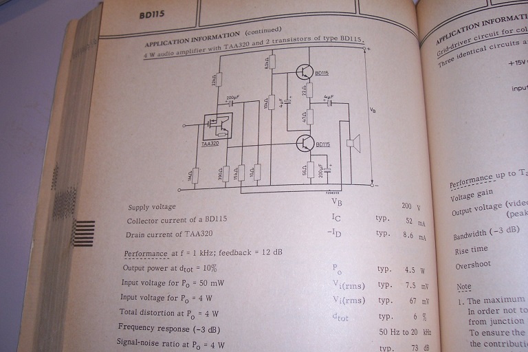

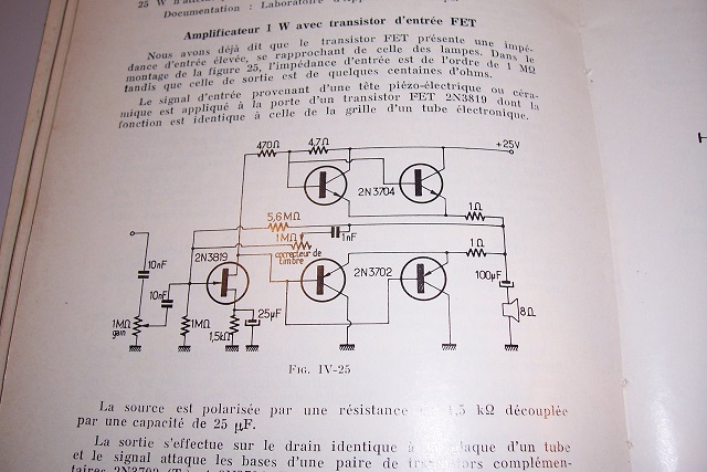

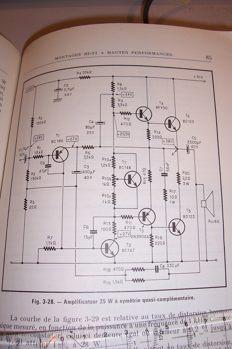

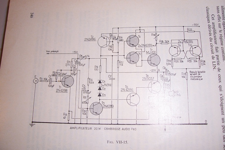

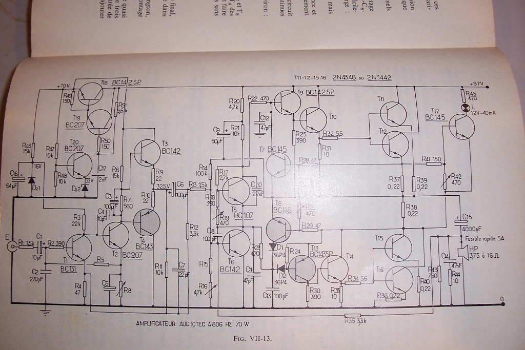

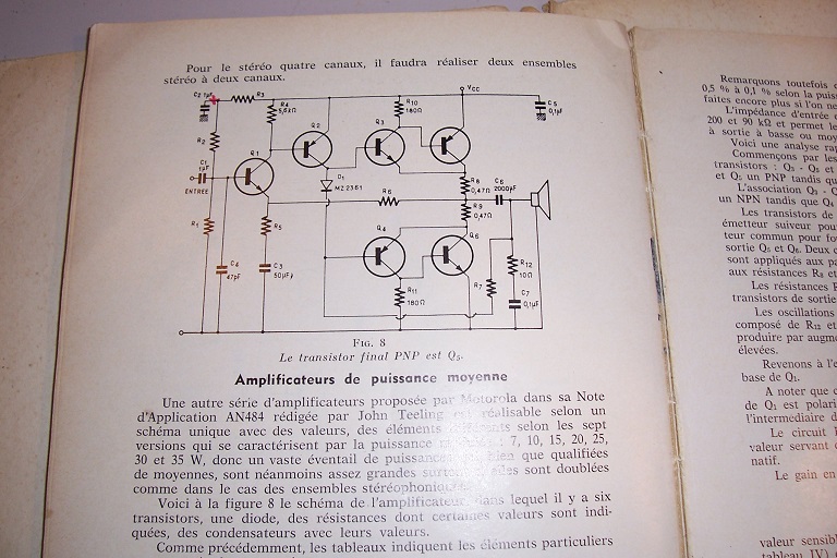

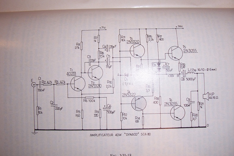

Daniel inquired about simple, LTP-free discrete designs.
Here are some examples, mostly based on application notes from Motorola, Siemens, RCA, Philips, Sescosem, etc

Thank you! These are easy to read and look especially doable. So, that's why transistors were so popular. I never knew, until I saw your post.Daniel inquired about simple, LTP-free discrete designs. Here are some examples, mostly based on application notes from Motorola, Siemens, RCA, Philips, Sescosem, etc
Also, here's my thoughts on the parameters that I'd need...
Size:
Main interest is in the easy to build, Class aB, complementary, non-ltp, and under 25W. A Test. How much Voltage (power) do your speakers need? ~40% use is 4W amplifiers, 30% more is 4W to 25W. So, 70% of relevance is under 25W. Amplifier sized relevant for bedroom, kitchen, laundry, office, parlor, bathroom, veranda (a house).
Exploring:
Discrete class aB projects of relevant small size seemed to be few/missing. That sells a lot of chips, which are prefab, with difficulty like finding perfectly fitting clothes. But, I'd like something that isn't just 'off the shelf'. To make sure of a difference, I asked about, non-ltp, non-quasi, single rail, and discrete parts.
And, you found them!
Efficient:
And aB because I'd probably leave it on. Single rail because easy dc protect, also easier to reduce audio distortion of the speaker by reducing waste-loading. Very efficient right-sized class aB.
Easy assembly:
Seems like the 4W scale should probably have 7 or less transistors (preferably less), or at 20W scale 10 or less transistors (preferably less). Because, less complicated = less obstacles to use. At this scale, the amplifier was probably needed, and wanted to play same-day, rather than someday.
5 hamburger budget:
To fit samples, up to 5 units of 12 different devices, less than $12 could get enough devices for multi channel surround sound, if the transistor count wasn't extraneous. A power supply can be one or more 19vdc smps, free when laptops quit. The 24vct and 30vct transformers are numerous, often surplus.
Also,
I might have the funds to try many different little amplifiers -or- one oversized. However, in-home use (at least 70%) is similar to near-field applications. That's where I'd like to explore small-but-charming discrete audio amplifiers.

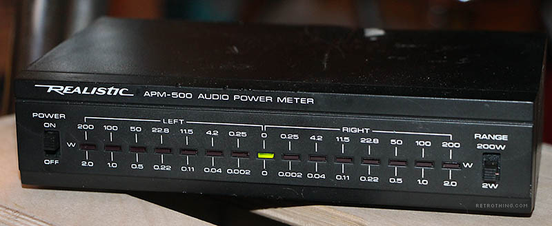

Remember the Radio Shack audio power meter, and you put it on the small range to make the led's go?
Have a look at that switch.

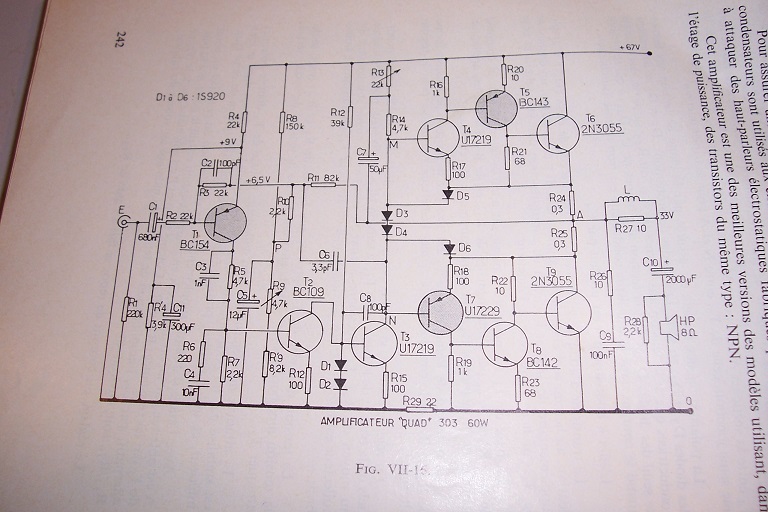

6 transistors is entirely enough if you regulate the power supply.Main interest is in the easy to build, Class aB, complementary, non-ltp, and under 25W. ~40% use is 4W amplifiers, 30% more is 4W to 25W. So, 70% of relevance is under 25W.

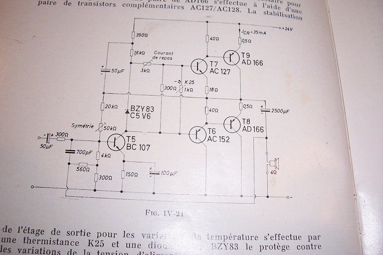

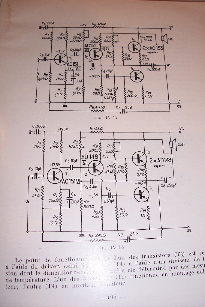

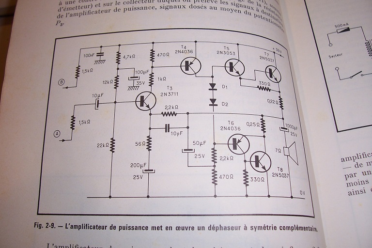

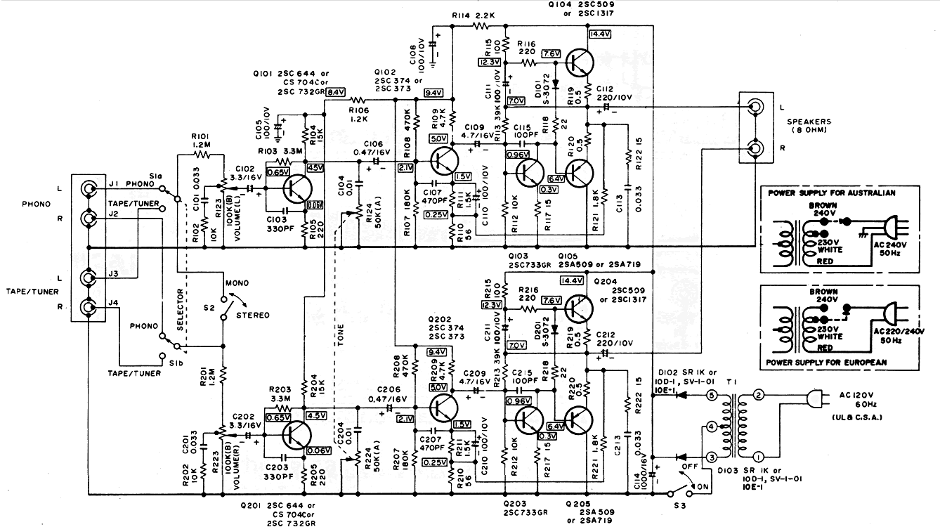

Schematic #1 in post #4, I have one board of a 1970 ST120 survivor with actual 40409, 40410, drivers. The 40411 outputs turned to sand before I bought it, I'm using NTE60 (equivalent to MJ15003). The 40409 & 40410 have more clear high frequencies than the TIP41c/42c I'm using as drivers on the other channel, but you can't buy 40409/40410 anymore: Or any TO5 transistor you can put a heat sink on. Drivers need a heat sink IMHO, dynaco certainly thought so.

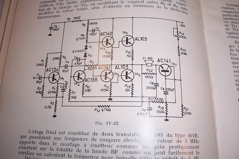

Those schematics in post #3, a lot of them require AC*** transistors which I thought were germanium. Germanium power transistors went the way of the unicorn, although you can still buy TO92 germanium. Also the BC/BD###, you can't buy 3 digit transistors like those anymore. Except from NTE or NewJersey that leave out most of the parameters on the datasheet.
I'm using D44R2 as the VAS in my AX6 board with 20 mhz Ft, but you can't buy genuine those anymore either. MJE15028/29 are fast enough, if a bit pricey. And MJE15032/33 should make better drivers than TIP41c/42c they have faster Ft.
I listen at 1.5 Vpp most of the time on my 101 db 1w 1m speakers, which is about 1/8 watt. But with my 70 v rail on the AX6, I have 70 db of headroom if a CD of 1812 Overture is recorded correctly with the soft parts really soft. The cannon shot can be suitably overwhelming. SP2 speakers can take 300W.
Advantage of AX6 over these, it has DC feedback to keep the centerline input of the output cap near the center of the voltage rail to ground span. That gives the most volume out without clipping even if the gain of the transistors wander as they warm up.

That looks appealing. Is there a 'mini' or small scale version?6 transistor single supply amps that are active on the forum are the TGM8 TGM8 - an amplifier based on Rod Elliot P3a
Voltage range 40vdc single or 20+20vdc (slightly more if unloaded)?
Post 606 at the end on the AX6 thread is a 25 W version. It has a NPN input transistor instead of a PNP as the TGM8.
Note AX6 is quasi-comp. There is no symmetry with a speaker capacitor even with complementary output transistors because the speaker is returned to the negative rail (called ground) instead of the center tap of the transformer. Your proposed power supplies don't have center taps, neither do my existing transformers. Somebody calculated the distortion of AX6 on the thread and came up with low tenths.

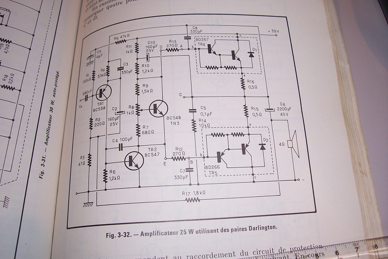

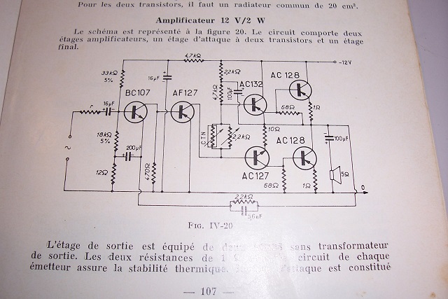

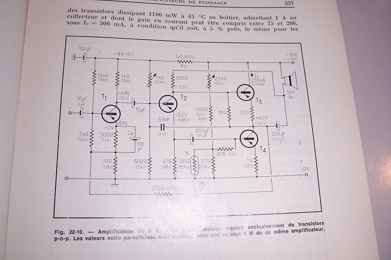

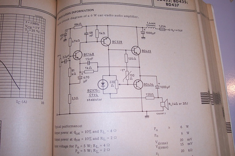

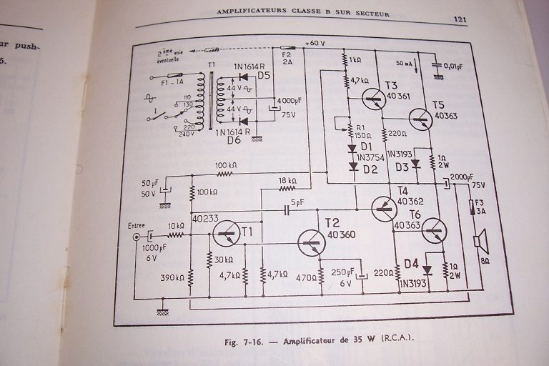

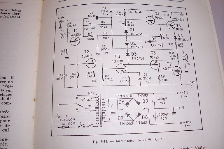

Schematics #5 & #10 of the post #1 by elvee are complimentary. But #5 is darlingtons which tend to thermally run away, and #10 requires a 15 ma N-channel jfet on input which has been replaced by NTE312. Most of the other complementary outputs on post #1 & #2 have germanium power output transistors, unobtainable. For good reason, germanium power transistors tended to short out frequently.

That statement is true....The 40409 & 40410 have more clear high frequencies than the TIP41c/42c I'm using as drivers on the other channel...
40409/40410: 0.7a, 50MHz, HFE50
BD139/BD140: 1A, 50MHz, HFE40
TIP41C/TIP42C: 6a, 3MHz, HFE20

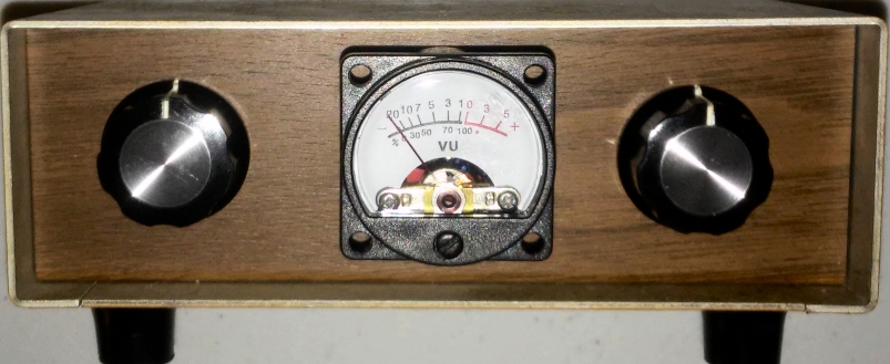

Enclosure plans
I think packard black, with sanded-across clear coated front like a 1960's receiver, and with matching silver trim.
It is the size of your hand.
The chips were far too boring in my kitchen, so that's why I worked very hard for discrete. This won't break a window, but it could inconvenience a teacup. It is going slowly--Next time, I will make the things twice as big, so that the connections are at least as wide as the soldering iron tip.
Here are the enclosure materials (attached photo):
Thank you Elvee sir for uploading these vintage diagrams..Daniel inquired about simple, LTP-free discrete designs.
- A collection of vintage, single supply, low to medium power amplifiers for Daniel
