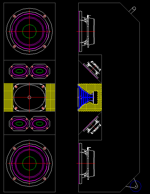

How about MTM with 10" mid and a radial horn. That would allow stacking side by side to increase desired horizontal coverage. Alternatively a bi-radial horn that can still be stacked with minimal interference/lobing.
Alternatively with 8" mid and a smaller angle to allow for more HF drivers for the same horizontal coverage allowing for higher SPL but also higher cost.
I guess synergy/unity horn is out of the question?
I doubt we can go completely diffraction-less and HOM-less and still keep up with SPL requirement so some sort of compromise have to be done.

Back when i was looking at building my own PA speakers. I came up with this idea. its based on the Eighteen sound 6ND430 6" driver which has a very flat frequency response from 100hz to 3K and the 45 degree off axis response is even flatter! So I thought about using 4 of these drivers per cabinet at a 45 degree angle with a waveguide horn in the center with a lot of heavy fiberglass or rockwool around the horn in the middle. this would then have two 12" woofers top and bottom.
I was doing sound for an all girl jam band at the time and I wanted as clean of vocal reproduction as i could. I did not want to use a 15" woofer but figured two 12" drivers would mate better. and i was not looking to get max SPL's out of it as they wanted lower volume. these would be used with a 18" sub cab per side.
I still like the concept...
yup! but those are designed to lay down and have a narrow vertical pattern. I was hoping to use mine standing up with a narrow Horizontal pattern. and who knows, Maybe i had seen that V-Dosc array and that's where i got the idea from??

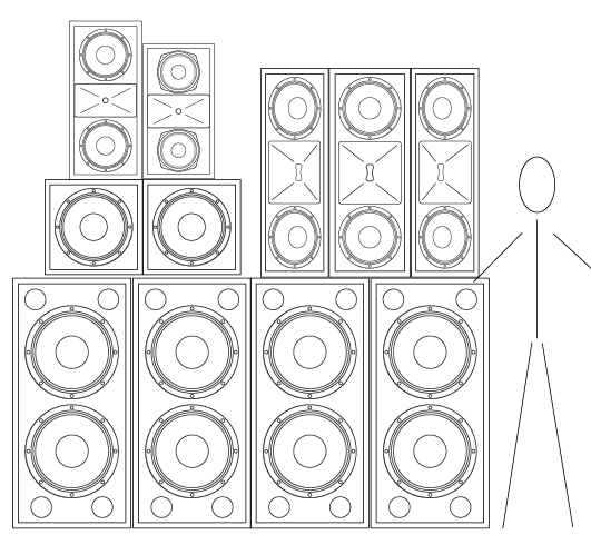

An interesting variation might be to take the mid-section of the V-Dosc cabinet as-is (without the 15" drivers) and stack 12" drivers above and below in MTM config. Like Zero Cool's but with the mid-section rotated 90 degr. for wider dispersion and a horn/waveguide to match that dispersion pattern.
I'll have to doodle that up.
One disadvantage I can see immediately is that the mid-highs will end up at shoulder/head height once stacked on the subs, which would not work well. Ideally, you'd want it higher than that -- over peoples' heads.

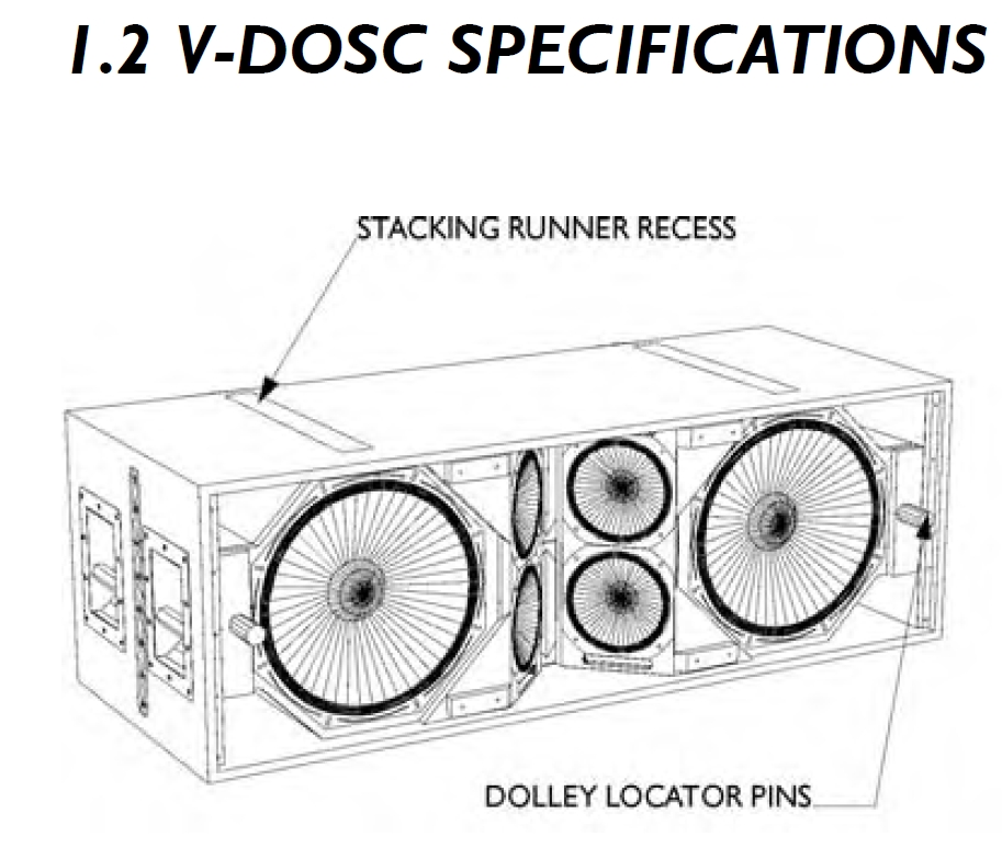

One thing to note with the L'acoustics V-DOSC cabinet is the crossover frequencies
15" LF to 7" mid 200 hz Mid to 1.4 HF 1.6Khz.
With an efficient enough HF driver it is possible to crossover to the subs without a lower mid driver.
I heard Brubeck live outdoors using V-Dosc and it sounded very nice. But I've also seen V-Dosc mid drivers that were pushed too far. That was probably due to such a low crossover point. I didn't realize they were crossed so low. That explains a lot. It would require using woofers rather than mids, which is a serious departure from what I was planning.

We have 20 at work on a rig that was used for the Queen musical up in Toronto. You absolutely need the 15" drivers for rock use. There's a huge amount of energy used in that freq band. It's rare to see any concert subs crossed above 120Hz.
So what range do the V-Dosc 15" drivers carry? If the 7" drivers begin at 200 Hz, then the 15" must be everything under that. But isn't there a separate sub used on those systems? I don't get the way they split up their bandwidth. Seems odd to cover a range as small say 80-200 Hz.

It's pretty much everything under 200Hz. L'Acoustics is very secretive about the processor settings used. There are however several different presets available that change the high pass filter on the 15"s among other parameters. We use XTA's on them and in the presets all settings are locked except for gain. We have created our own settings just to try using a Meyer SIM3 that sounds pretty good though.
