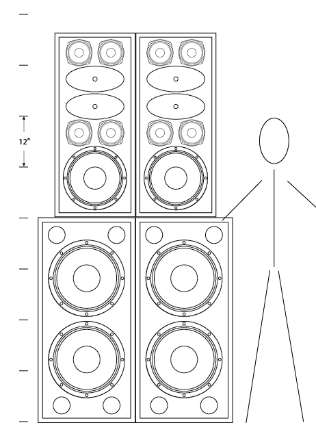

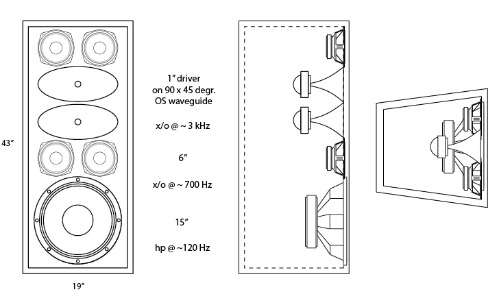

Here's a conceptual design that I came up with that deals with those criteria as best I know how. Bear in mind the actual construction and component brand specifications are somewhat irrelevant at this stage; it's a higher level conceptual plan -- just kicking ideas around.
It's a 4-way active system. I would personally prefer a DSP based (digital) crossover for its vast control and versatile capabilities. The subs aren't considered in this post but you can assume they exist. So low-mid, high-mid and highs are combined into a single enclosure as shown in this drawing. The cabinet, when stacked onto the subs, ends up with most of the mid-highs above the 6 ft height. Trapezoidal vertically standing cabinets will allow versatile horizontal splaying configurations. Two or even three side-by-side would cover a lot of horizontal area if needed. I've assumed one stack will go on each side of the band's stage. Flying a club band PA is rarely practical unless it's a semi-permanent installation. But one-nighters were a very common occurence in my career, so I'm going with quick and simple stacks. There simply isn't time to get fancy.
I chose a front-loaded sealed 15" low-mid driver primarily to handle the power and output level of the range between say 120 to maybe 700 Hz. I want to avoid the ragged cone breakup mode region above that.
The high-mids will be four 6" pro sound drivers (maybe from B&C or 18-Sound, etc.) arranged in an MTM configuration with the high freq. drivers. This to provide a tighter vertical pattern. They will handle the range from 700 Hz up to maybe 2-3K where those driver's break up modes start to get ugly.
For high's I used a pair of vertically stacked 1" throat compression drivers mounted onto elliptical OS waveguides. 1" drivers extend the response upwards better than 2" throat compression drivers, which don't go high enough for my taste. I don't like them without tweeters, and I don't want to go there. So I stacked 2 such driver/waveguides to couple and produce/handle the high level.
I greatly prefer the sound of front mounted, direct radiating cone drivers, that includes the subs. They just sound much better to me than any horn, scoop, W, or whatever other configuration I've used. And since the venue is small compared to a concert, we simply don't need the efficiency gained by those configurations. I've used everything known to man I think, and direct radiating always wins out for my taste. (Your mileage may vary).
I used waveguides (ala Geddes) here rather than any other HF horn configuration, because I believe the science behind them is sound (bad pun sort of intended) and I have a great respect for Earl Geddes' research and experience. Having said that, I've never used them, but I have used every size, shape and form of traditional horn and they ALL sound spitty and harsh if given the opportunity. Actually getting one's hands on an elliptical OS waveguide may be quite a challenge, but this is just conceptual, and DIY, so I'm going with it.
And since this is conceptual, money is not a big object yet. If it ever comes time to build one, then compromises will necessarily start to appear. For example, the price of those 6" drivers will add up quickly if one decides to build 4 of these enclosures.

The sub is simply a pair of 18" LF drivers front-mounted into a vented rectangular box. The tricky part here is to find just the right driver to give us the LF extension, excursion capability and power handling in as small a package as possible. The driver T/S parameters would necessarily have to provide us with suitably large diameter vents that are of reasonable length. So four vents (2 per driver) of maybe 4" diameter and some reasonably short length (under say 10").
Neo magnets would be nice to keep the weight down. But I've heard they are unstable in cold temperatures, so winter touring in the back of a truck might be a problem. I don't know anything more about this. That's all I've heard, though it did come from a respectable E.E.
That's not too much to ask is it? McCauley used to offer a perfectly suited driver for this design, but I see they have recently dropped that particular model, and their others don't quite suit this box. I like McCauley drivers. The ones I have used were exceptional. But there are plenty of other brands to model into this box.
One alternative to this design is to split the cabinet into 2x single driver boxes. That would provide more versatility in case you need to (or want to) scatter the subwoofers around the venue to help reduce room mode cancellations. That is usually not practical in-situ but would be a nice option to have on occasion. I have experienced one or two clubs whose room modes made developing any LF response almost impossible. It's a very frustrating problem when you have neither the time nor the resources to adequately deal with it.

My first question would be: Could we employ lobing to provide a downward tilt to the mid-highs? How?

Before anyone mentions it, yes, you can assume the midrange cone drivers will be isolated into their own sealed air space.

well ...in another life ..... let us say real life PA life and not the one your wife has in mind ( he he ) your system will not make it for a number of reasons ....
i think one will be the midle .... designing the satelite as a 3 way will stress the midle that actually may present a flat responce ( as a total speaker ) from to.... but in real life and especially in rock band either the midle units have to be made out by something really speciall or they will fail after presure or abuse
most of systems are designed ( in this level of power ) as 2 way and try to share the load of midle between a 15" low mid bass and 1-2" driver .... this will not be exactly flat but doesnt make any sense anyway since human hearing will understand it as flat ...
then again stacking everything on a top of each other will never achive the "disipation" of line arey .... meaning that the person that is located 3 meters away and a bit to the left or right of a speaker stack will not hear much ... ( situation quiet common in smaller clubs )
this types of enclosure will guaranty very nice sound in a club where size of venue is a fact, location of speacers is also a fact , sweet spot importand as for a dance floor is a fact , and probably some more satelites to cover details around here and there is a fact.... xmmmmm also design like that will happily work for disco house or anyother of this type of music but not rock or heavy metal bands ....

Well you got my interest. Since you mentioned Earl Geddes I'm curious to hear why you don't think his Summa would make a good PA speaker? I don't know much about PAs but I always thought his design looked like the ones I usually see at local shows.
Geddes' speakers are, in a sense, domesticated PA speakers. There are "professional" versions of Geddes' speakers, look at Audio Intelligence.
As for OP design, 1 HF horn per speaker will sound better and will keep up easily with the rest. Also, two 8" instead of four 6,5" would be better sound-wise, most pro 8" can be crossed at 2...3 kHz with no problems. Another option is to use really high-efficiency 6,5" and only two of these, crossing at 3...4 kHz to a smaller horn - Ciare 6.38MR3 has the sensitivity of 100 dB and takes 100 W, 2 of them would certainly keep up with one 15" low-mid and have potential to sound very nice. I would also make hi-mid and low-mid as separate boxes - easier to move around and stack up, and more configurable. Though it does look a bit old-school in the age of "PA-on-the-stick".

Sakis,
Line arrays will not meet the requirements. They would only work in a club if it has a nice symmetrical design (like a concert) with the stage located at the center/back and the audience is where you want them to be. That NEVER happens. They would also have to be very small arrays so you could use lots of them aimed in every direction, that's not practical. Line arrays just are not versatile enough for club band use.
There is no problem with using good 6" pro mids. Some of my old sound company's largest concert line array boxes use four 8" cone drivers (from PHL), and they are used for MUCH larger venues. You obviously cannot use cheap drivers there, but B&C, 18Sound, PHL, etc. no problem. The frequency range these ones will operate in is very comfortable for them. Not much below 500 Hz. No real excursion required.
They seem to be commercially produced identical products to me.
I haven't done the arithmetic, but intuitively that doesn't sound correct (the keeping up with the rest part, I mean).As for OP design, 1 HF horn per speaker will sound better and will keep up easily with the rest.
Two 8" drivers in this MTM configuration would be somewhat better for sound (dispersion pattern and phase interactions) but would provide less output, handle less power and not make as efficient use of the available baffle area. The Ciare drivers are certainly equivalent to what I was thinking about. They are pretty typical of high-end Pro Audio drivers.Also, two 8" instead of four 6,5" would be better sound-wise, most pro 8" can be crossed at 2...3 kHz with no problems. Another option is to use really high-efficiency 6,5" and only two of these, crossing at 3...4 kHz to a smaller horn - Ciare 6.38MR3 has the sensitivity of 100 dB and takes 100 W, 2 of them would certainly keep up with one 15" low-mid and have potential to sound very nice.
I thought about that too. But I couldn't think of a situation where they would not stack exactly under the rest. And it would mean more trips to the truck, but obviously smaller/lighter trips. It's a trade-off worth considering, but then I thought about carrying versus rolling on wheels and went with the low-mids included.I would also make hi-mid and low-mid as separate boxes - easier to move around and stack up, and more configurable. Though it does look a bit old-school in the age of "PA-on-the-stick".

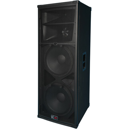

Old school in looks only. Any PA on a stick configuration is not going to handle the huge power/volume requirements. Speaker technology has advanced a lot, but only in refinements (Neo magnets, carbon fiber or Kevlar cones, waveguides over horns, etc.), but drivers are still the same approximate size as they were in the 80's. But this system is easily HALF the size of the 80's equivalent.
I mentioned earlier that club band PA's used to use concert gear for club use. That was big and bulky -- horn loaded mids, etc. That part has evolved a lot. And concert gear has also evolved a lot, but there's not much there we can re-purpose (See my comments about line arrays) for club band use.
..Todd

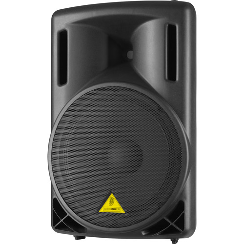

Just to be very clear. The PA on a stick products (see picture 1) are not what I am talking about. They are FAR too small for the type of bands I am talking about. These certainly existed in the 80's too, just not in molded plastic. Nothing new there.
I am, however talking about something to compete with the bigger modules that are readily available from all the usual vendors, (see picture 2.) My concept is slightly smaller, but I would expect it to sound a lot better than a pair of 15 inch drivers and a horn.

The stacked tweeters/CDs, like you have, "mounted onto elliptical OS waveguides", are not sure a good idea.😕
Some modern 1" compression drivers can manage to keep up with a pair of 8" midrange drivers.
I'm thinking particularly about Radian 1" drivers that are about 110 to 112dB/W.
If I was starting a project like this from scratch I would probably use a 2" compression driver between a pair of 10" mids.
The 2" compession drivers are still 110db plus but can take more power and bandwidth.
Again Radian make reasonable examples, and you can also convert a 2" JBL mid driver to cover the HF with a radian diaphram.
