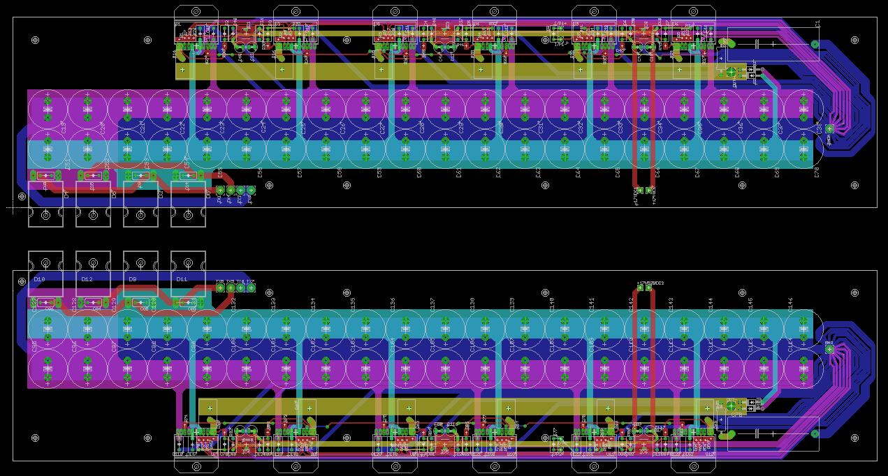

Then this comes a bit close... 😀 This is what I am listening to right now 😀 For the record this is a bridge monoblock, excluding the inputstage.
With kind regards,
Bas

I must say we had the luck that we knew the driver it is designed for, and therefore we could calculate the exact Zobel filter fitting this particularly driver.
Interesting. How do you do that, given Thiele-Small parameters for the driver and parameters for the speaker box?
I'm in the same situation, trying to figure out an optimal chipamp for a specific speaker. The speaker is a Beyma 12SW1300Nd in a sealed 30 litre box, for F3 = 118 Hz and Qts = 0,5, with a 58 ohm impedance peak at 90 Hz and just 6 ohms at 20 Hz. It will be crossed over around 130 Hz, so there are some wild phase angles and impedance variations in the passband, and it will get +6 dB digital eq at 20 Hz to flatten the response. Not a trivial load.
I was thinking two LM4780 with one paralleled chip on either side of the loudspeaker (i.e., BPA200) and a suitable Zobel on each chip to keep it stable. Would appreciate any advice!
