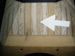

What`s that between the layers of wood that can be seen on this and many other pictures?:
http://www.hifidiy.net/UploadFile/2005-11/20051114135330509.jpg
I think it must be this?:
http://www.hifidiy.net/UploadFile/2005-11/2005111413494718.jpg
Looks like sheets of lead to me!?

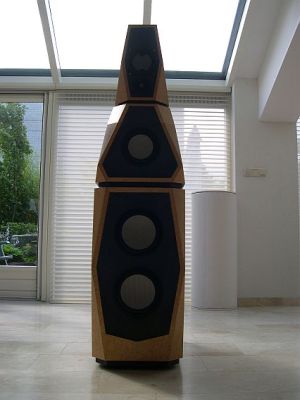

project called "violators".
because it's made with cad/cam instead of handworks.
this handworks comes in later.
the hole project is during for two years now, and i'am still filtering
before the fineering stage.
i hope the hole will be finished this summer.
an ultemate project, for less money.... you see i'am dutch.
more to find on www.htforum.nl design and making of the violators, have fun.

the material inbetween is lead!
also used in my speakers, decoupling the various of layers
mdf/lead/multiplex/lead/chipwood makes a weight per cabinet of 180 kg plus.

there is far more lead in my speakers....
in the top, in the mid and the bottom section.
see pic. all the grey lines
notice that the part is built of several structures perpictial!!
also built of different thickness layers of mdf/plywood/multiplex.
i try to find some pictures of teh building process later.

I have a passive filter custom built by a pro...who preferred not to be mentioned.
The subs are active filtered by a Bryston.
I use a total of four identical amps namely the Aitos 80 OTL.
The units are all ceramique except the tweeter that's a diamond.
Completely silver wired.
Subs (sides) are sand-filled which makes the xXx-Speakers approx. 250 kg per side.
Filtercabinets are massive ebony with abalone-inlay
Total costs about 20.000 Euro's.
Any other questions from him I am glad to answer
