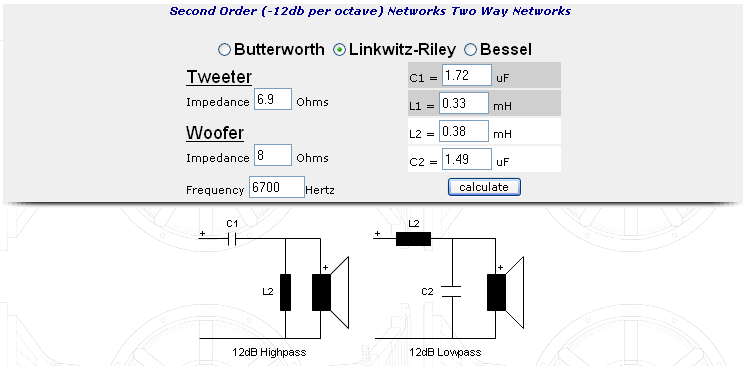

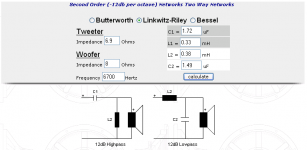

I use a 6.7Khz crossover point.
I paralleled a 39R resistor directly across the tweeter to attenuate the output and match my application.
These tweeters are a little more than 8 ohms.
My DMM measures 8.5 ohms (which doesn't mean it is, but they spec 8ohms +/-15% and they seem to be always higher), I took this value with the paralleled 39R = 6.9 ohms.
No series resistor (no L-pad), just a parallel resistor.
Then I calculated a Linkwitz-Riley crossover, because it matched the exact value of the inductors I had around here. 😀
That gives 1.72uF (1.5uF//220nF) + 0.33mH
Perfect, sounding good.
