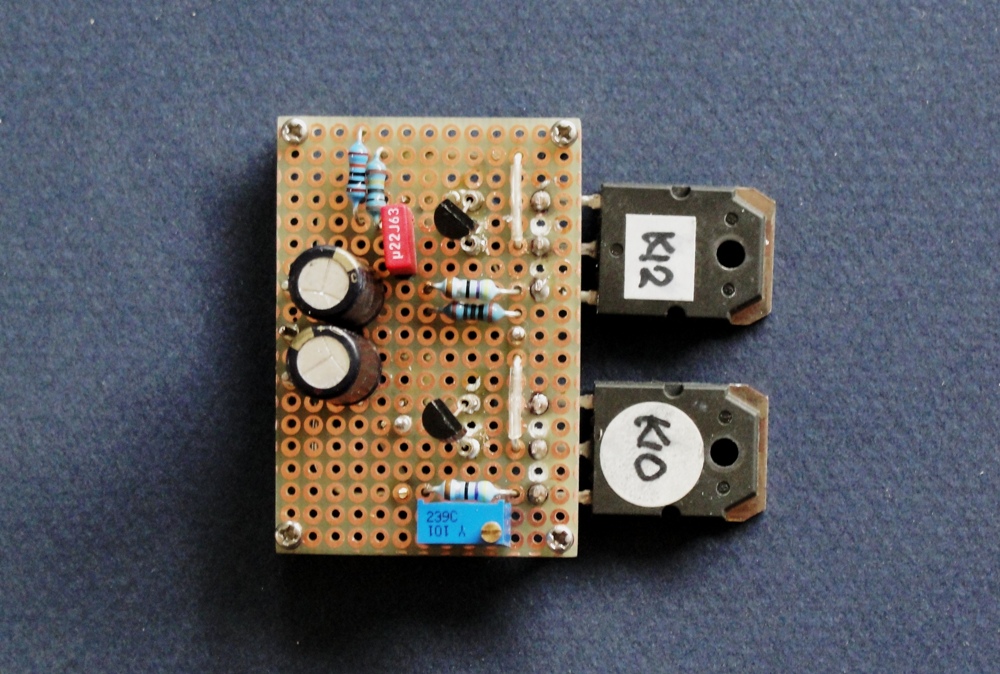

Just to prove that it works as intended, I grabbed what I had in the drawer and made a quick-and-dirty Vero-prototype.
I did not have any Exicons on hand, so I used 2SK1058 instead.
They were also not well matched, and I did not both to trim either.
Even then, with nominal calculated resistor values, bias was 125mA and DC offset 30mV, as expected.
Both bias and DC offset were rock steady over an hour.
The current ratio was easily adjustable via a trimmer at R5a/b position, as intended.

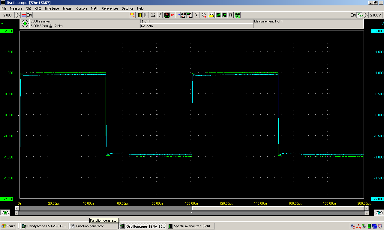

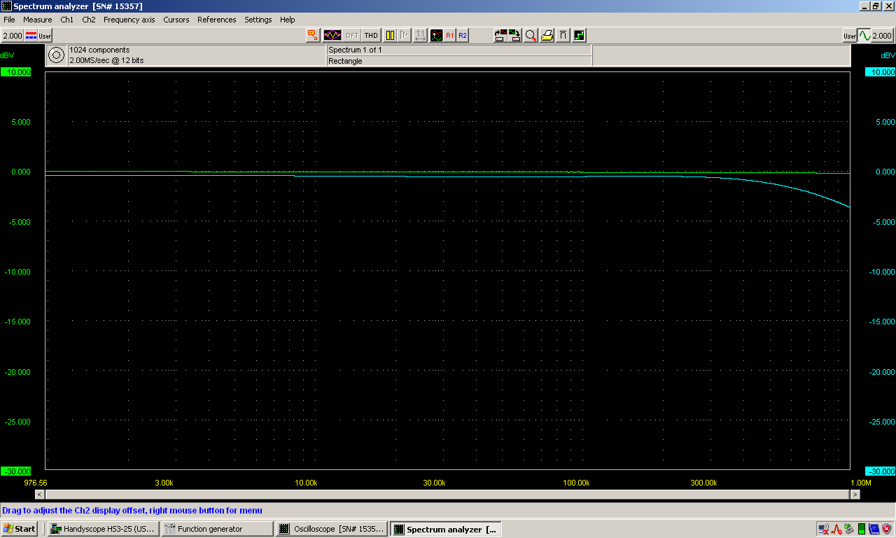

Bandwidth was 900kHz -3dB, and 10kHz square wave has a tiny single overshoot.
So everything works as in simulations.
So much for now, till proper PCBs and matched devices are available. 🙂

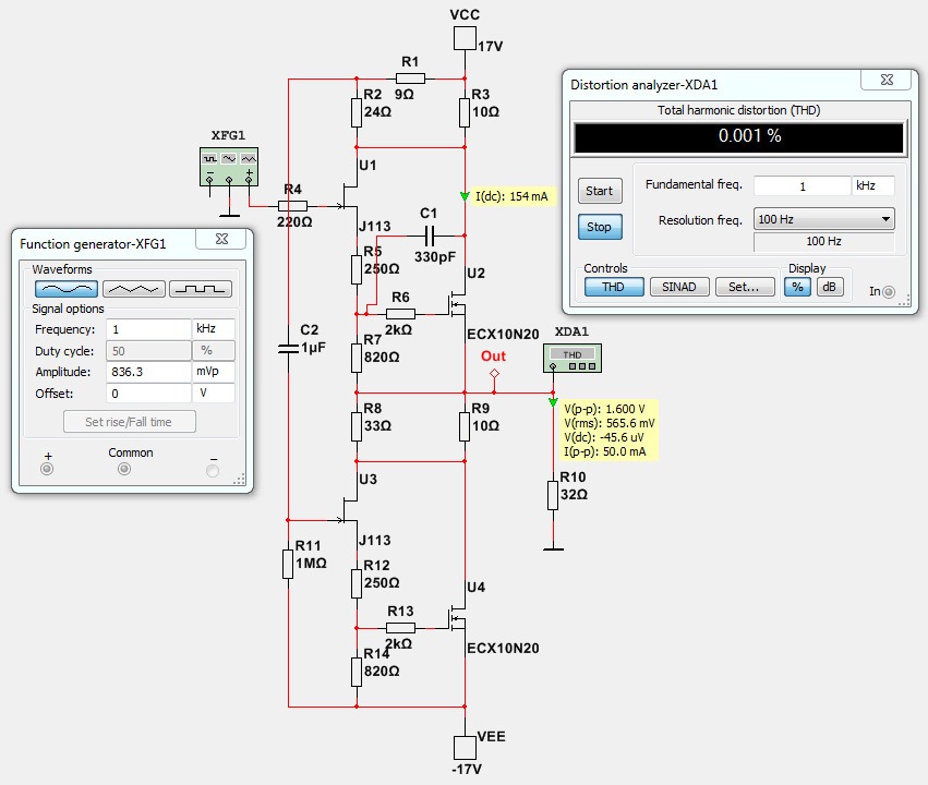

I will go for +/-17 volt.
And use J113 in the schematic in the PDF.
I will not build it. Only do some simulations.
Unfortunetly I can not use .asc files.
Because I use Multisim.
I have J113 and ECX10N20 spice files.
My J113 model:
IDSS = 18.9mA
1mA at VGS -1.07V
If I can't use that model at 150mA in the EXICON I will go for some alternative JFET.
My ECX10N20 shows VGS 0.82V at 150mA.
How about using LSK170, LSK189 or the duals LSK389 and LSK489?
Here is my SPICE.
My J113 model works.
I have adjusted for near zero DC offset.
The distortion was lowest when using 24:9 Ohms. THD 0.001%.
I have used compensation to fix the frequency curve. C1=330pF.

Your simulation looks fine to me.
If you read the article, you will know that none of the above would do.
Id at -0.82 Vgs just too small.
2SK246GR / 2SK208 GR will also do, and can be used with +/-25V rails.
You just need to watch dissipation with 2SK208 ( active part at Mouser / DK ).
And model available directly from Toshiba.
Actually 2SK246/208 would be a better match with 2SK1058.
Patrick
