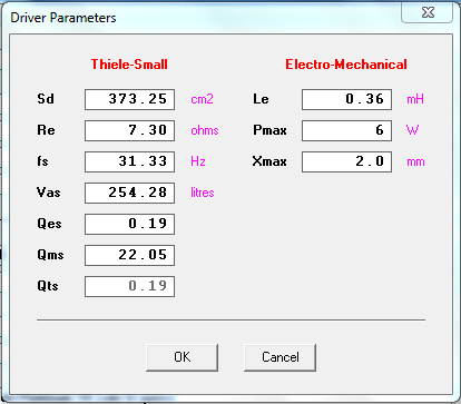

Indeed, though with HR's help, here's the reconciled specs (assuming they're not complete 'flooby dust').......

BLH wise, absent any additional series resistance, Fhm = ~330 Hz = too much BSC unless in 2pi space, so 8 ohm matching impedance SET amp is the way to go to put them up against the wall (~1/2 size) and 16 ohm taps for corner placement (~1/4 size).
