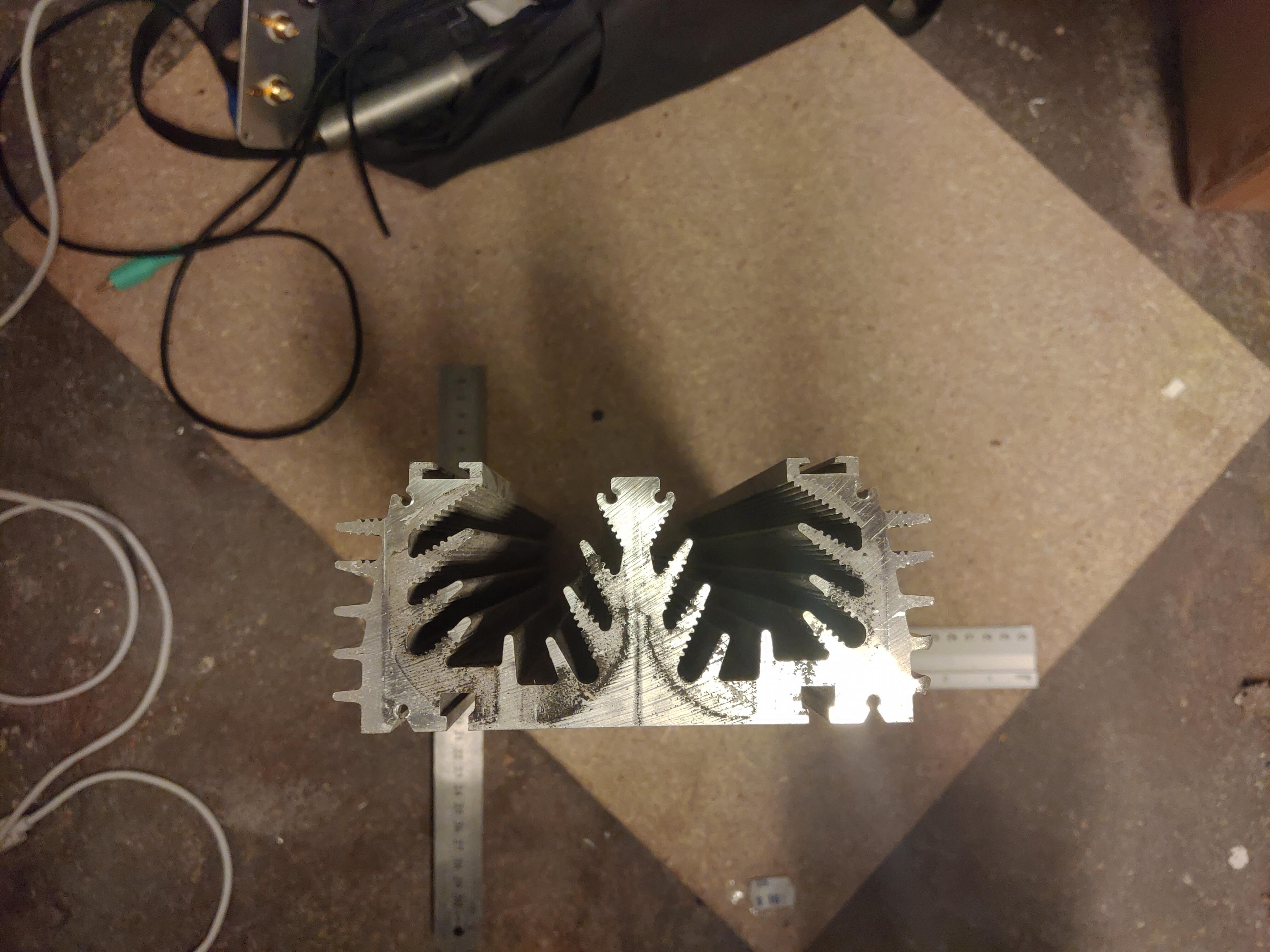

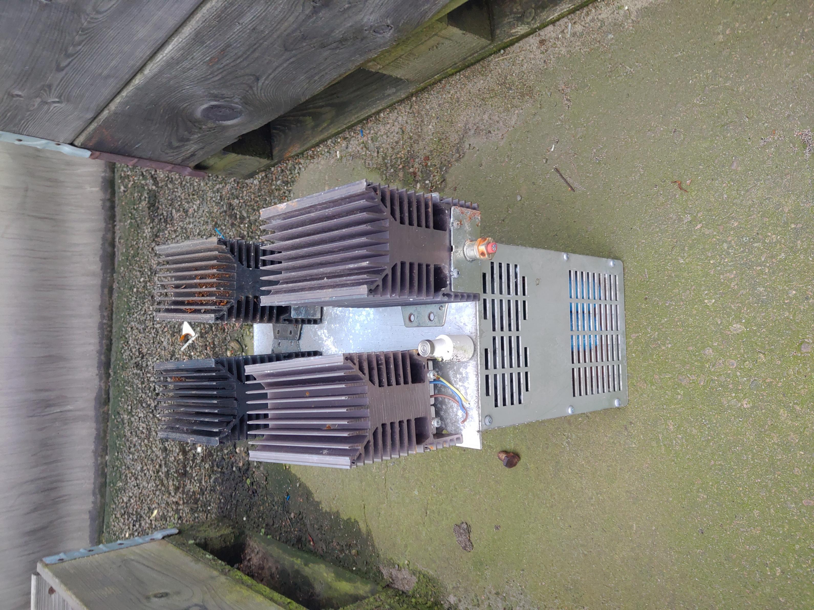

Hi, almost a year later and I have some different options for cooling.
First up, the four sinks a few posts back. They measure roughly 140x80x110mm each. So one sink for one pair of transistors.
The other option is the one attached. It measures 330x140x60mm and I can have it split into 4x parts 80x140x60mm with one for a pair of transistors.
If I runt the amp at the specifications provided by Audiosan
200VA 2x18Vac transformers and around 1.3A bias you will get around 25W class A @ 8ohm.
Is it your estimation that I could get away with either of the two options or is the latter to small?
All should be fine for 2 TO247/263/TO3 pair of output transistors class A. Make sure the fins are vertical and airflow is not blocked.Is it your estimation that I could get away with either of the two options or is the latter to small?

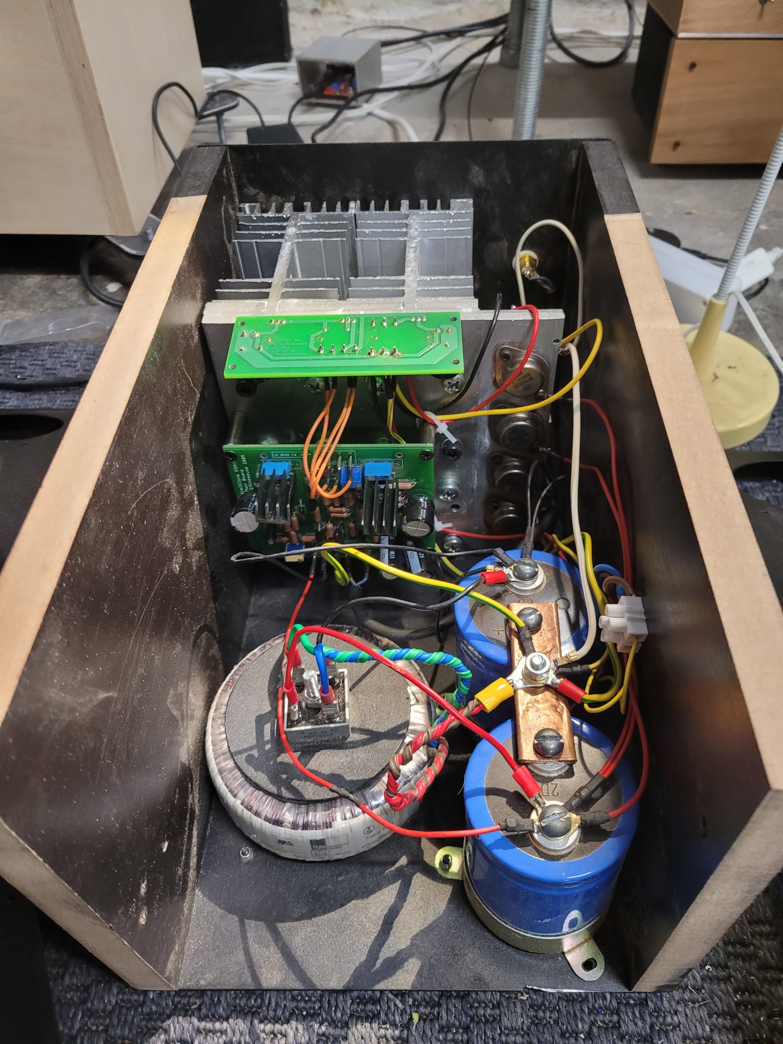

As for example testing the Amp on the bench BEFORE stuffing it in a small chassi....

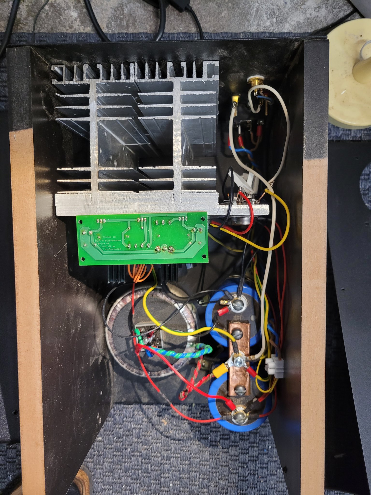

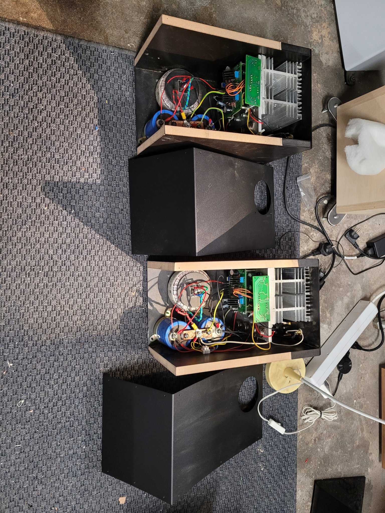

- A blast from the past (2005), The scrapped KSA-50 clone
