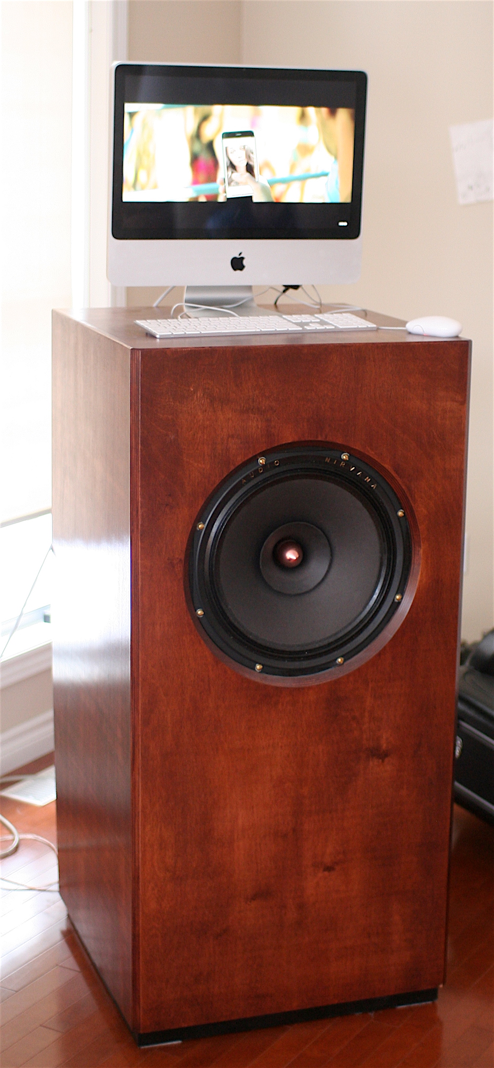

Let this be a warning to all ...
I got lazy, I thought it would be OK to put another speaker on top of my Big'un. Then another amplifier box. Then a couple more experimental items. Then some wires. OK, it was starting to get messy. And then it happened. She said "that speaker might be too big for this room" ...... whoa ! 😱

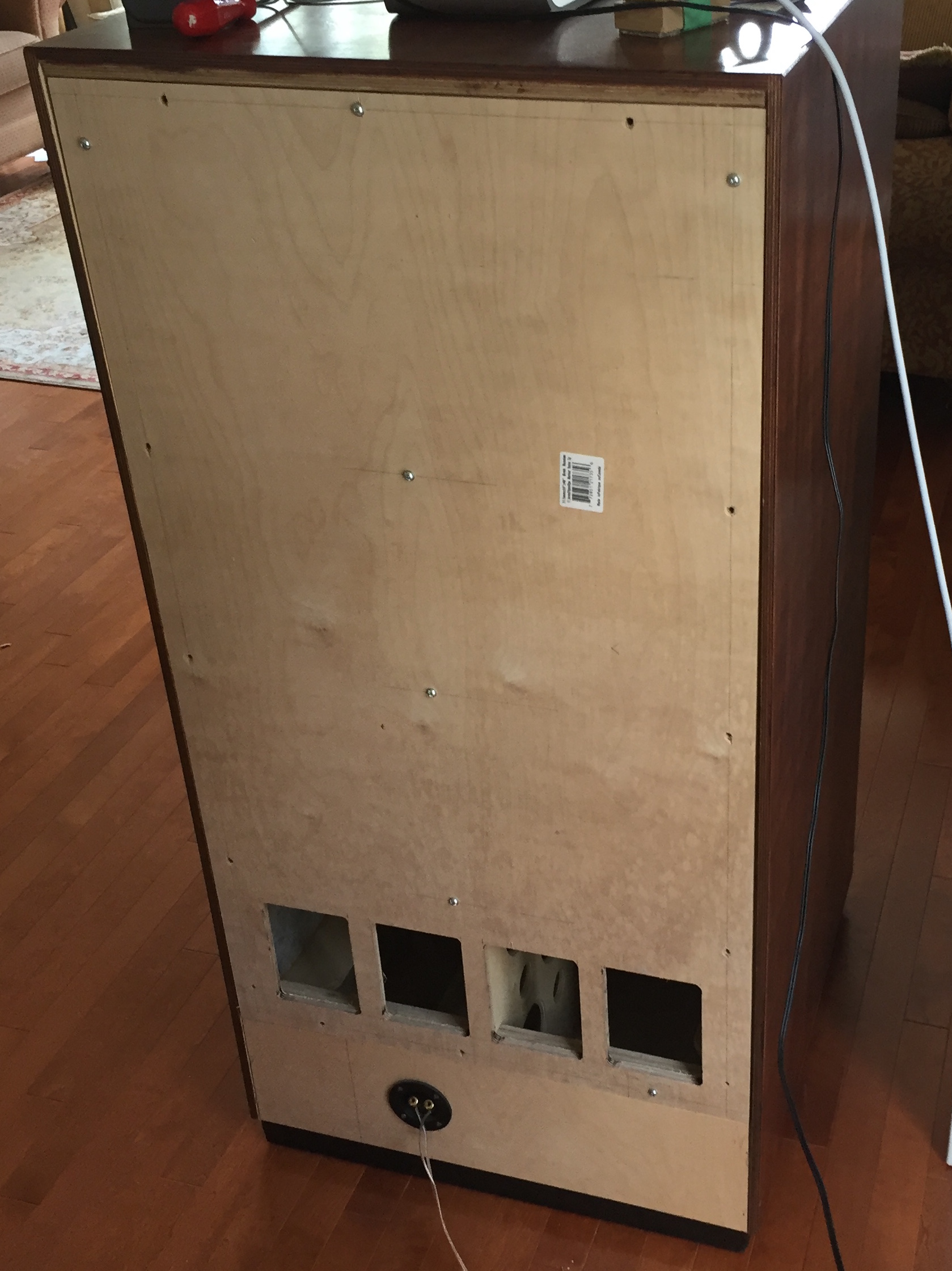

I decided to try out the back panel again. Last couple of times I felt the sound had lost it's life and had to take it back off but with OB the bass does have a hump in it that isn't quite right I suppose. Given that the high frequencies come off the whizzer there is no rear-sound wave except at the lower frequencies from the main cone. So I looked up the design from David who supplied the driver and there are supposed to be 3 round holes in the front baffle. I wouldn't call this a BR design but they do something. I don't want to put holes in the front of my nice speaker box so I put them in the back panel. I've put the back panel back on the speaker to try it out and see how I like the sound.
Initial impression is that I am losing some ambience in the room that I previously enjoyed, but the lower mid bass sounds flatter without any loss of extension. Early days, will have to live with it for awhile.

i believe this is considered a 'distributed port'.

12mm Baltic Birch, 88 sq. inches total for the holes. Volume of box is somewhere in this thread!
really? @ post #453?

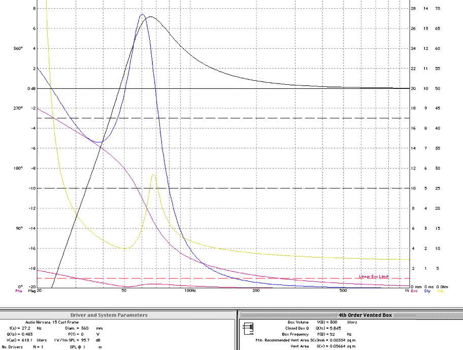

Given the size of the box and the aspect ratio of length:area of the holes it just looks 'wrong' to model it as a BR. Maybe there's some accidental MLTL here too ?
Haven't tried any resistive material in them holes yet.
P.s. I suspect volume is closer to 350 as the internal sound padding isn't as thick as I assumed at the start of this thread.

Obviously this is assuming the TS parameters are accurate.
It would be best if you can measure them yourself, better yet best to do in room frequency responce measurements.

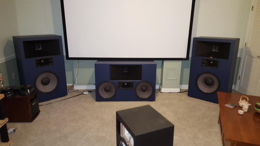

I am used to big speakers, here are my home theater speakers (all JBL Pro drivers, not replacing anytime soon):

It's still the best speaker I have - still didn't get motivated to build something else although the 'itch to build persists. Unfortunately, the exact driver I used in this thread is no longer available, but Audio Nirvana still offer a number of large drive units that would be good to work with.
Your speakers, when taken together, are larger than the screen!
