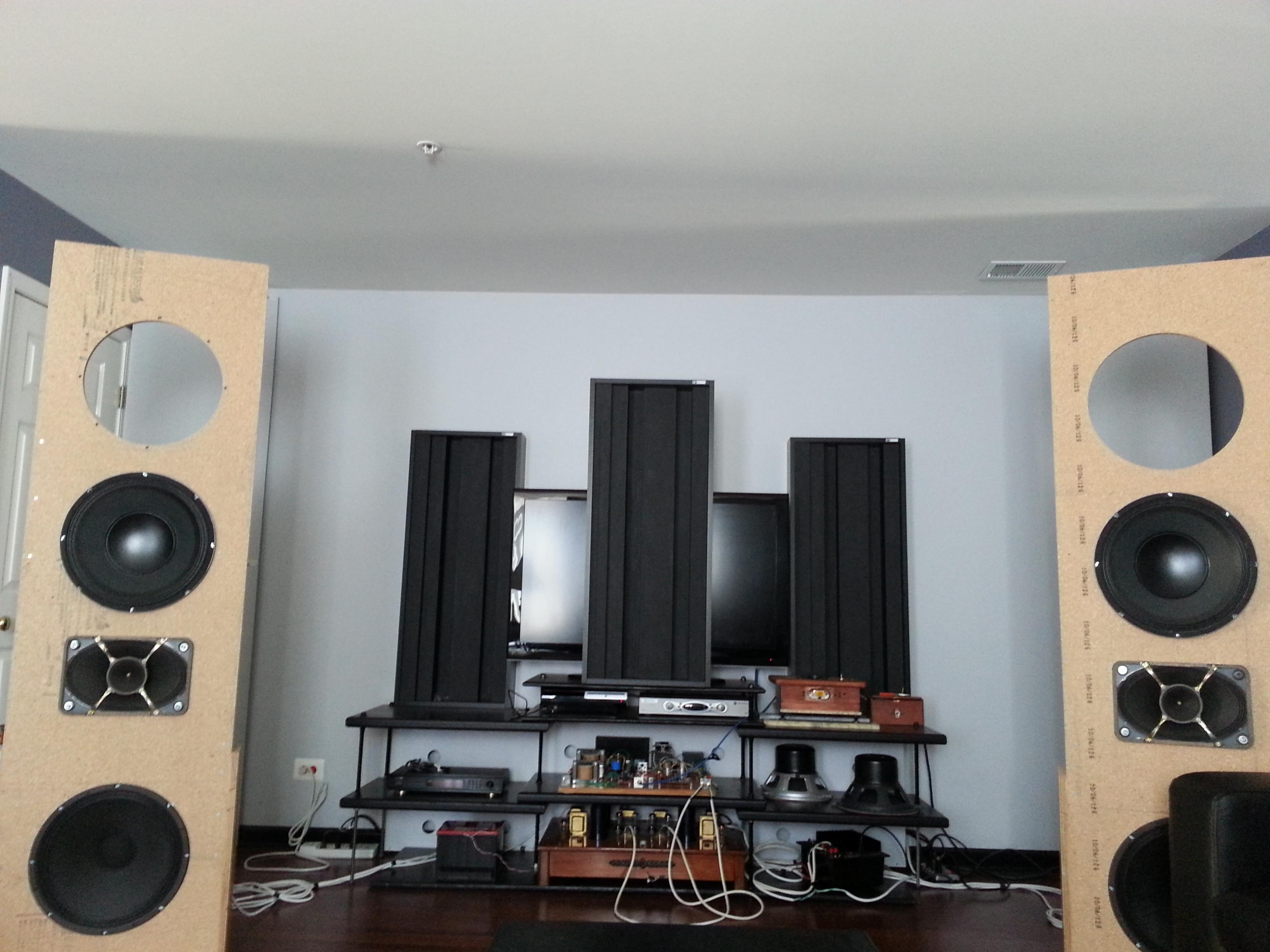

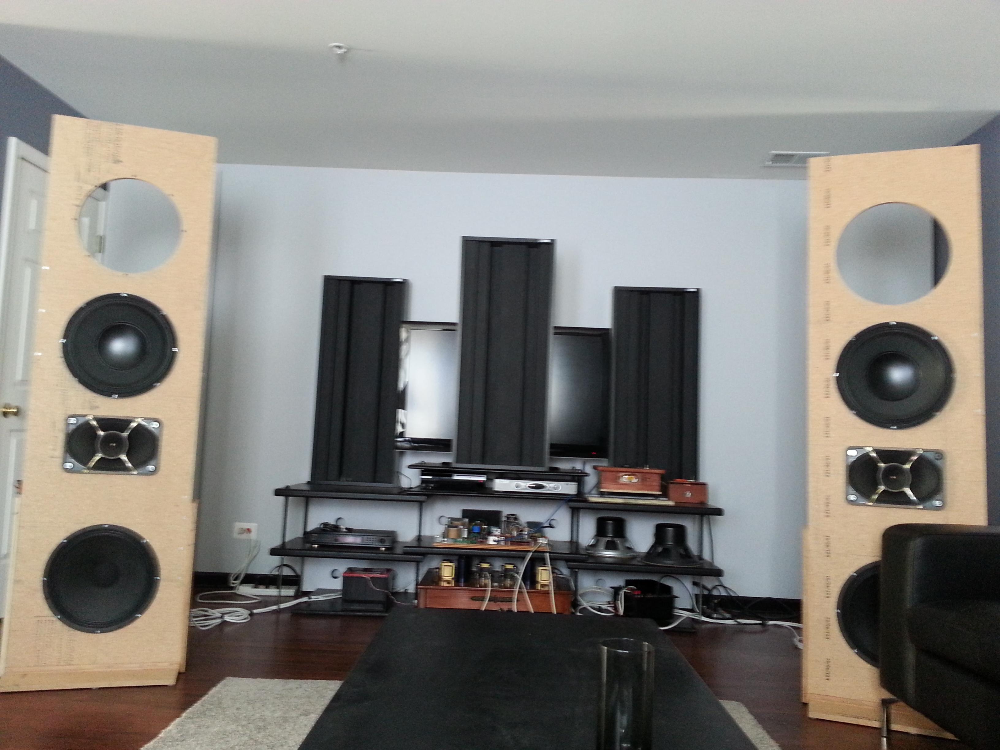

Im really interested with these drivers. I have the super 8 and super 12 but im not using them anymore. My current setup is isophon ph2132e crossed around 270hz 1st order with a 15" hawthorne audio mid bass. No measurement were done yet as i don't have equipments yet and crossover point was determined with parts I have on hand. Im thinking of just going fullrane in open baffle. See attached Pics for my current setup.

How tall is that?
Can you explain the function of each in that open baffle.
It might be off topic.
its 6 feet tall. Its test baffle. 15" driver on top is hawthorne audio auggies driven by plate amp crossed around 50hz to handle the low frequency. middle is isophon ph2132e crossed Around 270 hz high pass for mid and highs, , bottom 15" driver is crossed around 270hz low pass for mid bass.
Im interested on the AN 15 alnico to simplify the setup.
