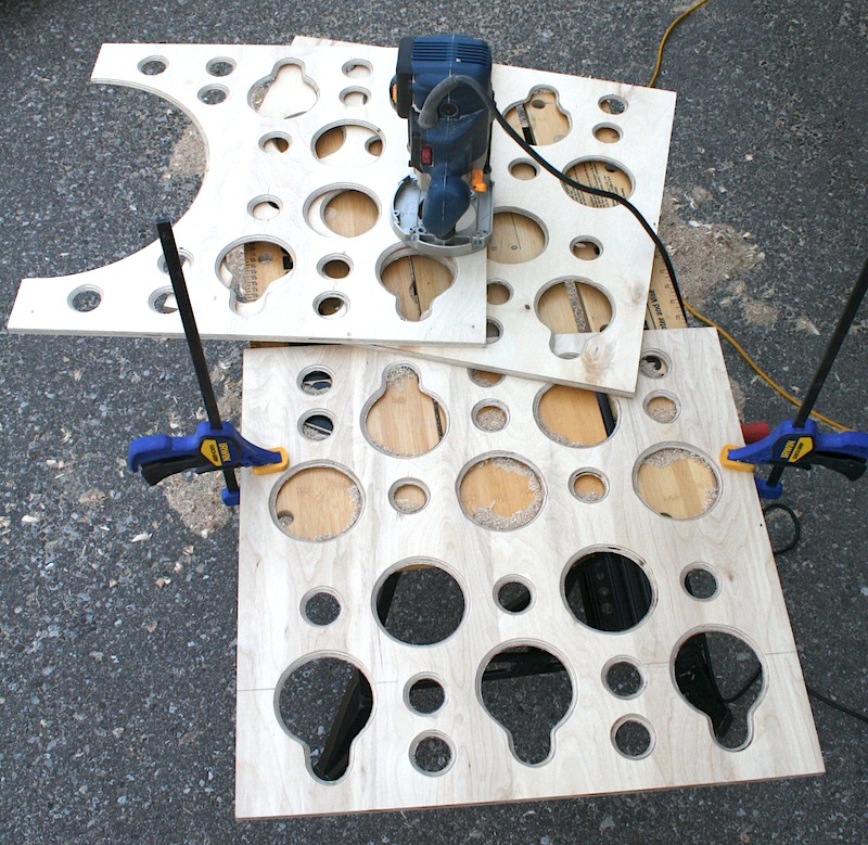

The holly brace 😀
It takes quite a while doing that. Nice work. Keep going. I want to see the smile on your face when you're listening to music through these suckers

the shelf braces are coming along...
that part certainly is the most pain in the wrists, ain't it?
Joined 2009
it certainly takes some time and effort to make a lot of holes !

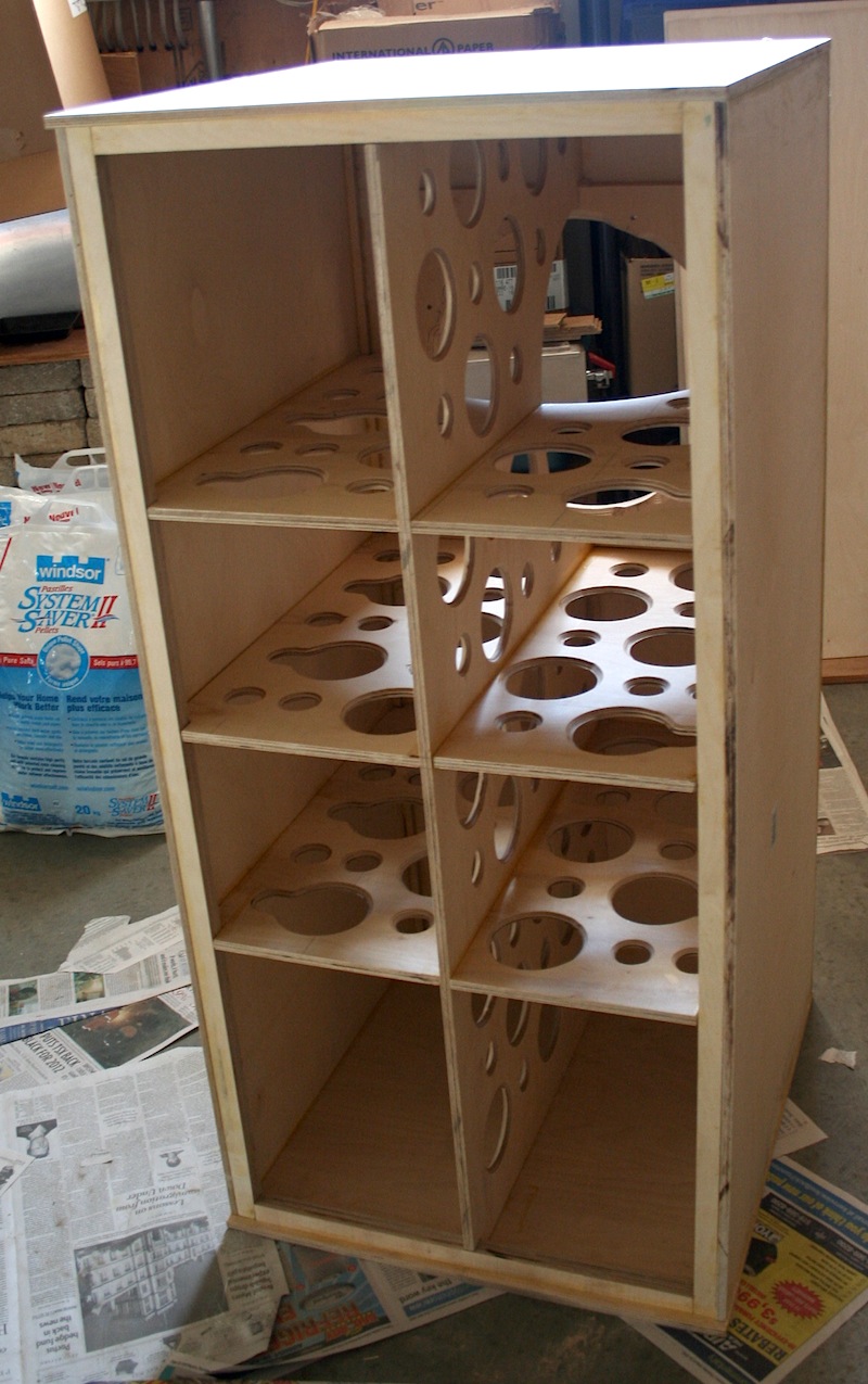

anyhow, the major braces are now installed along with cleats(?) around the back which I will use to bold the back panel to for testing.
The next step is to install a set of small braces to reduce the size of unsupported spans.

Man i know hoe long that took. Great clean work. I am expecting you to reinforce Melons ringing endorsement for these drivers🙂

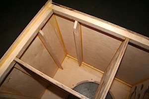

I've been adding more bracing, gluing ribs against the sides in order to increase the stiffness. It's already feeling very solid. The day job gets in the way a fair bit but I'm going to focus on the bottom of the speaker next - I want to glue on a piece of the back panel, just the first foot or so in order to provide a place to mount the speaker terminals and to provide another level of stiffness. I've added what nearly amounts to another shelf brace near the bottom but of a frame type not 'holey'.
The rest of the back panel will remain removable so that I can try it as an open-back speaker and also to allow ease of access to finish it off.

I'm placing extra ribs in parallel with the long direction of unsupported panels. These are nothing fancy, using up scrap pieces of wood left over from the build so far. They don't need to be positioned too accurately, in fact you want some variation around the box so that no two panels are the same.
Good shout on the little extra ribs, especially as the panels are so large. They work best if they are a different material (normally harder) from the panel itself, but as you have the holey braces in as well you'll be good to go.
