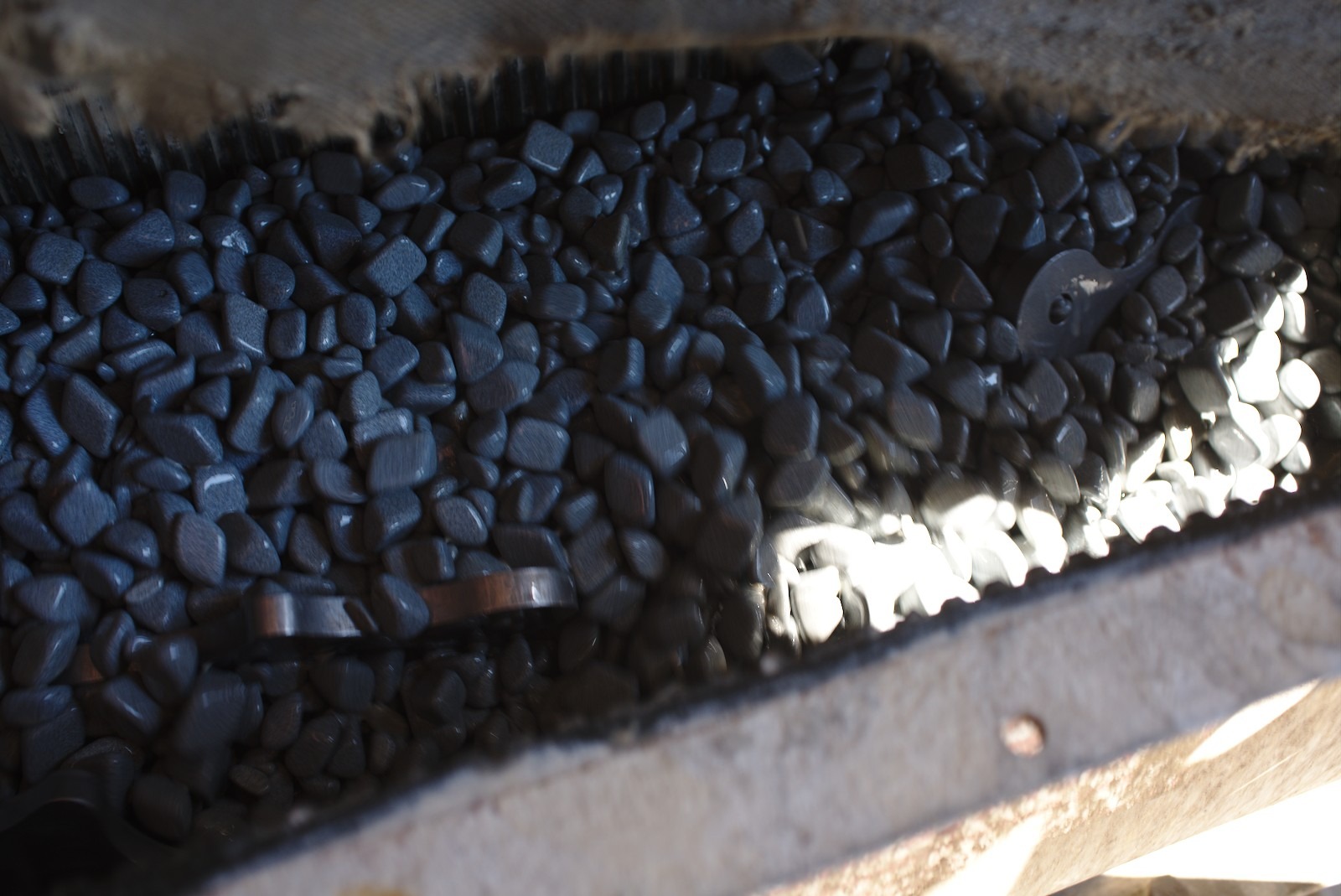

While rock tumblers are primarily used for polishing rocks, they can also be repurposed for other materials like aluminum surface finishing.
Indeed! I have a rotary one from back in my slotcar racing days to clean, 'spit shine' my scratch built brass/piano wire chassis, modded motor cans, etc., modded plastic hand controllers, jewelry, bullet shells, you name it, just change the media, grit to suit and a vibrating one for fine jewelry, watch parts, etc..
However, you might need a larger tumbler and different abrasive materials suited for metal. If you're curious about how to adapt a rock tumbler for this purpose or need more tips, you might find some helpful insights at https://rockstumbling.com/guide.While rock tumblers are primarily used for polishing rocks, they can also be repurposed for other materials like aluminum surface finishing.
A solution of lye and water will give aluminum a nice, satin, finish. Rinse thoroughly after the lye bath, and best to finish with a clear coat, or paint before it oxidizes.
Read about that years ago, tried it and it worked. Sorry I can't provide times and/or solution mixes. I may have the original article buried somewhere on a hard drive.
Metal Finishing Journal (tm) used to come out with a yearly compendium of who was doing what and what current best practices were. They concluded that there was noting new under the sun about 10 years ago and ceased publishing. I guessing they are probably on line somewhere, and they were the bible on how you applied any finish, conversion coat or etc.
https://www.practicalmachinist.com/...etching-6061-aluminum-to-satin-finish.208839/Read about that years ago, tried it and it worked. Sorry I can't provide times and/or solution mixes. I may have the original article buried somewhere on a hard drive.
Use river bed pebbles / gravel as media, apart from ready ceramic media.
Or find a metal shop with tumbling machinery.
Yeah, the OP mentioned he used caustic soda (lye) prior to anodising. I've done it and agree it gives a nice frosted finish.A solution of lye and water will give aluminum a nice, satin, finish. Rinse thoroughly after the lye bath, and best to finish with a clear coat, or paint before it oxidizes.
Apparently people are using a cheap concrete mixer, about 1/16 the cost of a similarly sized vibratory machine.
