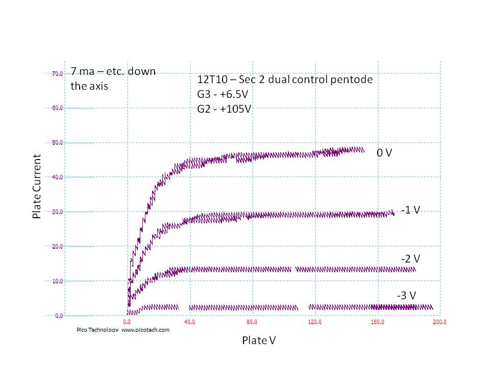

Here are the curves for a 12T10 sec 2, with G3 elevated to 6.5V (4 old D cell batteries, used what I had...). Looks really good. Now I need to go back and rework things. Somehow I think I may actually end up building a half-way decent amp out of all of this.
The graph is kind of raggedy because I'm pushing the limits of my digital scope. It has 8 bits per channel, and the current is measured by drop across a 10K resistor on the plate by measuring the voltage on both ends. 200V give or take at each end takes the 8 bits. About 50V across the resistor, which gives 6 bits for the current, or about 1.5% resolution. This is the best it will do, but good enough for government work.

Something has been bothering me about my plan, I've attached a diagram that attempts to explain it.
Case "A" is as I tested it, case "B" is as I intend to use it in a LTP. In case B the "R" is intended to stand-in for whatever circuit actually sets the voltage.
In case "B" ~10X the power is being dissipated by G3, right? Or am I missing something.
Thanks...

Dooh! I should draw better schematics before I think about this sort of thing. I see it now, The tail resistor, the cathode resistor, the cathode iself, G3, and whatever is between G3 and the voltage source dissipate power the same way as a string of resistors does.
This is what comes of spending too many years doing only "digital" electronic projects, I've forgotten how to think in analog...
It just occurred to me that a tube suffering secondary emission might be a case where Ohms Laws don't quite apply correctly.
An energetic electron could bounce off the plate as secondary emission, but deposit most of its energy as heat there. While actually getting absorbed by say the screen grid and flowing out there. Tallying up the voltages and currents on the different electrodes would not come up correctly to Watts = V*I, although I'm sure the total energy gets conserved, or we would be doing more of this "cheating".
I've learned one important thing over the last evening. The properties of G3 vary widely between tubes of at least two manufacturers: RCA and GE (who also apparently made "Realistic" tubes by the appearance). Can't use a simple voltage divider without dropping a lot of current through it, since the amount G3 pulls (pushes? :) is very different between the two manufacturers. Otherwise the tubes behave the same way. I suppose since using it this way is "out of spec" it wasn't something measured or designed to.
For my design the voltage needed will come out to around 80V or so, so I guess I could keep it "pure tube" with a gas-filled regulator. Or just cave in and use a zener....
P=VI is not Ohm's Law (that is V=IR). Ohm's Law is not a law of nature so it doesn't matter if it gets 'violated'; it simply says that for many conductors it turns out that current and voltage are proportional.
P=VI is a law of nature, in the sense that if you have simple geometry it will be true. For more complex situations you have to use the Poynting Conjecture, which enables you to calculate the total energy flow into a closed surface from knowledge of the fields on the boundary. Energy is conserved, but the heat in an electrode might not arise simply from the current flow to that electrode.
Taking the simple case where there is one secondary electron for each primary electron, you would get zero anode current but still some anode dissipation. The total energy would come from Vg2 x Ig2, even though some of this would heat the anode instead of the screen.
