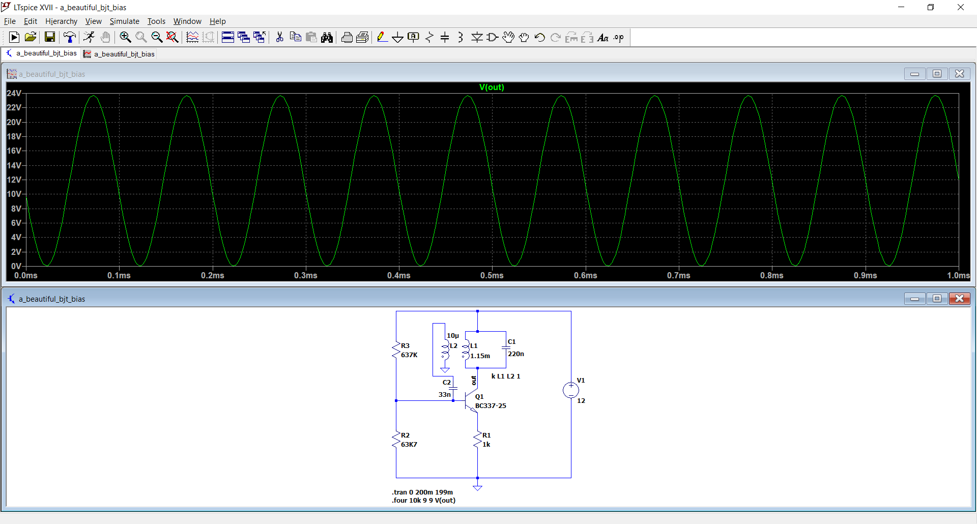

The schematic attached shows a single BJT oscillator using a biasing scheme which I found very interesting, and efficient. The 10kHz output sinewave is very clean considering the simplicity of the circuit. The oscillator uses an LC parallel resonator as the transistor's output. It taps some of its energy into a short coil to feed the base.
Inspection of the various currents under LTSpice shows that the LC resonator receives an energy pulse for a very short time during each cycle.

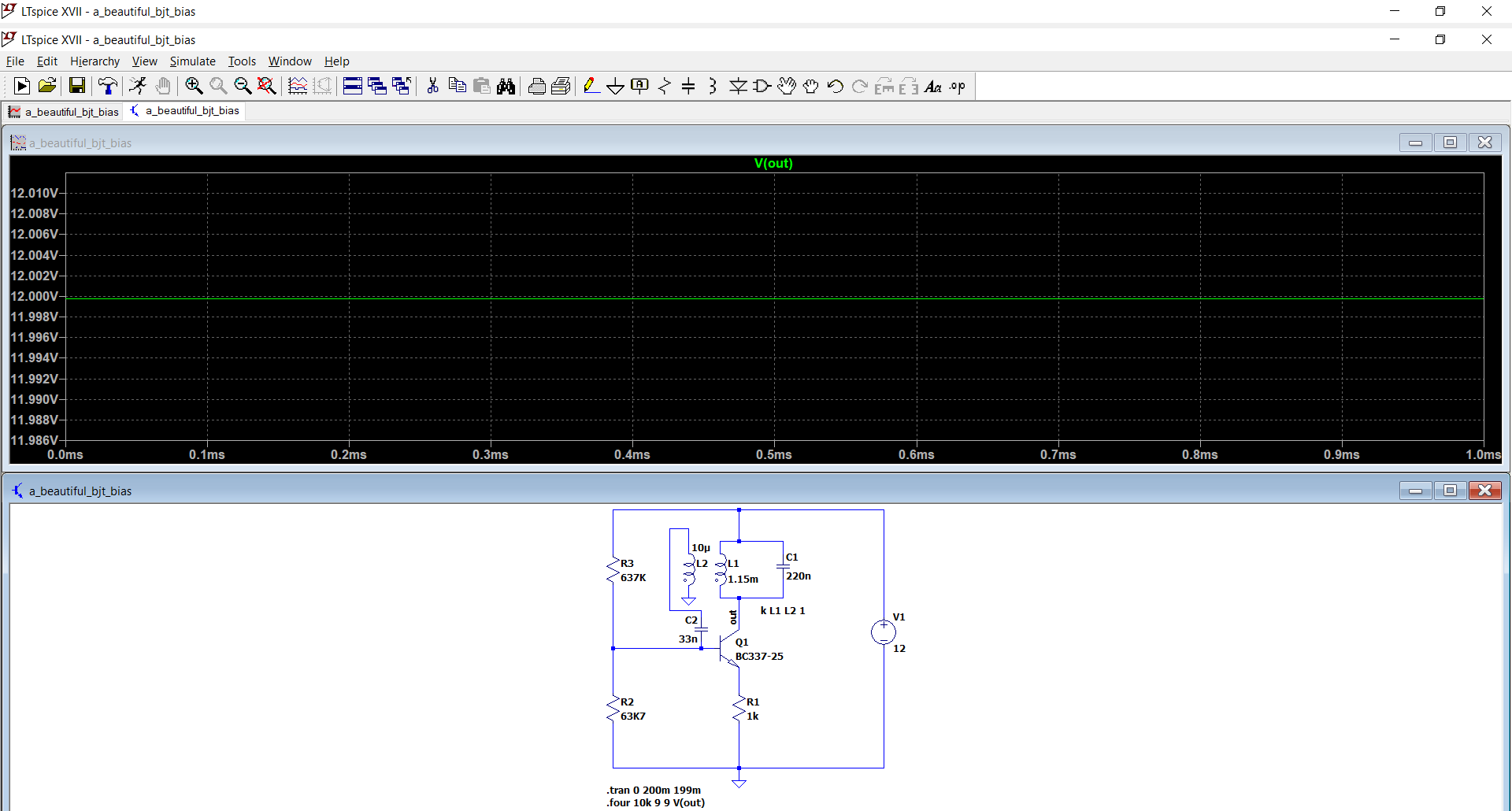

You probably made algebra or arithmetic errors: it works for me (as it should, of course):
attachment.php
However, if the inductors include half-realistic parameters, it stops working:
attachment.php
