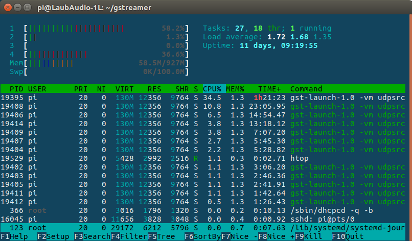

What's the CPU load and memory usage for this new approach? Do you have a htop snapshot?
I'm running a 2.1 system on a Pi 3 at the moment, as a streaming client, receiving 2 channels of 16/48 PCM audio. The crossover consists of 5 ACDf ladspa filters and output is into two stereo DACs (DACs are running synchronized). TOP shows 42% CPU and 1.3% memory usage. Most of this is gstreamer overhead, not ladspa CPU demand. You could use 50 ladspa filters if you wanted. Since gstreamer is multi-threaded (unlike ecasound) the application should be able to smoothly scale up to the full potential of all cores on the system.

That must be 42% of a core, not the entire CPU. "Top" always confuses me with its irix mode ([shift]) that reports either total or core. I prefer "htop" and its semi-graphical.

OK, I took a snapshot of the system running on the Pi 3 that I described earlier, using htop. See attached.
OK thanks, that looks like about 40% of the overall CPU, I see 2 idle cores waiting for a convolution engine.😀
Splitting hairs here, but I see more like 25% of the total CPU judging by the bar graphs at the top. The first core is running at 58% and the last core at 37%. Taken together that's about 1 core out of 4, or 25% of total. But whether it's 25% or 40%, there are still plenty of untapped resources!
