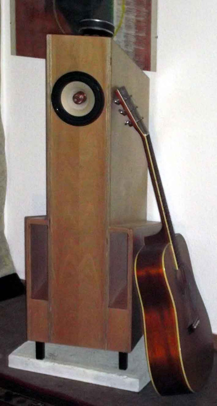

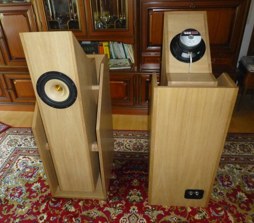

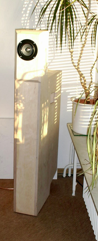

i made a few double horns, more or less omni without disadvantages:
look my double horns:
Hornlautsprecher
