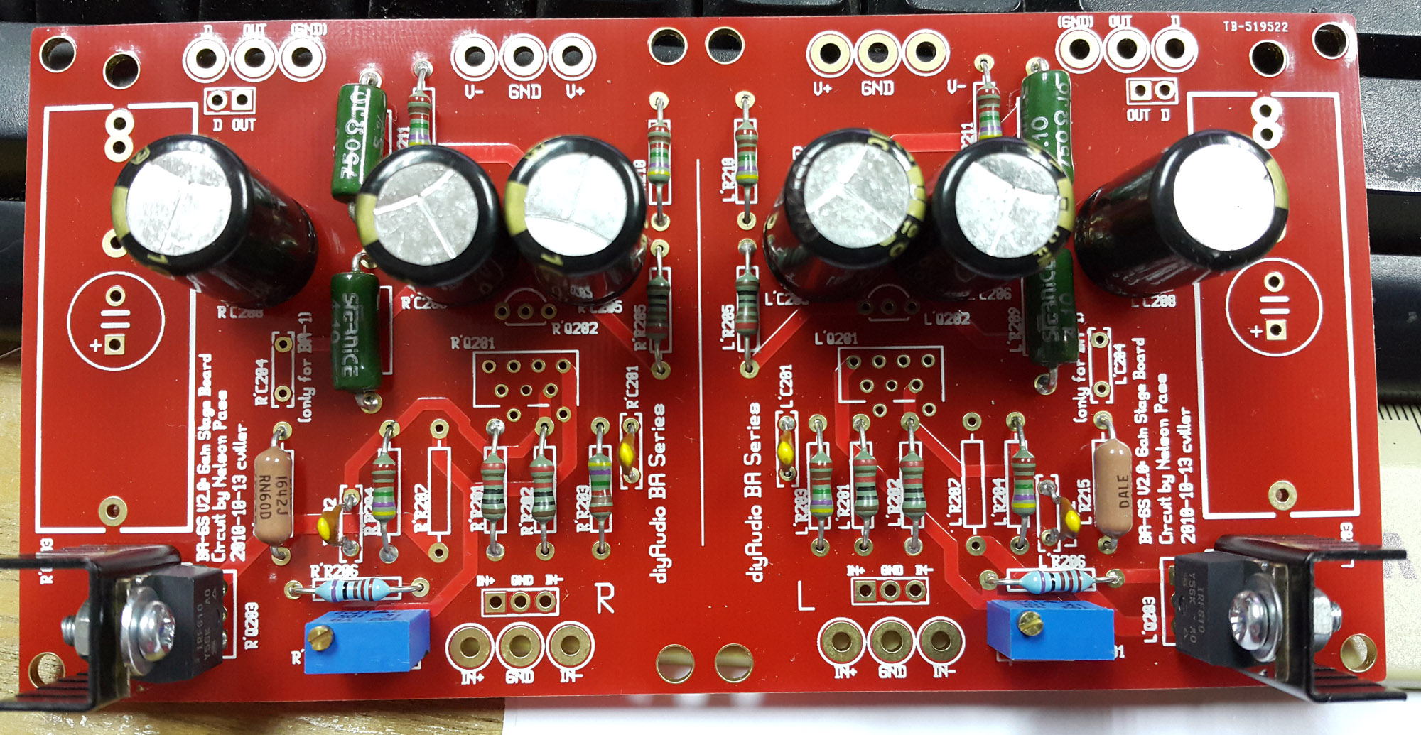

After long sourcing the parts, finally I managed to get all the parts.
This is the picture I almost finish. Please check is this correct? I'm a newbie here and I don't know much about electronics. I can't find much info/pictures here.

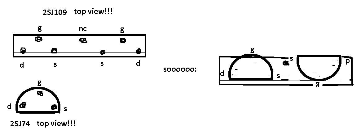

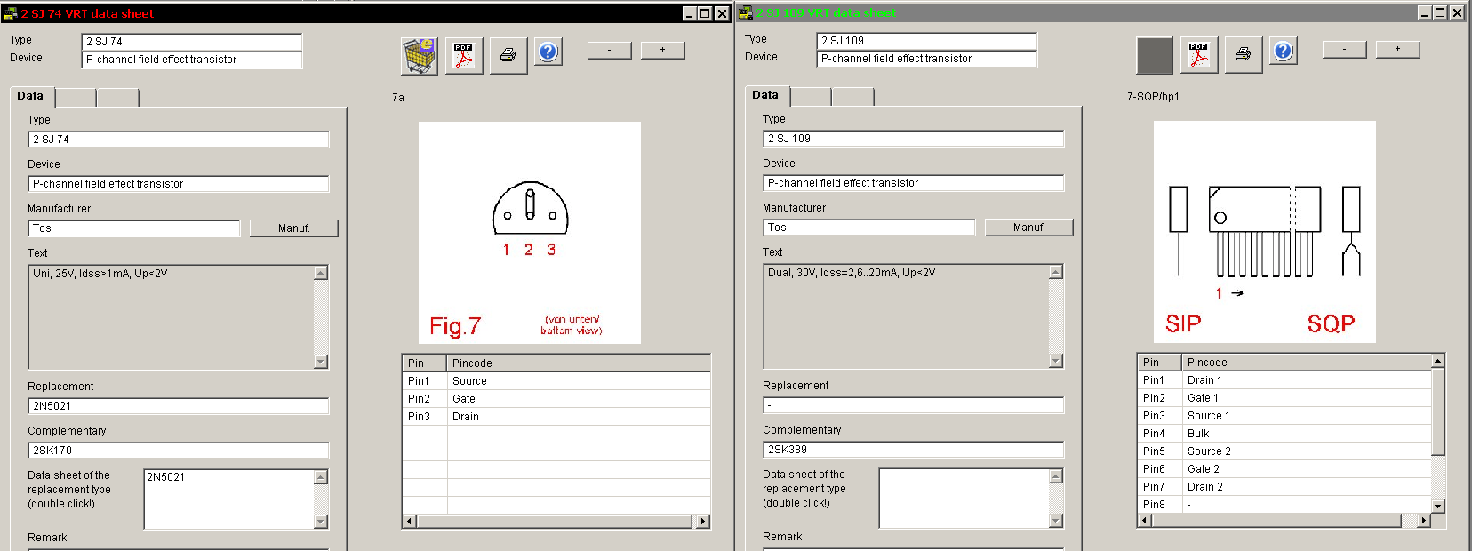

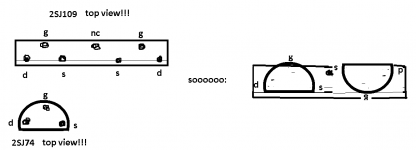

The parts I left out at the moment are C203 (10uF), 2SK170 and 2SJ109. I managed to get some 2SJ74 which I heard it can be parallel together, but how do I parallel it? Is there any diagram I could refer to? For example the leg arrangement.
This BA1 I would use as a pre. After long reading this post, I notice that R207 will leave it empty and the variable resistor need to be changed to 1k, correct?
