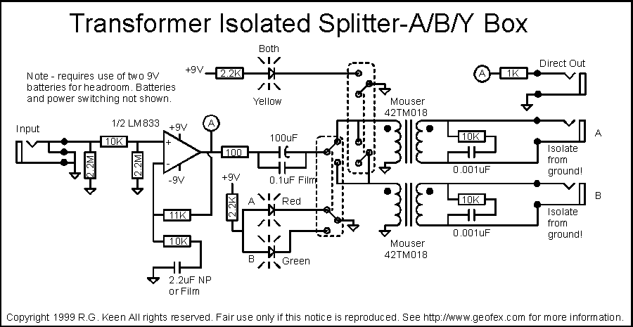

so if i made a buffer and connected its output to both amps, it would probably hum?
i will make something like this, with three switches: left on/off toggle, right on/off toggle, and switch to turn them both on and the same time. CMOS!

Hi Travis,
That is a nice buffer design! Should do the job nicely as all possible earth loops between the pieces of equipment are broken.

is this how it would look with out all the extra mumbo-jumbo?
i want to make sure i understand what's going on. how do i go about picking good specs for the transformers?
Travis,
You have the drawing right. However for your scenario you could get away with just one transformer as you only need to break one ground connection. You would need a normal 'line level' transformer 1:1 ratio meduim impedance.
