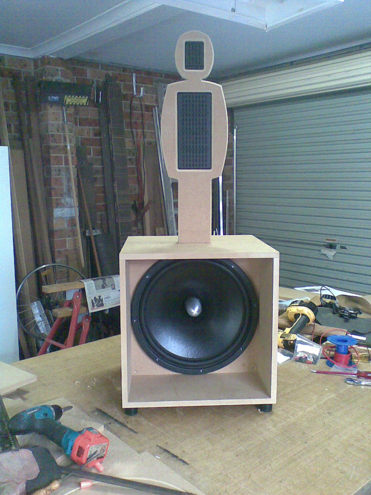

The speakers in the active are Neo 10, Neo 3 & Acoustic Elegance Dipole15, prototype below, I'm going to replace the Neo 10 in one of the speakers with the SABA 8", run them on mono & switch between to see how they compare as the SABA is great with voices.

Is that an H-frame for the 15"? It looks deeper than the one I'm planning. (MJK style) What are the dimensions? Would you do the H frame again for woofs?

Yes it is a H frame, the overall length of the box is 16" so the front section you can see is about 8" deep. The P17 speakers I built first have a U frame which seems to work ok & I cannot find any problems with the H frame, so yes I would use it again.

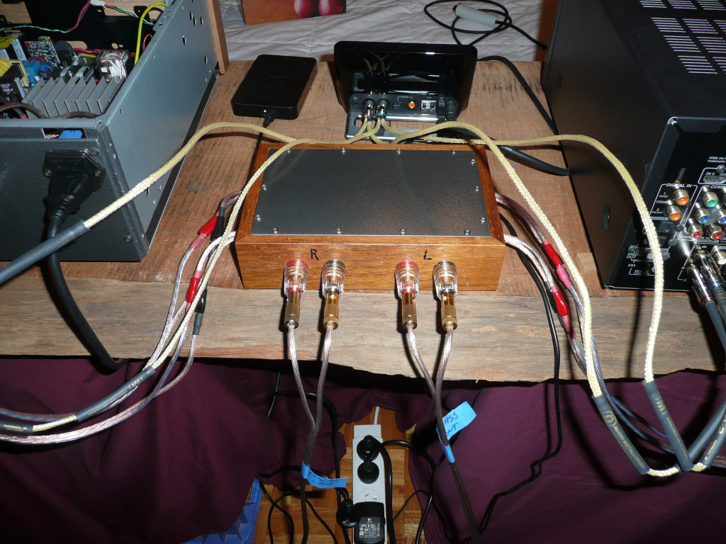

Update
I've, blind tested the 17 year old daughter & she likes the Coldamp better, I also tested the 57 year old brother & like me he couldn't tell the difference.
It's finished
It's finished
That looks great.

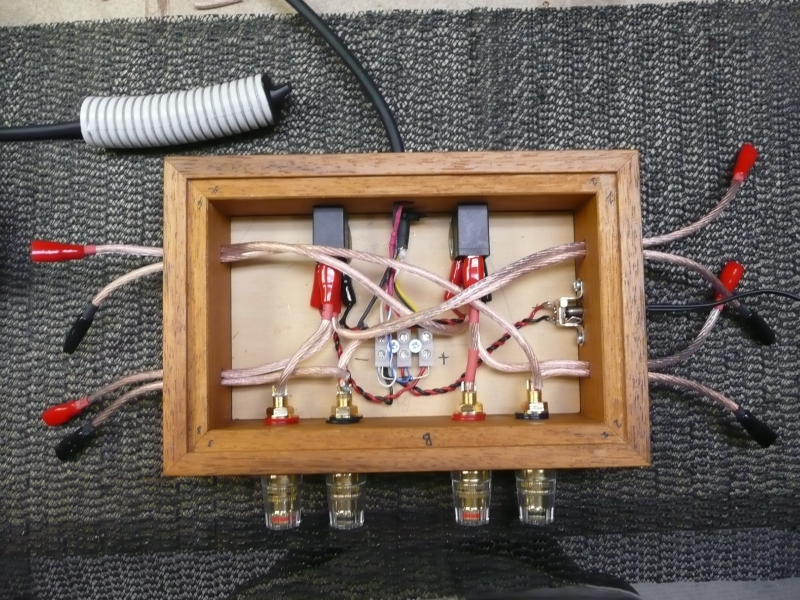

I was wondering if I could have a few more details on the construction!
What 12v power supply did you use?
Did you just use an spst switch on the controlling circuit?
I am have never messed with this stuff before, and I can't decide if I want to use relays or just a simple 4pdt switch. (only switching when it is off)

Hi
I followed the information on this site A-B Box For Amplifier Comparisons. From memory I just used a 12v SMPS I had laying around.

I found that building and using an A-B switch box was very interesting and useful.
If you have the relays switching both the ground and the signal wires gets around any problems with ground loops / bridged amplifier outputs or other issues. I just used parts I had so it wasn't optimised.
The test results were interesting. there were little to no differences between sensibly designed amplifiers. Also little differences between CD players apart from one British Cottage Industry one that had a curtailed bass response.
As post #11 says it's essential to match levels very carefully to within a fraction of a dB.
It's also possible to compare loudspeakers when the differences are massive. Also it's very difficult to match levels because of the uneven frequency responses both of the units and because of room placement.
