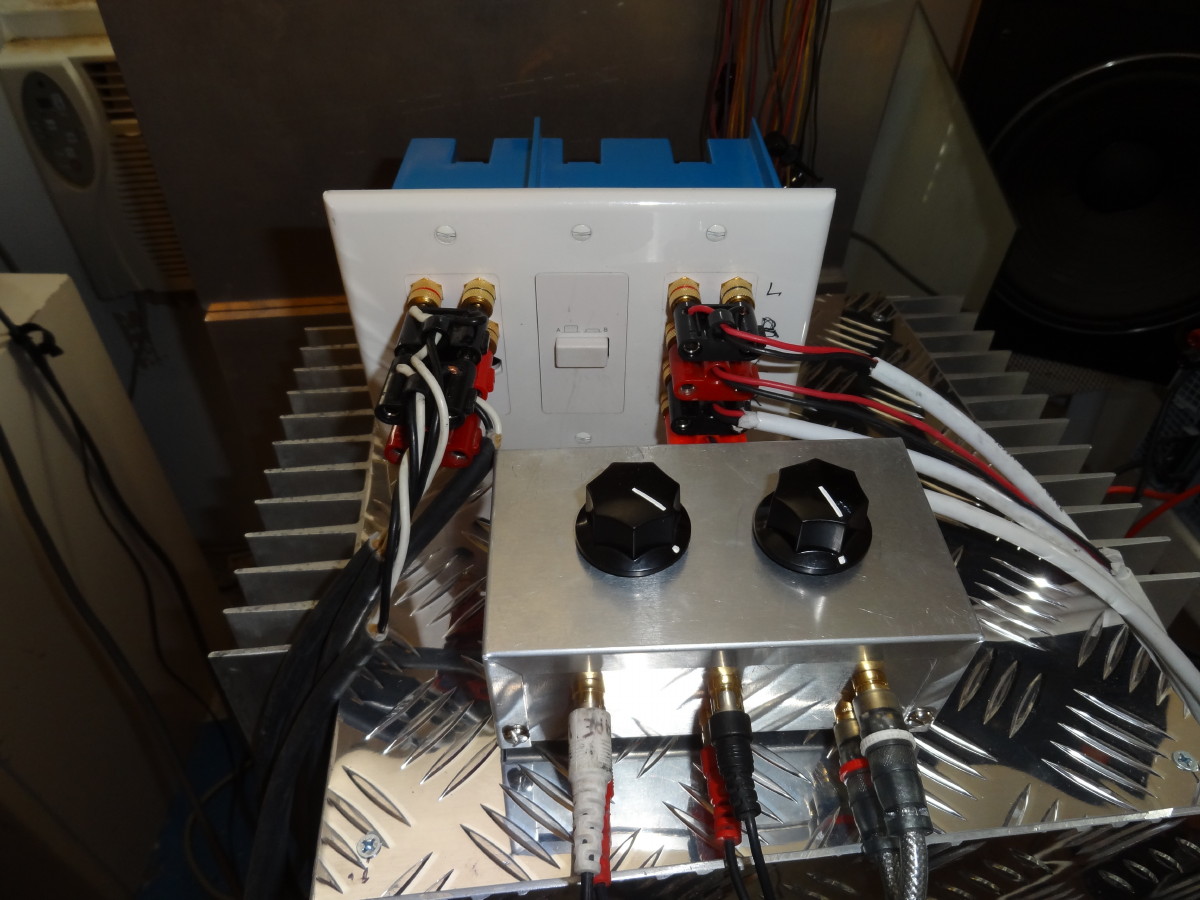

A while back, Carlos challenged me do an A/B test with one of his amps and any other amp. I have been doing comparisons between the amps I have built for long time but always using two separate preamps and two sets of speakers but no matter how I hooked it up it was difficult to make quick enough switches to be able to really hear the subtleties. So I went about to make some equipment to be able to better tell what exactly was going on. So, the first thing I did was build a speaker switch. This allows me to switch between two amps and listen through the same set of speakers. I suppose it would also allow me to use one amp and two different speakers is I were A/Bing speaker cabinets.
Anyway, once I got the speaker switch finished I was still using two different preamps so I could adjust the volume of each amp due to the fact that different amps have different gain. Even with this I could never be sure if the differences I was hearing was the amps or the preamps. So, I decided to build a volume control box using two 50K "DACT Type SMD Stepped Attenuator 21 step" pots that I bought on Ebay. This setup, give a very good sound and I have pretty much quit using a preamp at all, even when just listening to music.
Now for the real kicker. I have found that once you get the volumes equalized between a pair of amps, the audible difference is almost indistinguishable. I was absolutely floored by how similar the amps all sound. You can look in my signature to see all the amps I have been A/B'ing. The differences are very, very subtle. The high powered amps gain a little advantage once you get the DB's up there, but for normal listening volumes, you would be amazed how close they are.
I am attaching a pic of my setup.

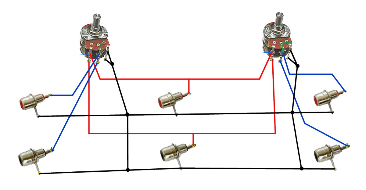

No I am using my ear. With the speaker switch, it is instantaneous from one amp to the other. I simply listen with my eyes closed and press the button in and out and adjust the volume controls until the "sound" is as close as I can get it. This is a listening test after all, not a measurement test. We have equipment for that. For those interested, these are the parts I used.
Speaker switch
Stepped attenuator
You can see the attachment for how I wired the volume controls.

I like the look of those DACT style stepped attenuators and may just have to order up some for myself. Certainly can't beat the price. I should also cook up some sort of amplifier / speaker switch as well since I have been doing as you were doing prior - play, swap, play... Makes your 'memory' of the way something sounds unclear. A set up like this would make comparisons more meaningful.
So far, the speaker switch has been working flawlessly. I'm not sure if it will eventually develop contact problems but so far so good. It sure makes switching between amps simple and seamless. Without the dual volume control box my findings were still a little skewed because I had to use two separate preamps to control the loudness of each amp. With the dual pot box it is very simple to feed each amp the exact same signal. I did add a 12K pot between the sweeper and ground of each pot as seen in figure #1 on this page.
