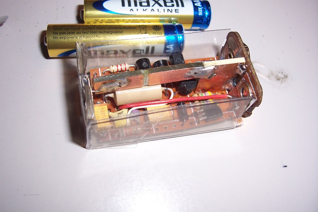

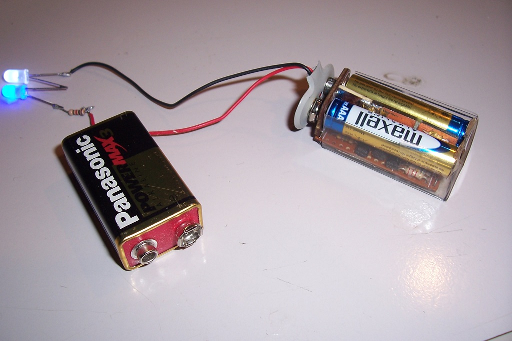

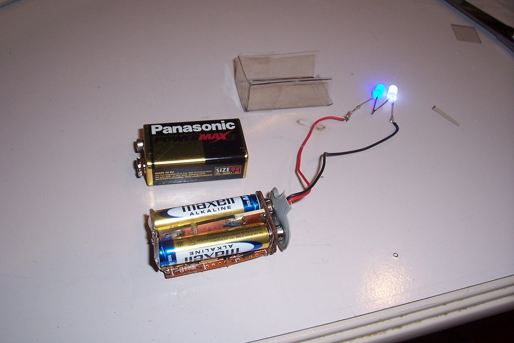

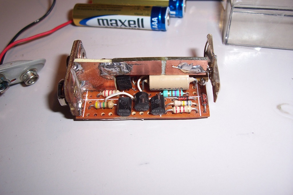

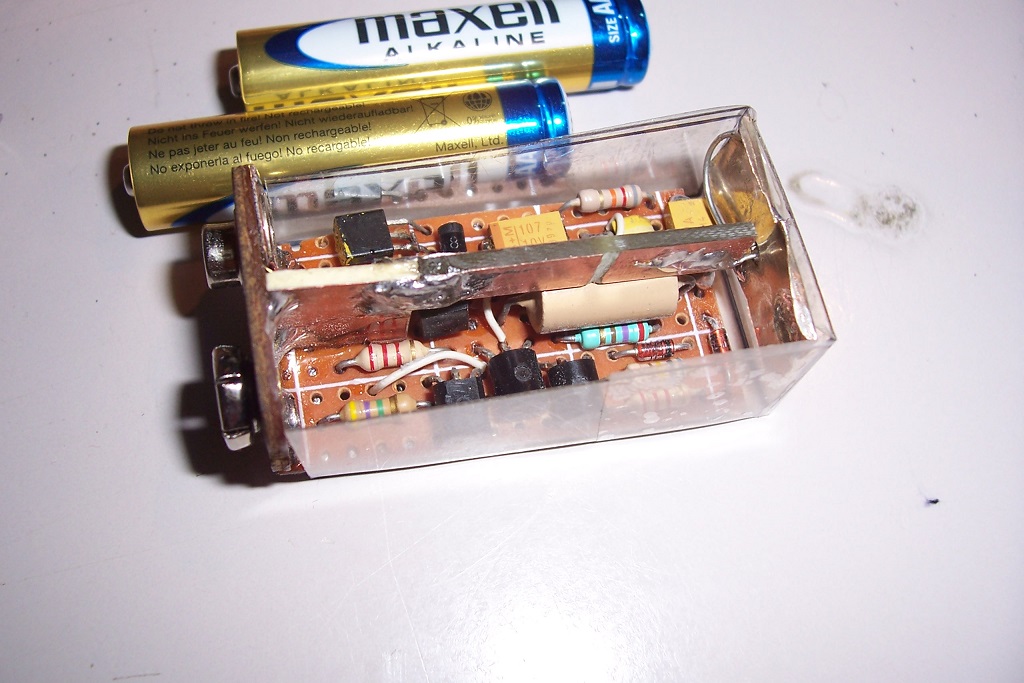

Here is the two-cell version:

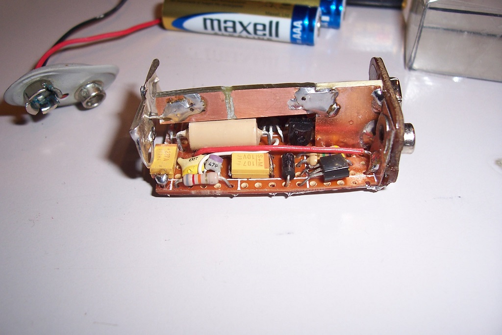

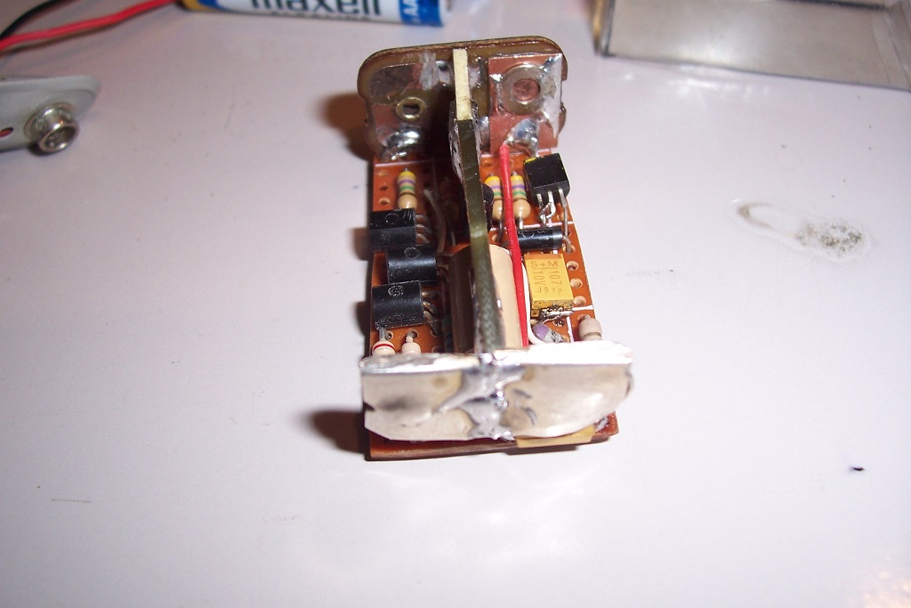

The mechanical construction is a bit finicky, and uses a PCB composite as a skeleton:

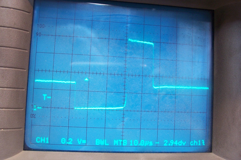

This is the waveform, very similar to the single-cell one, except the DC level and the absence of ringing, thanks to the snubber.
The snubber allows the elimination of the anti-parallel diode, which in turn makes the circuit inversion-proof:

The efficiency of the two-cell version has risen to 83% (2.8V input, 15mA output), even though the transistor is now a S8050 and the coil is of a lower grade too.
It allows an autonomy of at least 75% of a PP3.
The 14µA quiescent current allows a theoretical shelf life of almost 10 years.
It can operate from 1.8V to 3.2V (lower in fact, but to avoid battery leakage, it is probably preferable to avoid it) and supply up to 25mA.
