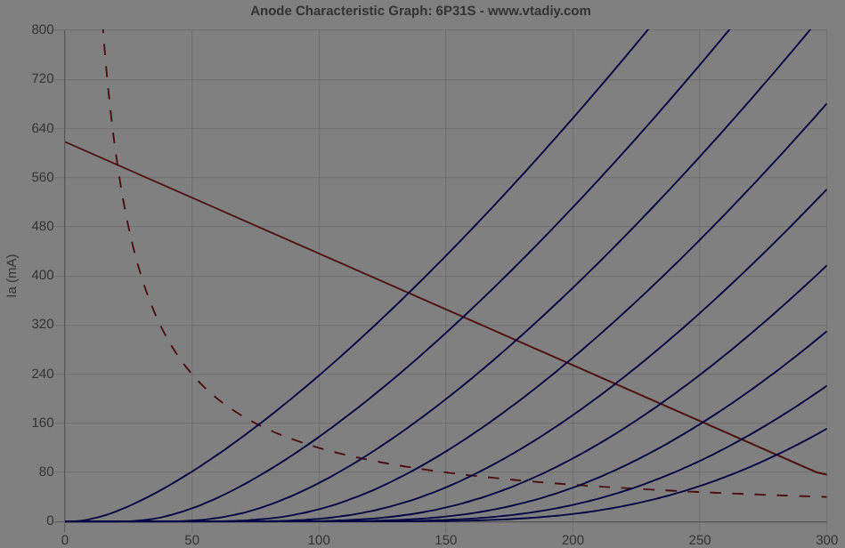

Yes, despite of what many eBay sellers tend to claim, 6P13S and 6P31S are different tubes. 6P31S comes close to EL36/6CM5.
