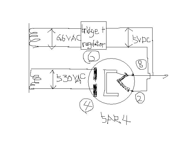

I am trying to feed my 5ar4 filament with DC voltage...., since my transformer doesn't have any 5vac winding. It turns there is no DC output at its cathode! I only measured 260AC at its cathode. It's like the rectifier got no function at all. The DC pass the tube directly! What gives? I flow the filament supply. It should be OK.

I'm going to assume there is internal damage to the rectifier tube, between cathode and one of the plates...
Swap out the tube and try another one.
be sure your rectifier and regulator are floating... The 5Vdc supply will be up at B+ voltage.

Ok, this might be a silly question... but its not clear from you schematic. I'm assuming that the ht transformer is centre tapped with the centre connection being the negative side of your circuit. Can you confirm that this is the case?

Your schematic does not show a center tap on the HV secondary. This must be connected to ground to get a positive voltage at the cathode of the rectifier.
There will be pulsating DC at the cathode. This requires filtering to be used.

No, as shown in the picture it doesn't have any center tap. I am thinking about giving up tube rectifiers. That is.its not clear from you schematic. I'm assuming that the ht transformer is centre tapped

I think 530vac is not a problem for 5ar4.What is the peak reverse voltage of that bridge recifier? You are probably exceeding it terribly...my guess.......

contaxchen said:[No, as shown in the picture it doesn't have any center tap. I am thinking about giving up tube rectifiers.
Without a centre tap that circuit won't work... you'd need to use both rectifiers to make a full wave bridge.
dave
Planet 10 is right, there is no current path through your circuit. But even if you get that right, until you put a filter cap on the output it will still measure high voltage AC since the rectified waveform is a steady stream of half sinewaves.
You guys are so right!
After loaded a bleader resistor and a power capacitor, I finally measured the supposed DC voltage at the the capacitor's anode! But, still AC at the 5ar4's output. Wah.... You guys are good!

martinab2 said:Ok, this might be a silly question... but its not clear from you schematic. I'm assuming that the ht transformer is centre tapped with the centre connection being the negative side of your circuit. Can you confirm that this is the case?
Nice pick up, Martin 🙂 I never thought it was something so basic...

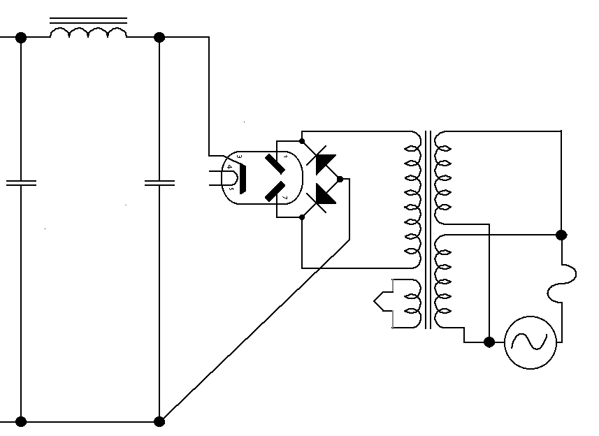

Lhchen, don't give up on valve rectifiers - the transformer is the problem, and not the rectifier. I suppose you could try using two solid state diodes to make a hybrid Graetz bridge rectifier using your transformer without a centre tap. I think you should get 700VDC or so out of it that way.
audiousername said:I suppose you could try using two solid state diodes to make a hybrid Graetz bridge rectifier using your transformer without a centre tap.
something like this...

I am using that Graetz already. Thanks for the help!
I have never tried this tube rectifier before. It's too much trouble really. I am considering 5ar4 this time, because I got a large Lundahl transformer and a large chassis. There is plenty of power and space to WASTE.
