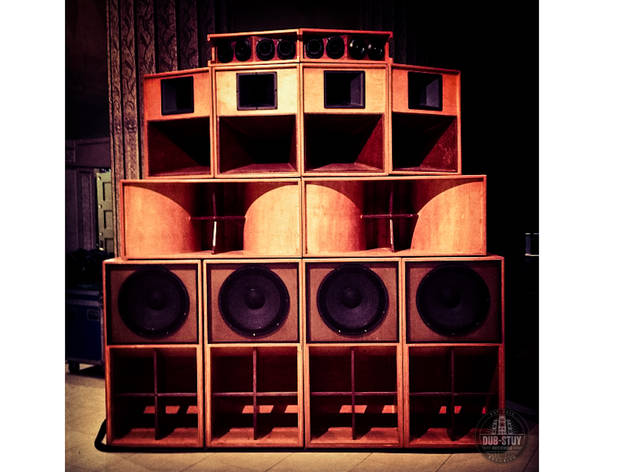

I don't know if you know that music scene, but in dub and rootsdub parties are organised with big stacks of boxes tuned very low (32Hz is the goal) and bassheavy. They use 4 scoop horns (backloaded horns) with 18" drivers for the sub in a 3 till 5 way config and almost everything is custom handbuild, often by the dj crew themselves (see picture for the stack of Dub Stuy (NYC) for an example). A single stack is mostly 12-16kW and medium throw, wich is perfect for parties from 100 to 5000ppl (if you put a few stacks in the space). But for a small bar or party space (50-100ppl) this is way to powerfull, big and annoying for the neighbours because ofthe medium throw of the subs.
I know a lot of people in that scene here in Belgium and with some of them we discussed to make a smaller stack for bar gigs. I think a tapped horn would be best for this, but i can't find a fit design for this (also because my hornresp skill are very minimal, i'm a winisd guy for designing). The size may not be too big (the size of a standard scoop would be perfect) so an otthorn is out of the question. And other designs that are smaller that i see are tuned to high (35 till 40Hz). Is this possible to make a TH of arround 100dB on 1w/1m tuned to 32Hz or lower, about 800-1500w of power and of the size of a standard scoop (65cm wide, 120cm high and 80cm deep). Are there existing designs that are free to use (or cheap) and fit this conditions? And this preferable with a driver (or drivers) of less than 500€ for each box.

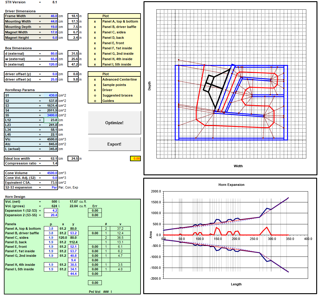

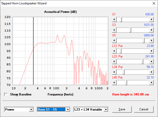

32 Hz 100+dB TH using the B&C 18TBX100 (published specs). Box size is the "standard" scoop horn as previously mentioned. I doubled up on the thickness of the top and bottom panels and the driver baffle. Required bracing is not displayed in the image.
So yes, it's possible.

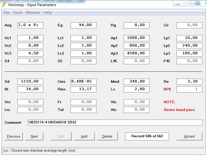

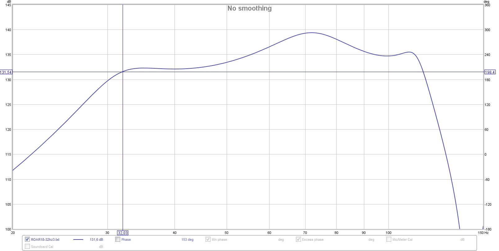

A slightly enlarged ROAR18 with a B&C 18DS115-4 can produce 131 dB @ 32 Hz 2,0 Pi with 2200 watts of power.
It will have a very powerful tactile reproduction of bass and a great midbass impact and punch, perfect for dub and reggae.
A friend tested playing bass guitar on my ROAR12 and it was to powerful for his needs (up to 100 persons in small indoor venues). He really loved the sound, the attack and crisp high definition, but it was to physically overwhelming for his needs.
I missed this part so my proposed ROAR18 is out of the question (it is huge!!)
