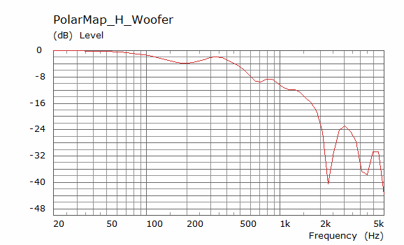

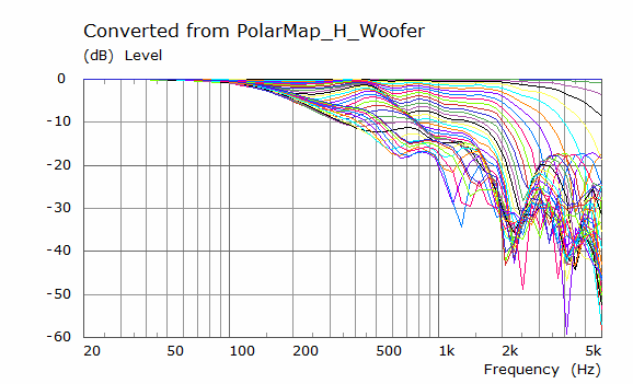

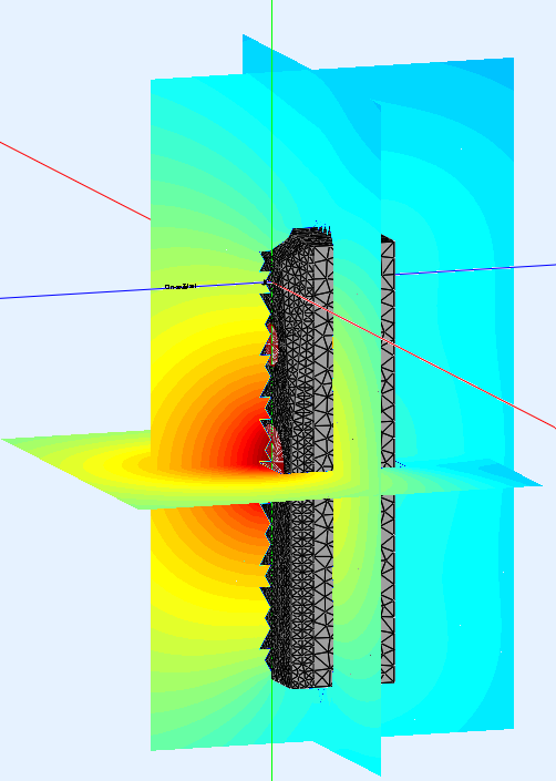

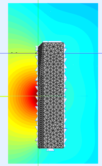

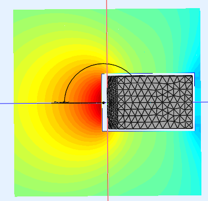

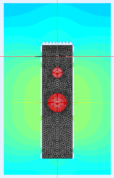

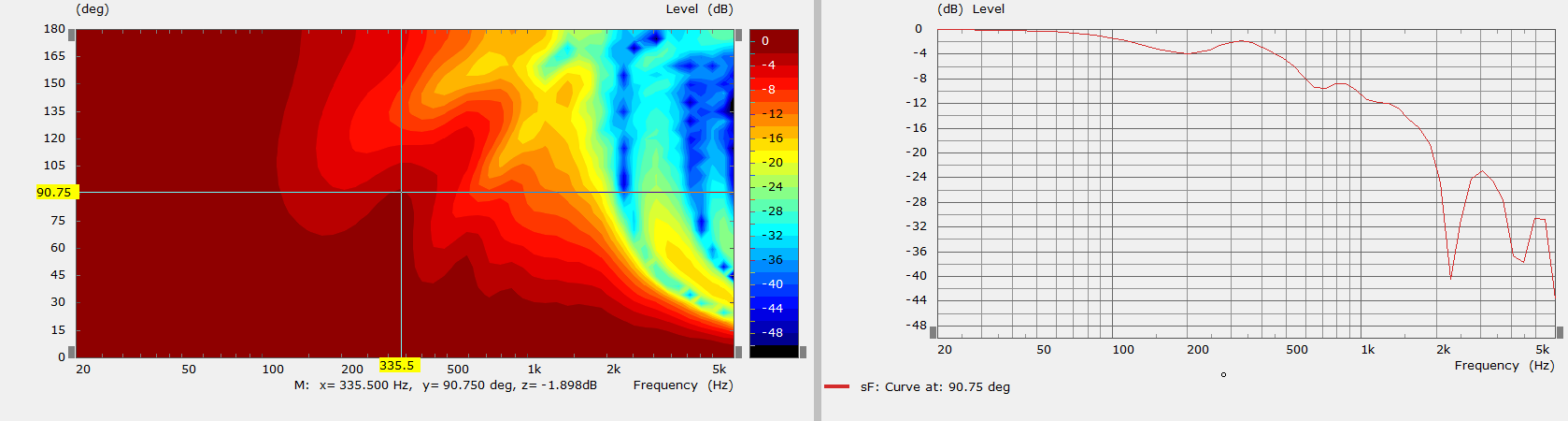

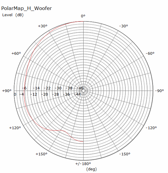

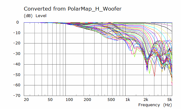

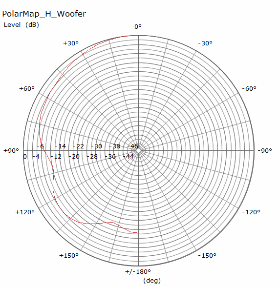

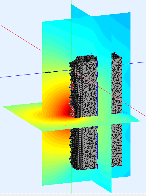

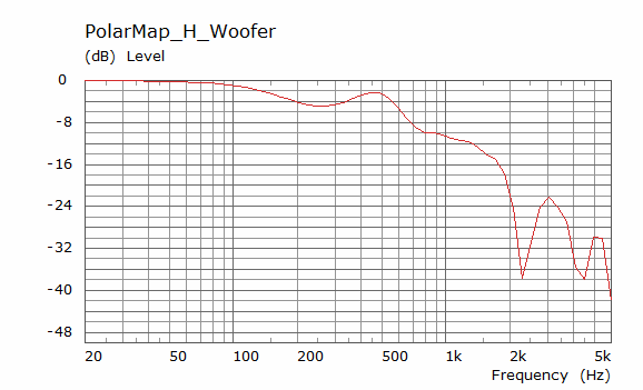

You are looking at the shape of the directivity and the relative intensity of the sound shown by colour from hot to cold, red to blue, high to low.
There are three planes drawn one through the woofer which can be seen from the top down and two others through the centre splitting the speaker in half and a plane through the center of the cabinet going up.
Where the shape expands out shows the shape of the lobe and how even that is. The nulls forming on the back corners of the cabinet are where there is negative interaction which is shaping the directivity at far off axis angles.

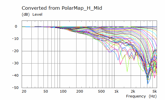

Ok.. I am just trying to understand here. So ideally we want that beam to be more even, in general, for all frequencies (at least for > 300Hz). We don't want the nulls and peaks to form. Nulls may not have been formed at this frequency if the height was more and depth was more. Basically, the dimensions should have been able to control control/shape the beam more.
In an ideal case, if the shape of the cabinet was a big sphere with diameter equal to cabinet height or an ellipsoid, would the radiation have had more evenness?
Fluid, could you post a different-depth version of the same cabinet for comparison? That should make the interaction between box depth & baffle step more obvious.
Even or smoothly changing is best. Peaks and dips are not ideal if they can be avoided. To EQ away an off axis peak you end up putting a dip in the on axis response. Avoiding it by acoustic design or crossing before it becomes a problem are decent solutions.Ok.. I am just trying to understand here. So ideally we want that beam to be more even, in general, for all frequencies (at least for > 300Hz). We don't want the nulls and peaks to form. Nulls may not have been formed at this frequency if the height was more and depth was more. Basically, the dimensions should have been able to control control/shape the beam more.
Have a look here and the pages after at some simulations I ran on an ellipsoidal cabinet and my own fairly rectangular one. Even the addition of a 6mm chamfer on the front of the driver had a significant effect when combined.

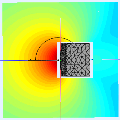

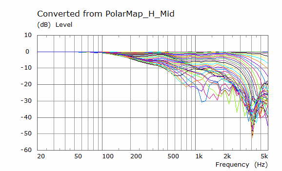

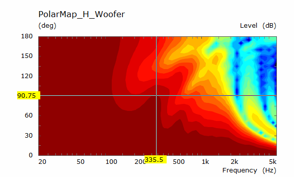

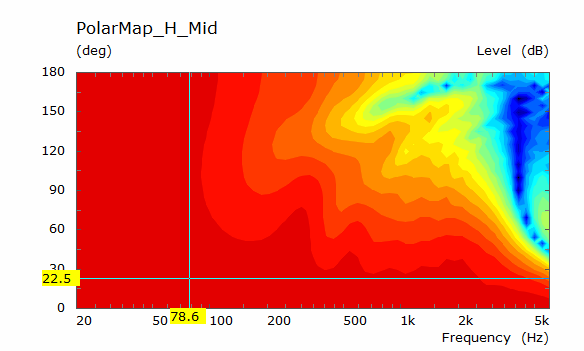

When I looked at the Horizontal directivity of the woofer next to it's response at different angles it became clear that the peaks seen are really formed by two nulls intruding either side. The effect is seen strongly at 90 degrees and looks just like edge and baffle diffraction. I think the 180 degree view and looking at a compressed frequency graph was throwing me off. The way the cabinet is now there is no edge treatment where the woofer is. I will run some other simulations to see if that has much effect at these frequencies as I was not expecting it to seem so pronounced. The observation fields show that there is no positive reinforcement just off axis nulls.

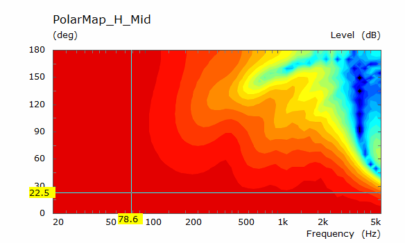

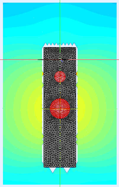

Here are the results and observation fields for the 200mm deep version

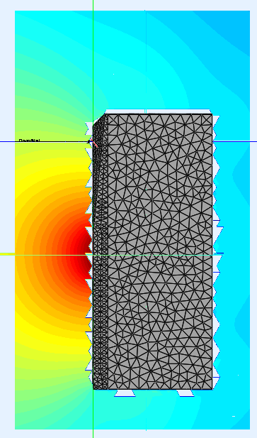

400mm deep, I need to look at these for a bit longer before I making any comment on what I think I am seeing. I decided against running the 100mm version as it seemed impractical, solving and preparing graphs eats time which could be better spent elsewhere.

This is really interesting... I am just trying to write down what I understood looking at the plots based on my limited knowledge.
As you said earlier, this looks like diffraction is happening at low enough wavelengths. As we can see trends like peaks changing to nulls when the depth is doubled at a given frequency (for example around 350 Hz), it looks like a comb filtering is happening, with the varying depth, in turn, varying the delay that forms a part of the comb filter.
I am thinking it is the edges of the box at the back side and the top that is causing the main issues (abrupt change in acoustic impedance as the wave transitions suddenly from material of the box into free space, which is causing secondary waves to propagate from there and interfere with the waves produced by the driver at the off axis angles we are seeing main issues. As you had pointed out in an earlier post, there is definitely a vertical component involved as well, whose influence could be more visible in a vertical polar, I think.

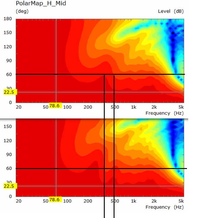

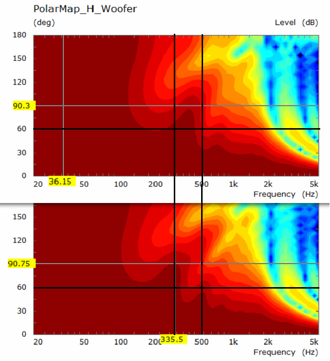

I have attached comparison plots of the midrange (Pic-1) and woofer (Pic-2) with this post. Top figure in each case is the 200mm depth and bottom one corresponds to the 400mm depth. The effect of a peak changing into a null-type of phenomenon is clearly visible in the polars of the mid driver. I think, since, in the mid driver's case, the effect of horizontal plane might be more significantly seen in these horizontal polars (as it is closer vertically to our observation point), the change in depth and the resulting discontinuity at the edge (at the back) is causing the major issue below the 500Hz range.
Another thing I am seeing is as the depth increases, the location of the main peaks are moving lower in frequency, which could be better for the mid, if we could smooth out the secondary peaks that come higher in frequency. It could also help the woofer somewhat, if we can smoothen the main peak.

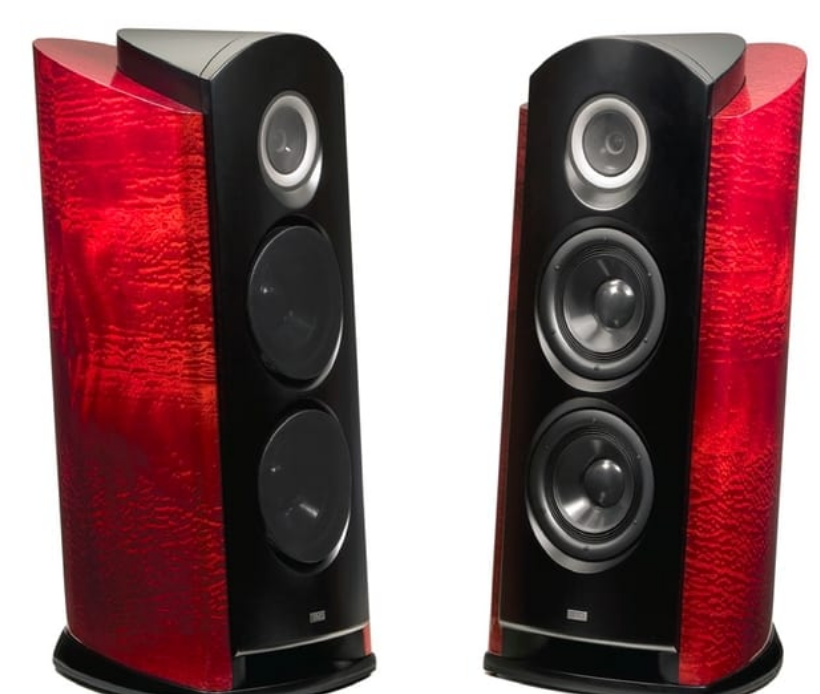

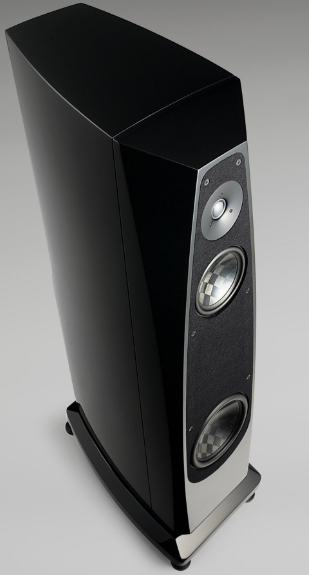

Based on all this, I am thinking that instead of the really boxy shape I have, if I had smoother transitions/round overs/chamfers at all edges (back, top, everywhere possible), the difference in amplitudes of these peaks and dips might smooth out (I am thinking that is why revel M16 type or more "ellipsoidal" type enclosures that you had linked to in the other thread would be better instead of the rectangular box). I don't know if the edge treatment around the baffle would help with the woofer radiation at this lower in frequency, but it is definitely good to have smoother transitions everywhere, I think.. 😀
I am attaching some pics of the kind of cabinet shapes that might help us smooth out the peaks and dips. Even if all of these shapes may not be DIYable for me, at least if the hypothesis is correct, we might be be able to get better graphs with these kind of shapes/simplified versions of them I think.. 😀 😀

To my less experienced eyes, it seems like comb filtering at large off axis angles, caused by reflections/diffraction. 🙂

I agree with you particularly when the design is wide directivity in the mid and woofer. Avoiding the response shape seen in these sims won't come from a depth change alone.I was just thinking that the overall cabinet shape might help in smoothening the responses, if the shape is more rounded like, irrespective of the depth. Similar to how we take care in shaping the baffle, we may get better results by shaping the whole cabinet in 3D to smoothen out the acoustic impedance changes from cabinet to free space.
The word comb is usually used when there are lots of strong dips from cancellation close together as it resembles the fingers of a comb, but the mechanism that causes it is similar.To my less experienced eyes, it seems like comb filtering at large off axis angles, caused by reflections/diffraction. 🙂
At first glance that seems to be true but there are some more subtle aspects that are harder to spot that I made some graphs of below.To me it seems that the difference between the 200 mm and 400 mm deep simulations are rather subtle. The frequency of the first peak/null is moved a bit, but the magnitude is not really affected. I cannot say which one I would prefer.
Yes it is. I would argue that it can make sense to avoid a problem acoustically through design, particularly if to fix it electronically is hard.The entire region from 100 Hz to 400 Hz is going to be highly influenced by room boundaries, yes? I would think that the placement of the speakers and the position of the listener will be much more dominant than the diffraction effects off of the back of the cabinet.
This is all make believe and exploratory in simulation but in some practical cases your comment would be totally valid. This design was started as sealed and DSP and in that case alignments are irrelevant, as pointed out by krivium there are ways around that if the benefit was worth it. In this case I don't think it is.I am not disputing that the cabinet depth will have some effect. But I am questioning whether a parameter as important as cabinet depth should be controlled by this effect. In this hypothetical case, going from 200 mm to 400 mm depth basically means nearly doubling the internal volume of the speaker, completely redesigning the bass alignment, probably using a different woofer(s).
Here is my speculation/perspective. The more I look at it the less I like the 400mm deep version. There might be situations where a 400mm deep cabinet works with a narrower or wider baffle but I don't think it helps here. The 200mm version is smoother overall with less of a peak dip interaction.However, this is all my speculation and I will wait for fluid's perspective about this.
There is something interesting that occurs in the frequency range where the "eye" of the furthest off axis null occurs.
In the 200mm case this creates a nice super cardioid ish response around 600 to 700 Hz with 14dB or rear cancellation and even more around 150 degrees.
In the 400mm case this is a lumpy double null version of it

I think you might have left a zero off 😉 FYI the 200mm is from the rear edge of the baffle you drew to the rear edge of the cabinet.I will try to go with a close to 20mm ish deep cabinet for this project I think.
Of the images of nice speakers you posted the Rockport is the only one to work with your current drivers although the TAD EVO is very slick. If you hold off a little longer I can try some different angles of facets and edge treatment around the woofer. These may combine to relieve some of the lumpiness. The Rockport has much more accute looking chamfers which can act like a larger round over.
The bigger the volume the less power is needed to drive the woofer, the Q and response can be shaped by DSP to be whatever you choose within limits of the driver.After thinking a lot I think I will go for a sealed cabinet alignment with this project. Anyway there is DSP. I can also always add a good subwoofer later if required. The Satori WO24P-8 driver gives a Qtc=0.707 sealed alignment with around 35L internal volume, which looks nice. Some people also suggest higher volumes like 50L sealed for this driver for better response. I will work out and finalize more details now.
