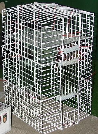

I once read a comment by John Broskie: the perfect and the complex are enemy of the built. I sure make myself guilty, always thinking of 'improvements' even before building the device...that's what led me to think about the borg collective but it has voltages exposed, it is big, and so on. So now I am working on a rack which I will protect with a cage (shown as attached picture). I bought Morgan Jones Building valve amplifiers to see if I can apply some more theory on this project.

That parakeet would make or cat even more interested in the contents of the cage 😀
I will make a small one for the preamp duties. The power amp's will be hidden behind the speakers - which you guess, are also big. Yes, my girlfriend loves me!!
