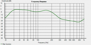

I had a look at the difference between the non-filtered and the crossover + EQ curves of the bass horn. From what we see there, I derived the filter function needed to get the flat (in band) response needed, using attenuation only. See below.
If that attenuation EQ/crossover is applied to the response of the woofer in horn, there is a resulting bandwidth attenuation of ~3.5dB on pink noise. I.E., if pink noise were measured and averaged with no crossover or EQ, it would be about 3.5dB higher than with crossovers and EQ. That's not as much attenuation as I figured.
Don't know absolute levels, tho.
Martagon equalizing and sensitivity issues
Dear Pano and All,
thanks for estimating the equalizing filter(s) needed to cause the LF horns to give flat response.
You can start from the AJHorn simulation, or from the 'raw' measurements that incorporate panel-absorption and damping/stuffing materials.
To my opinion, the AJHorn simulation and 'raw' measurement are very much alike.
Also, Pano's equalizing and my equalizin by ONLY attenuation only differ 0.5 dB (in size).
So indeed, a well designed truncated horn requires only minimal attenuation of some 3 - 4 dB and low Q (to avoid extra filter-ringing.

I forgot to mention (= advanced class, lol) that via AJHorn I build acoustic notch-filters in the cabinet to damp the residual oscilations in the 'raw' response.
* The SuperSize' has 2 notch-chambers (at 105 Hz and 150 Hz),
* The FullSize has 1 (at 133 with Hz, 1.25 ltr, tube surface 2.27 cm**2, length 2.3 cm).
All 3 acoustic notch filters have mild stuffing to reduce the Q-factor related to 'notch'.
Below is the effect of the FullSize:
* Black: stuffed but without acoustic notch; peak at 135 Hz is in pass-band.
* Red: acoustic notch at 133 Hz with no stuffing
* Green: with stuffing

How measure speaker sensitivity on an active EQ sys
Easy...(?).
A DSP EQ emulates physical filters (only). My amps are external, so gain up/down to 2.83 Volt at the speaker's connecors and measure SPL at 1 mtr..?
Of course you have to define the bandwidth limitation and tune over this range or use filtered noise.
Is this too obvious or do I miss something here?
With digital filters there is no loss due to physical filter components so in general you will meaure higher SPL

Sensitivity EQ-ed speakers...
Silly me, you were absolutely right Pano to pose this question,
it is not so obvious....!
However, if you would
* measure the mean SPL after EQ in a given bandwidth, e.g. 104 dB
at 2.83 mean Volt connector excitation
* and then determine the mean (frequency-weighted) gain of the EQ filer(s) over this bandwidth (e.g. -2.7 dB)
-->> then,
the EQ corrected SPL/Sensitivity for the 'raw' would be 101.3 in this example.

From the data published all I could do was determine the response of the woofer in the horn, and the response of the woofer after crossovers and EQ.
That gave me two filters.
- The woofer in the horn
- The woofer in the horn with EQ+Crossover.
- Filter 1 was applied to pink noise, to simulate the woofer horn response
- The filtered pink noise was analyzed for its RMS value. That's the baseline
- The baseline pink was filtered with filter 2, the EQ/crossover function
- Pink noise analyzed again and difference noted as -3.5dB. Brownian noise gave a difference of -3dB
What I don't know is the SPL of the woofer+horn with no external EQ. If the peak at 90dB is a known SPL, then gain could be calculated. The Eighteen Sound 15" woofer is nominally 96dB/Watt on an IEC baffle. Obviously, the horn gain is not flat across the woofer bandwidth, tho not all that bad.
