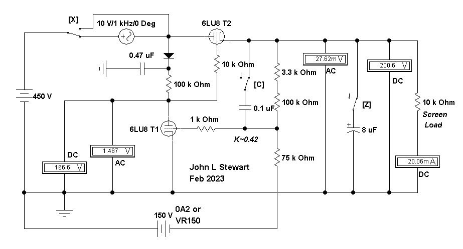

A 200V PS for use with TV Horizontal Sweep Tubes
For fans of the 6LU8 here is the G2 Reg using one. But this time with a -150V Reference.
Easy to do with the glow of an 0A2 or VR150. Negative Supply derived from the regular CT HV PT.
The dynamic resistance of these gas tubes is ~1K, A simple RC network will get to -150V
with say 10 mA from the neg HV.

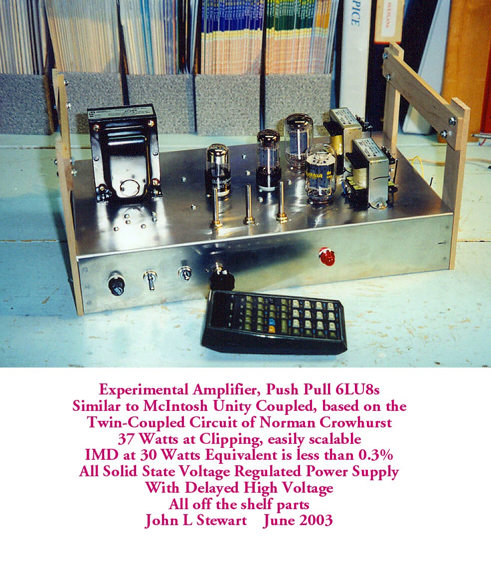

I built a clone of Norman Crowhurst's Twin Coupled Amp using PP 6LU8s about 20 yrs ago.
The circuit is a Poor Man's McIntosh, Unity Coupling. An easy 30W, all off the shelf parts.
The PS on that one is all SS with slow run up of the HV. And no boutique parts crap at all. 👍

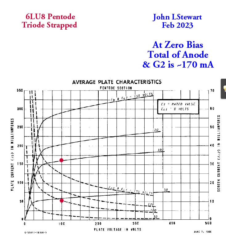

That regulator could be used as less B+. Say, 300 would probably be safe - the Hohner amps in the other thread were being run way north of 300.
If you started out with 300 and regulated to 200 you‘d be limited to 150mA (Peak). That’s just all you get at 100V plate and screen. For even lower voltage differentials you need those high perveance triodes (and live with the low gain). At 50 volts plate to cathode, that 6EM7 beats the 6LU8 by almost a factor of two on current.

Yes, I realize the “information is in the data sheets”. So, I could design my own G2 regulator. But since you have done it I don’t have to.
It seems like a reasonable question to ask - what current your 200V regulator in #21 could supply. The schematic (#21) shows 20 ma flowing through a 10k screen load. I will need more than 20 ma for a screen regulator, hence my question.

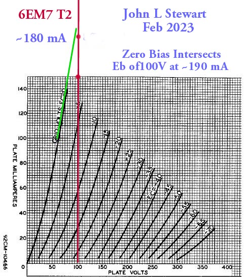

Some good points there. But digging deeper we find this in the attachments, not even close to 2:1 regards to peak current at 100V on the plate.
In the Sim cct the results for each version are very close to each other.. And we don't run music amplifiers full out for extended periods. Except guitar pickers. The 6LU8 family, 6LR8 & so on can dissipate 15W while the 6EA7 manages 11W, Take your pick.
Forward voltage drop about the same as the EM7. Both are more than LU8 at only 50 volts. At 150+ that LU8 eats everybody else for breakfast. With only 50 volts of drop, the dissipation will be under 7 watts - shouldn’t be an issue unless you drop it out of regulation.
EM7 has nicer looking linear amplifier curves.

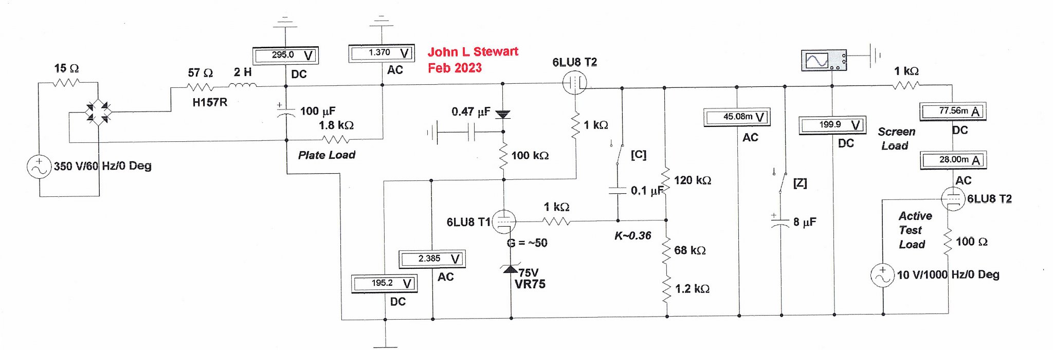

Here is one of many possible solutions for the PP 6CW5 Amps. I'll leave it to others to select a proper PT.
The G2 regulator has an internal impedance of 1.61R ( 45,08 mV / 28 mA ), at 77 mA load, read it off the AC ripple meters.
Not long after the Earth cooled ordinary people were solving these kinds of problems with nothing more than
pencil, paper & slide rule. They got the required toob data straight off the respective data sheets. Just like others do today.
Something anyone can do with the help of a simple 4-function calculator, no logarithm etc to get in the way.👍
