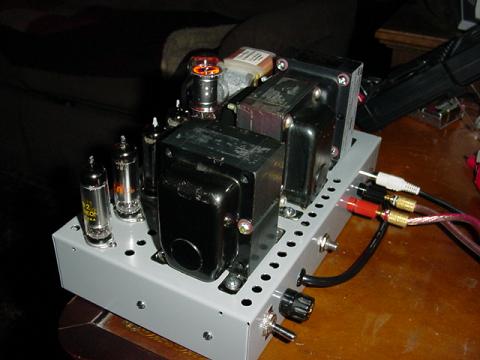

it works!
Finished the amp tonight, and... it worked - right off the bat. The gas tubes all fire, and the voltages are all extremely close to my estimates. I got 71v on the plate of the nuvistor, and a B+ at the output transformer of 245v. I ended up changing the last gas tube to an 0A3 type, because the primary of the phase inverter has a much lower DCR than I thought - 350 ohms. The resistor before the 0A3 must also change to a 6k-10w as well.
Speaking of the nuvistor, I have no oscillations, and no microphonics...
It sounds pretty good so far too. It's hard to tell in mono, but I don't hear anything bad so far other than a slight amount of residual 120Hz hum - but not an objectional amount. I'll have to track it down in the tweak stage of the project.
Anyway, I'll hook it up to the scope tomorrow and get some specs. Here are some pics in the meantime. I went for the industrial, 60's, Heathkit sort of look.
