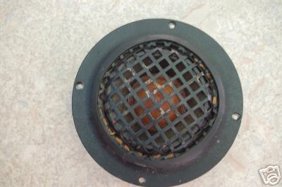

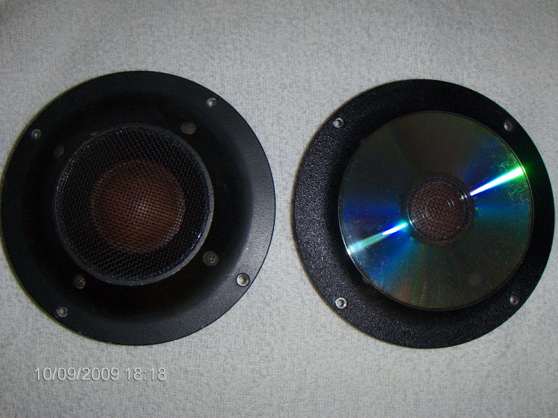

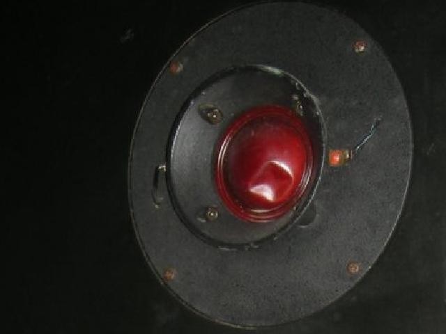

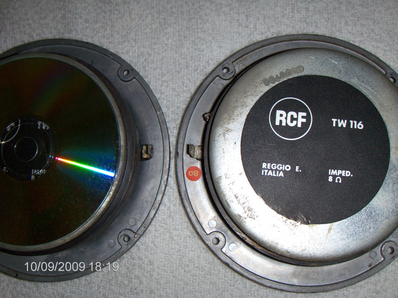

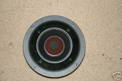

more pics of RCF's TW116 and it's a predecessor
I still want to know presently available model with that efficiency and sonic character (or a TW-116 successor like used by the German manufacturer "Glockenklang")
about

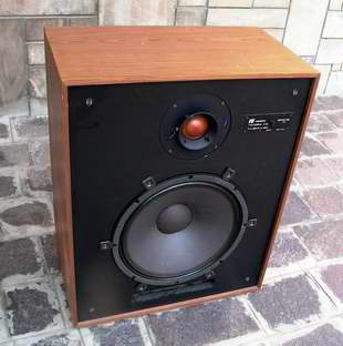

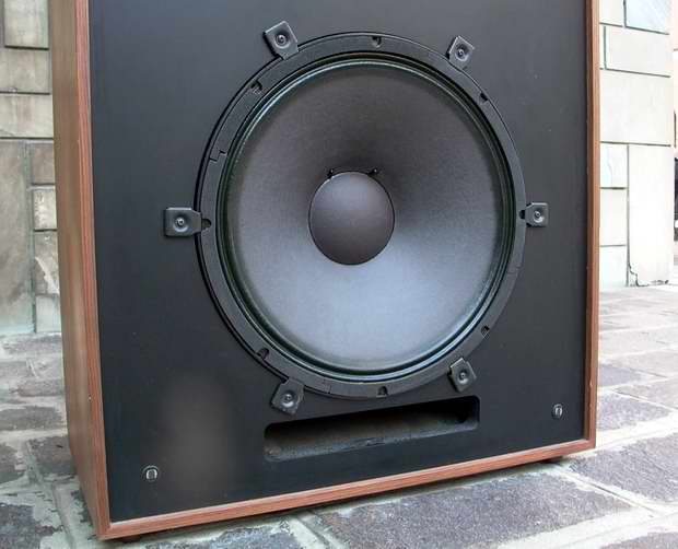

http://www.audiocostruzioni.com/r_s/diffusori/diffusori-2/rcf-br110/rcf-br110.htm
you will find an vintage two-way RSF loudspeaker (BR-110) used the predecessor of RCF's TW-116

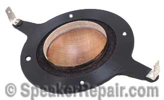

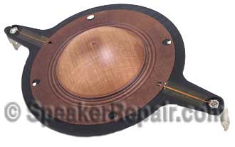

So what you are really after is a compression driver.. 😉
+1🙂
If you need that kind of sensitivity, you're probobly crossing to a larger dia driver of the pro type, and will require a lowish XO point.....where conventional domes don't play well and ribbons don't even get invited to the party. Todays non-metallic diaphram CD's when mated to the right waveguide outperform domes in every measurable category.......except for the elusive HOM which has yet to be identified with any level of certainty other than hig end audiophoolery.
The tweeter he is striving to emulate is a compression driver.
Basically it's a modified, (vc termination toward the "front"), phenolic diaphragm compression driver operated from the rear, and obviously without the rear chamber.
The bastanis he has linked to (with pictures), are compression drivers operated with the normal forward compression exit (and NO horn/waveguide), and the rear chamber removed (..operating in Dipole).

B&C speaker have still no metal diapharms for their HF drivers:
1) DE-5
B&C SPEAKERS
2) DE 250
B&C SPEAKERS
http://www.parts-express.com/images/item_standard/294-633_s.jpg
B&C MMDDE2508M Diaphragm For DE250-8
3) DE160
B&C SPEAKERS
http://i45.tinypic.com/2n1wf8g.jpg
4) DE12
B&C SPEAKERS
5) DE120
B&C SPEAKERS
6) DE10
B&C SPEAKERS
B&C MMD10-8 Diaphragm For DE10-8 294-628
