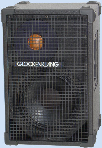

This cannot be true. The Athom SD28ND04RD delivers more than 98 db as you can find by reading the complete thread.95db/1Wmtr better ones doesn't exist with out horn.
Also Glockenklang say's regarded the "Bass Art Classic MkII" follow:
We improved the Bass Art cab with lower weight and better low-end again. It features a 2" dome-tweeter and a 15" heavy-duty RCF bass-chassis. It is a most natural and detailed sounding cab with a good sensitivity of 99 dB. Best combination with Bass Art Classic head.
for reading more go to
GLOCKENKLANG
(Products-BassSystems-BassLine - BassArtClassic)
This fact was the reason to start this thread to find more brands. Another possibility is an own creating of such a tweeter (i. e. diy - combination of a phenol recone kit and a magnet compression driver for horn systems) as you can read about
Bastanis DIY Forum

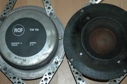

Here some additional image URLs
Glockenklang high SPL tweeter:
http://www.kurosawagakki.com/img/itemimages/0427/L/img1_42782.jpg
http://www.j-guitar.com/sp/sea/data/1867/r/1520_2.jpg
this tweeter is based on the RCF TW 116
http://img.2dehands.be/f/normal/41875500-tweeter-rcf-tw-116.jpg
http://images.okazii.ro/auctions/2009/05/14/238633380-2493453-500_500.jpg
Image from auction
2 bucati difuzoare inalte RCF - TW 116 - Okazii (22454938)

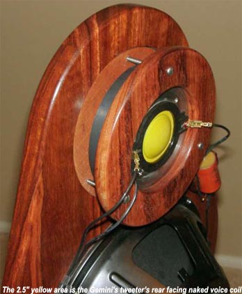

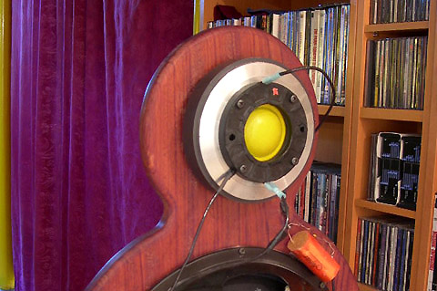

I am sorry that article doesn't say anything to me.
by the last picture about
6moons audio reviews: Bastanis Prometheus Mk.II
I read follow:
These tweeters are front- hornloaded and supposedly the only such commercial dipole tweeters in the market. They are built for Robert Bastanis in Bulgaria. He modifies their phenolic diaphragms with a mixture of violin lacquers and mineral powder.
By looking to this picture (if URL don't goes open, go to the attachement) I think, a diy dome tweeter for 99db/w/m with help of the horn driver magnet unit and a recone kit as diaphragm so as some additional mechanics must be possible.
Are there threads about this subject?
I read follow:
Bastanis is crossed very high
