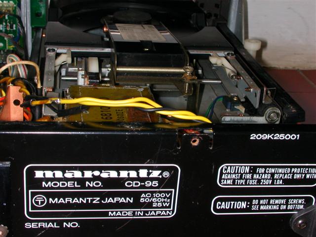

Hi Boki,
The CD94 MKII is the as mine Marantz CD95 made for Japan only -100 volt 50 Hz. Do you have the wiring diagram of this player?
Rgds.
WEMPIE

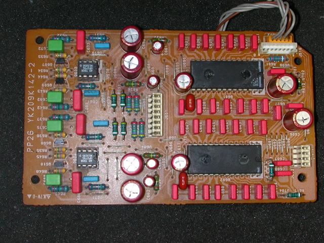

Hi Boky,
Herewith my detail DAC picture. It has 2 x TDA1541A S1 (Single Crown) but the mark has been removed because of glue of heatsink previously fitted. Need your help to send me the wiring of CD94 MKII to my email at wempie@parnaraya.net or wempie.pauned@hotmail.com. My audio hobby homepage at : http:/www.wempiepauned.com
Cheers
Wempie

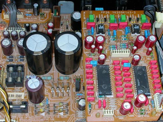

Marantz CD-95 DAC Board
Hi Boky,
Herewith my DAC board attached, the caps are all replaced with Wima and ERO by previuos owner. Can you help me, I need to know the value of the caps arround the OP Amps the 4 square blue caps and another 4 Wima red caps located between the green caps and the blue caps. Those caps was replaced by the previous owner with parallel at the bottom however with (Silver mica) at the bottom to obtain the original value I quess, but paralleling with Silver mica is not correct I quess. The green caps are 5,600 pf and not parallel. As at your DAC board it shows 4 black cylindrical and 8 oval blue caps.
Regards
green caps 5.6nF
red caps 18nF
blue caps 2.4nF
other values (around DAC chips) are readable from my DAC board photo.
I suggest you try polystyrenes 'cause overemphasised mid range....
WIMA polypropylenes are good, but may blow the mid range really too far...
Whatever you choice may be, do not bypass the audio-filter caps.
Good luck,
Boky

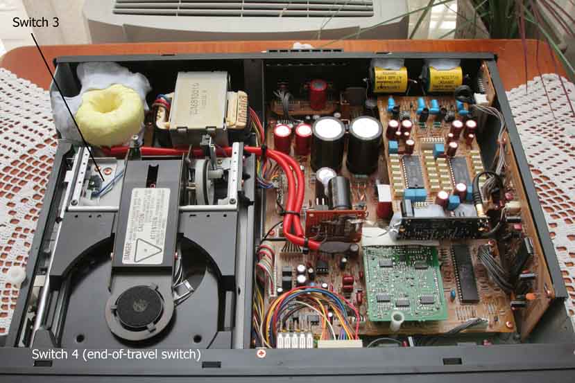

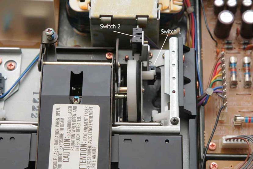

Hi Boky,
I got 3 of the 4 belts 1 ordered. 1 was short-shipped, however, I found a temp belt. After changing the belts, the drive does not open when I press the 'open' button. However, when I press 'close', the tray goes it (ie. after I manually pull it out), but I can hear a soft humming noise. And the disc does not turn. Any suggestion where to look? I checked all the ribbon cables, and they all are plugged in well.
Thanks & Best Regards
S K
skseah said:
Hi Boky,
S K
You have probably replaced the belts with larger ones and you have slipping, and / or you misaligned the switches 1, 2 and 3. Switch 4 is located somewhere underneath of the tray and I do not think that you had to temper with it – so the Switch 4 is probably okay.
Condition for Open function to operate successfully: Switch 3 closed, Switch 4 open (and maybe Switch 1 closed and Switch 2 open, but this is more important for laser to start checking for reflection, and then to start to spin the disk)
Condition for the spindle motor to start spinning the disk: Switch 1 closed, Switch 2 open, laser detected the reflection of the disk.
To replace the clamping belts (2 of them), you HAD to remove the metal plate that holds Switch 1 and Switch 2. However, you did not have to remove Switch 3 and Switch 4 to replace the tray belts (2 of them).
When you press OPEN, Switch 1 opens, Switch 2 closes (this indicates now that the tray can start to open!), Switch 3 opens, and Switch 4 closes. Now, if the Switch 4 is not closed, close function can not start to execute.
When you press CLOSE, Switch 4 will open and Switch 3 will close (this now indicates that the clamping process can start to execute), Switch 2 will open and Switch 1 will close. Now, the laser can check for the presence of the disk, and if YES, the spindle motor will spin the disk.
I expect that you did not position the clamping pulley / wheel that engages Switch 1 and Switch 2 correctly, or you have bad slipping happening so that this wheel can not reach its end position and engage both switches.
Carefully check everything once again and make sure that you:
1. Replaced the belts with SHORTER ones of the same cross-section
2. Positioned Switch 1 and Switch 2 correctly so that they can be engaged.
Good luck,
Boky
