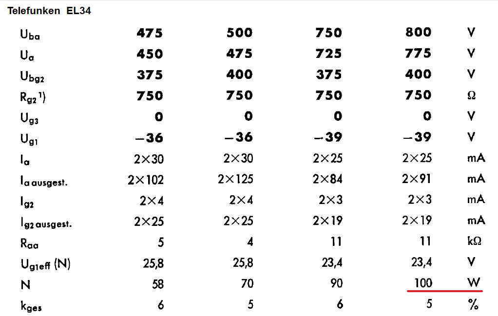

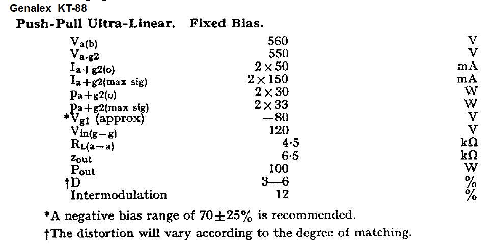

If you choose the right load, screen voltage, and B+, it is easy to get 100W out of a pair. You probably can't bias too hot because you will be working with a pretty high B+, but it is certainly easy to work out the conditions.
And like it was stated above, you could do the same with EL34s; you would just have to bias even colder since you have to respect the max dissipation rating.

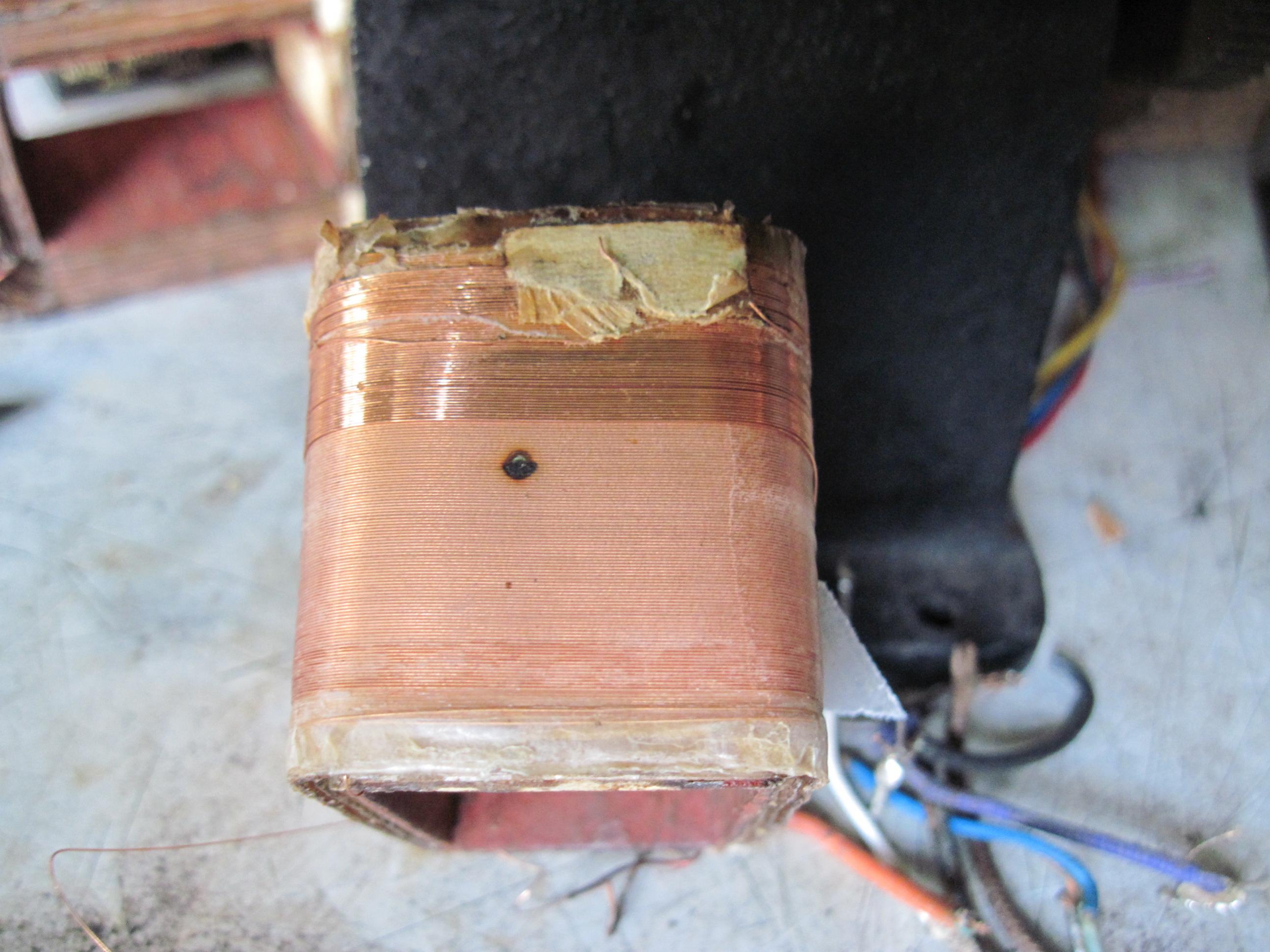

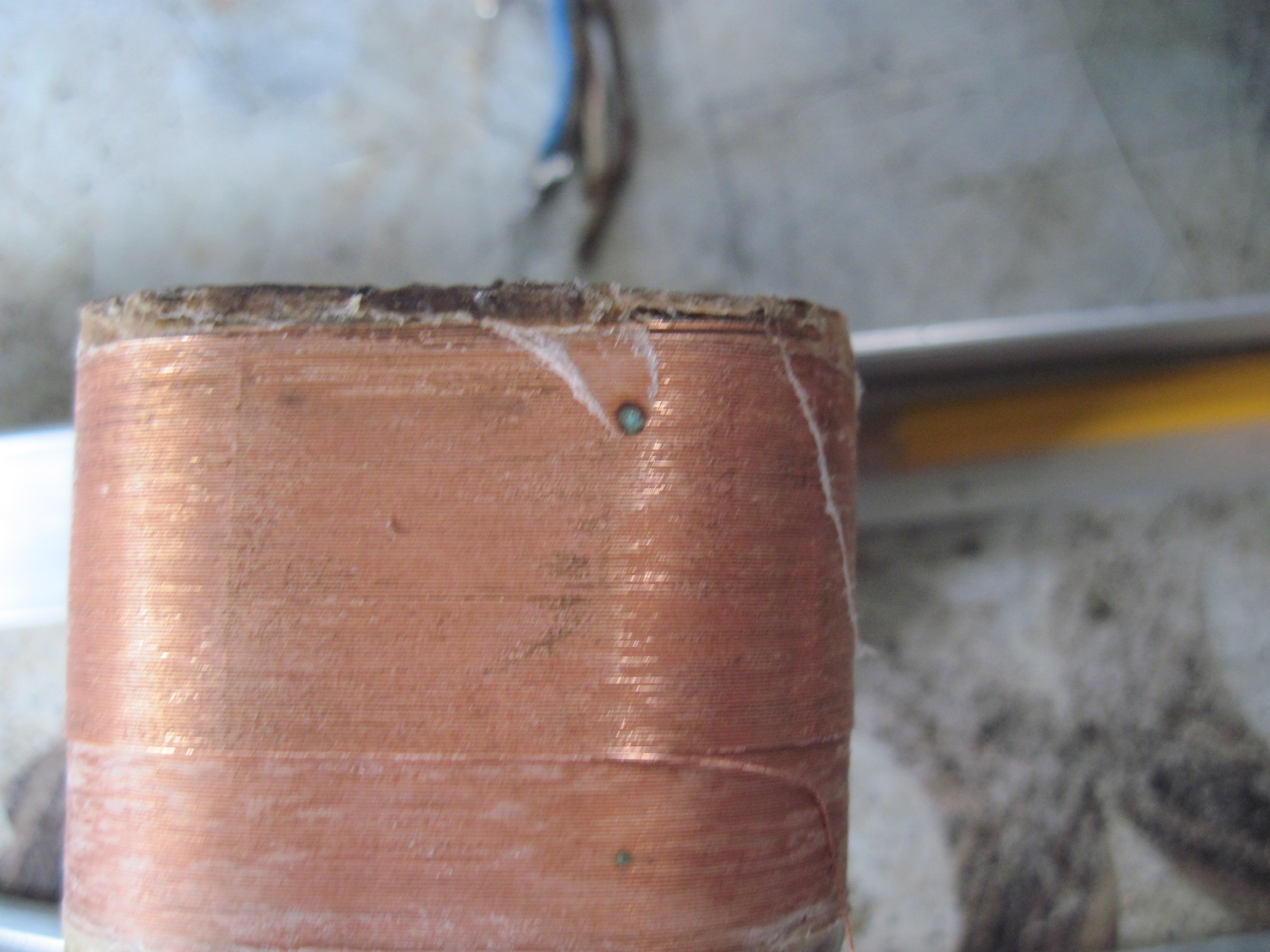

I have seen arc over happen in 3 places in a guitar amp.
The arc is usually between pins 2 and 3 on the base of the tube sockets. Ceramic sockets, even the cheap Chinese ones will live forever (other parts may not), but the common black bakelite old production sockets will eventually carbon track and burn creating a low resistance path frying the rectifier tube, the OPT, and sometimes the power transformer (where the user installed a bigger fuse).
I have seen the arc occur inside the base of the tube between pin 3 (plate) and pin 2 (heater) or the metal base ring on some KT88's. This usually happens on dirty amps used in damp places (outdoors in Florida). An arc will not happen inside the tube if there is a good vacuum inside. It is possible to ionize the "gas" inside a bad tube with excessive plate voltage, but it takes a really BAD tube, and some abuse (see picture).

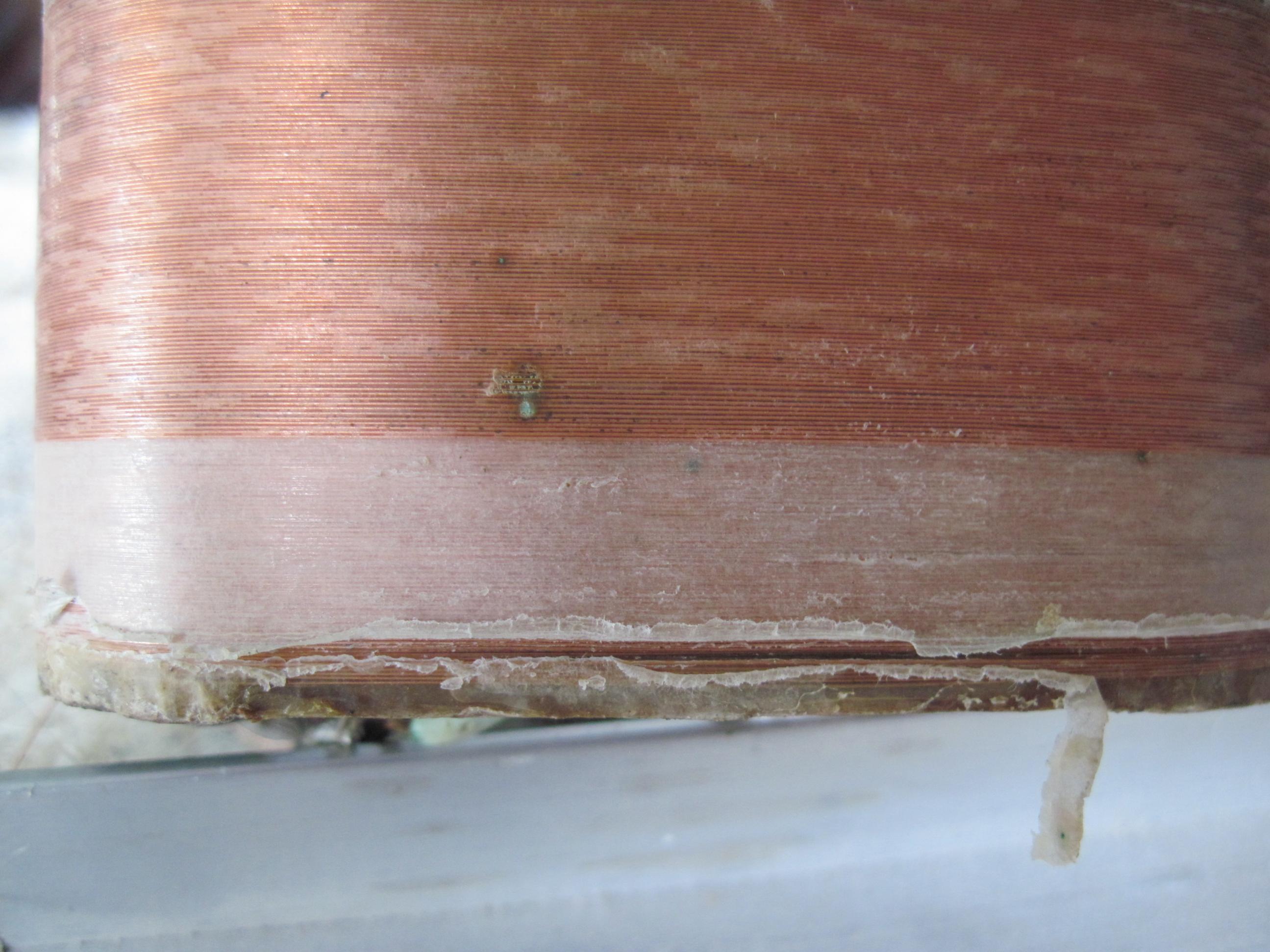

Sometimes the arc occurs INSIDE the OPT. You can't see it, but you will find a fried OPT if you take it apart after replacing it....because its dead.

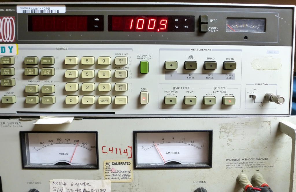

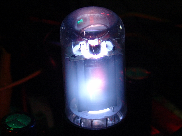

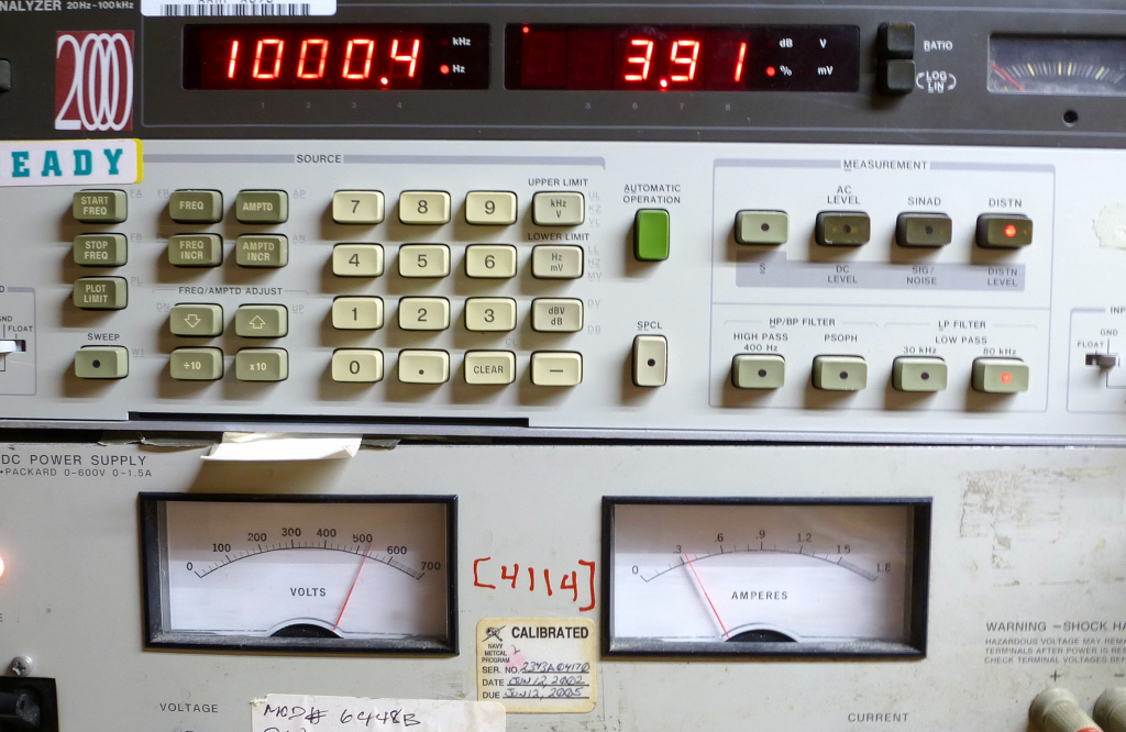

I am finally building a new lab after moving twice in the past two years. I got to do a couple of experiments last month, and one of them involved reviving an old breadboard from about 8 years ago in the 6L6GC in AB2 design thread. I stuck some 20 year old Chinese KT88's into it and cranked them up to 100 watts on 525 volts. I let them run until the load resistor got too hot to touch. The OPT is another of the same paper Schumakers wired for 3300 ohms.
Note the purple glow inside the KT88's is not real. The camera "sees" infrared as purple. The same color can be seen on the heaters of the clear top 6CG7.
See this thread if interested. I tested several tubes with a similar set up back 7 or 8 years ago. This round starts in post #648. I tend to start by repeating old tests with familiar tubes to verify the set up. More will come as I get stuff back together.
