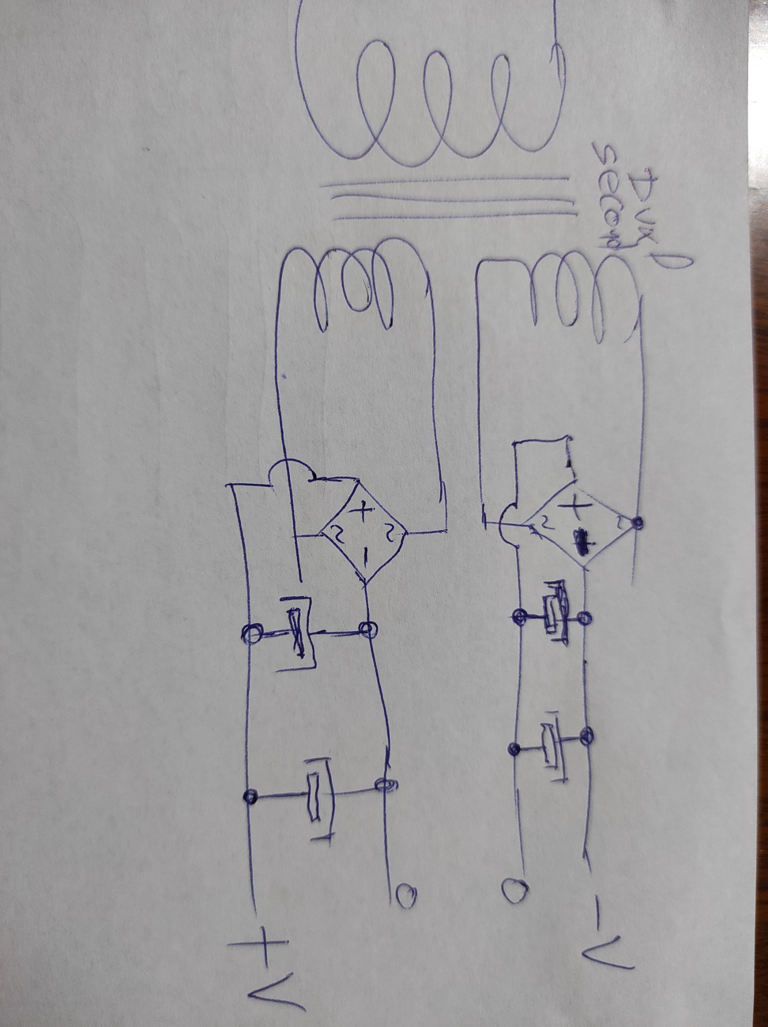

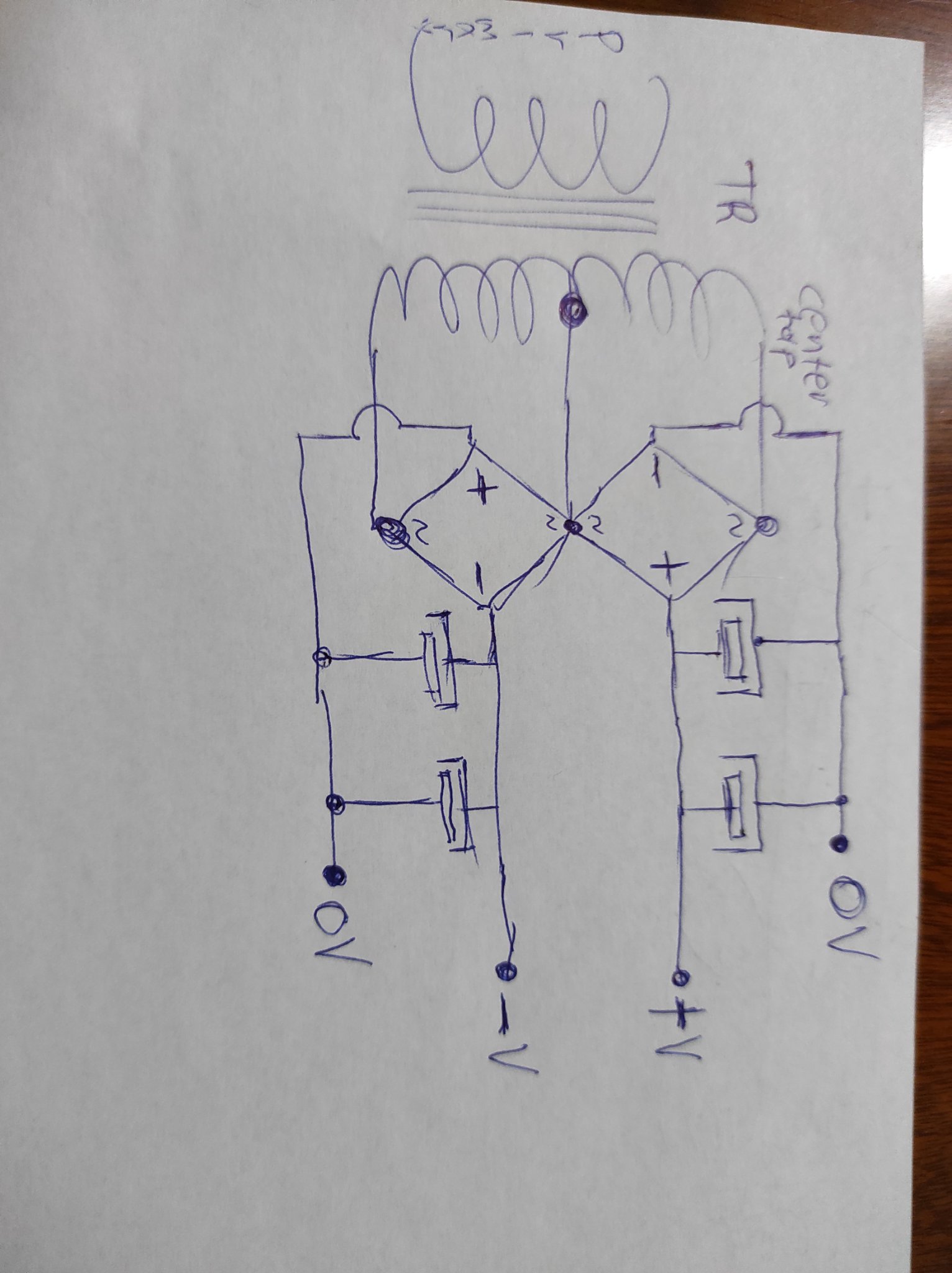

Great. I understand the Dual polarity using Centre tap transformer. I was thinking of the 600va toroid.....but this is doable with what I have. Schematics are easier to understand than an explanation. Thank you.
