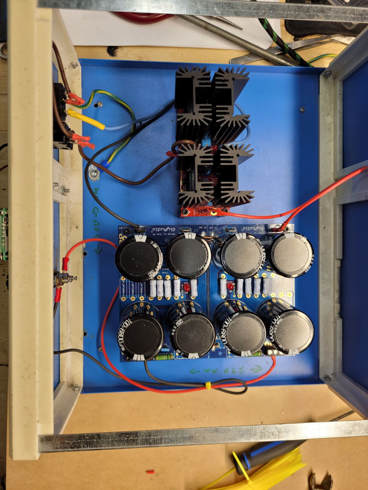

Hi All,
I need a reality check. I came up with an idea of using some spare parts to build a variable DC power supply. I will power the unit with my variac. The bridge rectifier is from Sjöström audio. The filter cap array is from here. The caps are rated for 100v, I will stay well below the 100v. My question, do I have to ground the star ground to the chassis? I will only output v+ and v- to test my boards and the broken power amps I am working on.
This is what I came up with so far.

Most dual supplies connect the two commons together (one for the + and one for the -) to form the system common.
Sometimes this node is left floating, and sometimes not. It is safer to connect it to the IEC safety ground.

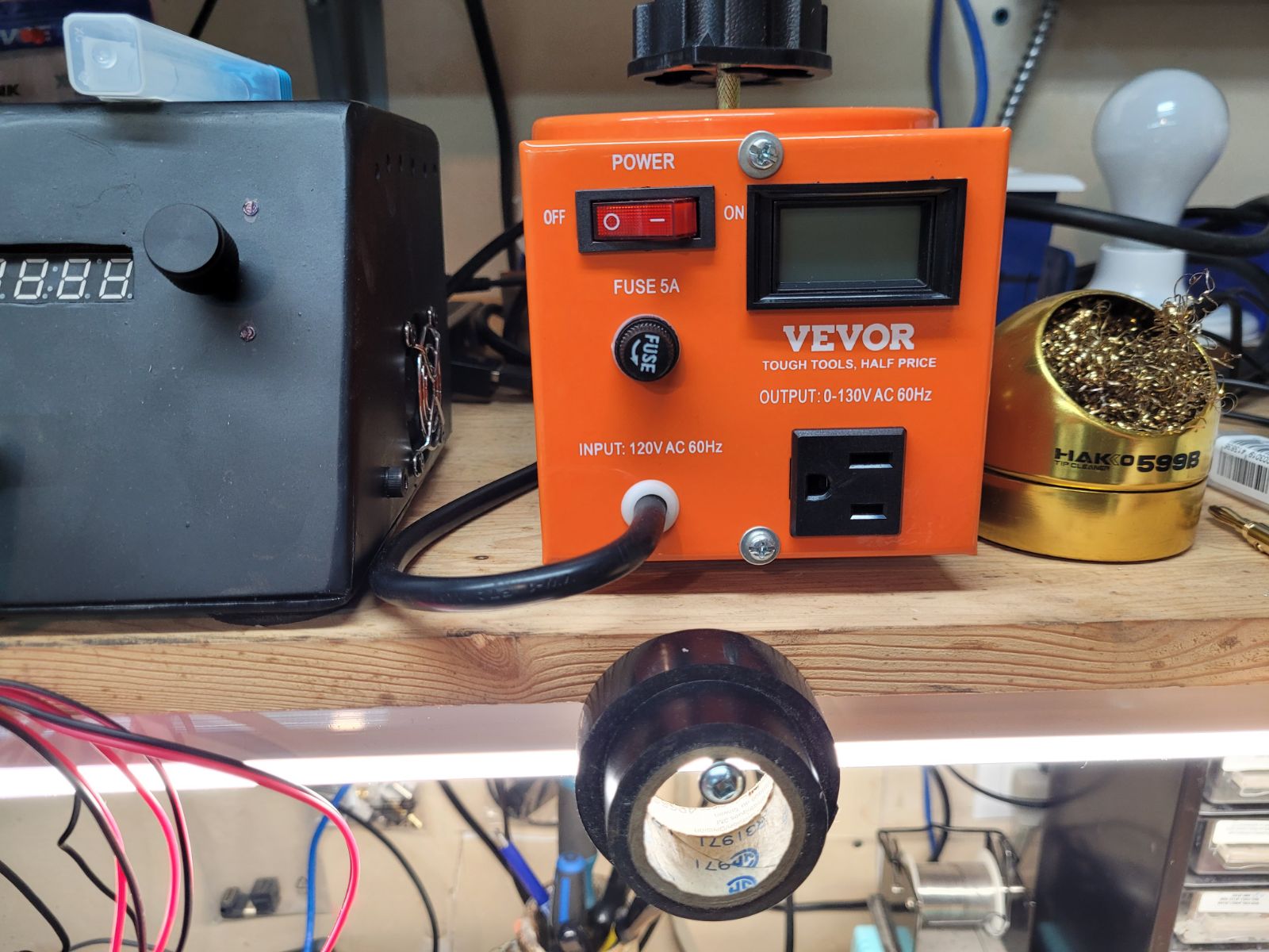

You need an isolation 1:1 transformer before the variac.

You can't make dual polarity power supply without usage of dual output transformer.
Just a suggestion,use a dual secondary transformer, connect the primary coil to the variac output.
Do not touch anything around the primary! Danger 😈.
Use separate rectifiers for each coil secondary,two cap banks, connect the cap bank 0v to the main safety gnd.

Ok, thanks basreflex and thimios. I knew that the variac was not an isolation transformer, but did not realize that I had to lift the entire ground circuit ? Something does not make sense to me. In a toroidal transformer, is the centre tap isolated from the mains?
I don't understand the question ❓
Do you mean the center tap in the secondary?
If you mean this...yes in a 2XX (2x12 or 2x50 or or) toroidal,the center tap is just the common connection of two secondary coils.
This is isolated from the mains.
It is a transformer.
Variac is an autotransformer.

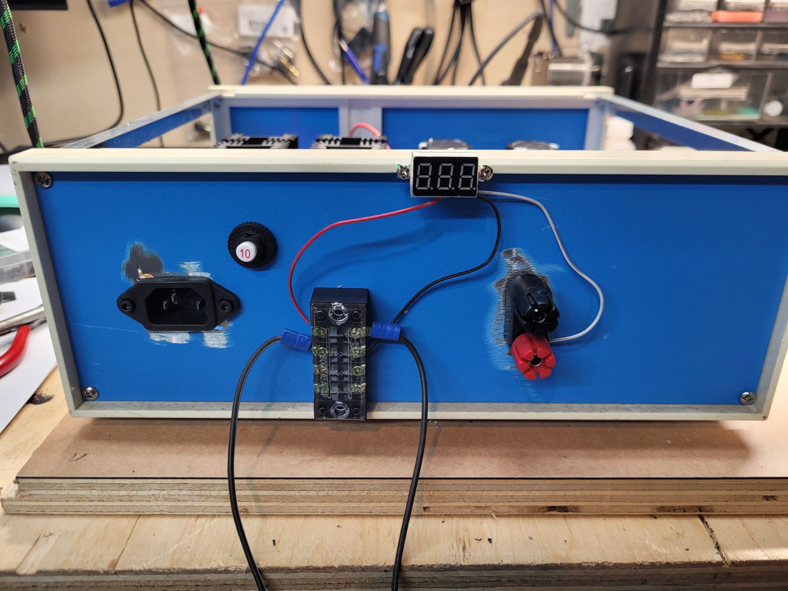

No, I took the V+ and the V- off the filter board. My thinking was to use this power supply to test my solid state amplifier boards, trouble shoot my Carver amp. I was going to bypass the transformer on the Carver and slowly power up.
Any amplifier that it isn't capacitance cabling with speaker need a double polarity power supply.
You need three wires,+/0/-.
You can't use a single secondary transformer to generate a double polarity power supply.
You need double secondary or center tap transformer.
Shoot.... I thought I could use my parts without a purchase of new equipment. Well, back to the drawing board. Looks like I will use the dim bulb tester with my variac, till I come across a proper transformer.
Thank you all for the education.... I appreciate the info.
