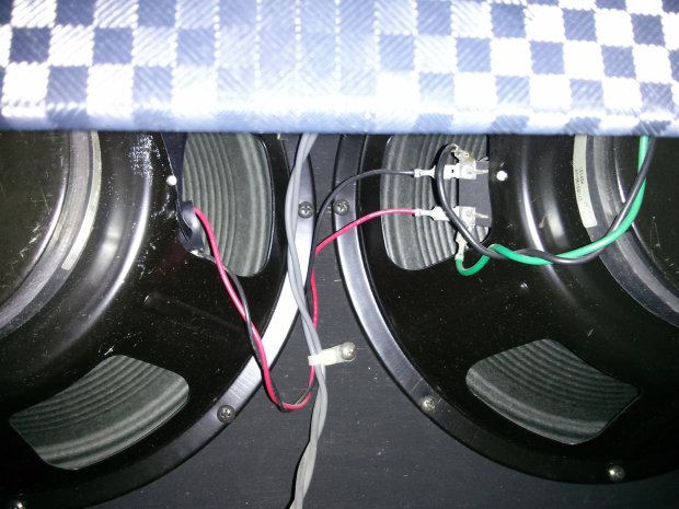

I recently bought a 90's Ampeg Reverberocket R-212R (with 6L6 output tubes) and have a question about the speakers.
They are only labelled as "Ampeg" and provide no wattage or impedance info on the label. What is the wattage and impedance? Are they in series or parallel?
What is an equivalent speaker for replacement if you were replacing just one? What speakers would you recommend for a "jump" blues player? I might buy a new pair if I can find some that are lighter and have that crisp sound that it is now producing. Neodynium?

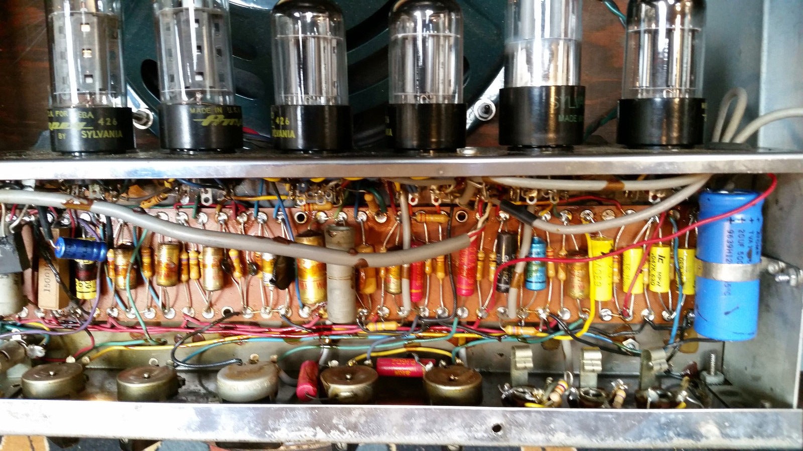

From having serviced these types of guitar amplifier in a past life, your 90's version does, in fact, use 6L6GC output tubes. The original (vintage) rockets had smaller tubes and point-to-point wiring on a tag board. These are the expensive and sought after ones. I'm not sure just when the "reissued" versions began, but yours probably is. That's why the 6L6GCs. And according to pictures on the web, the speakers are in parallel.

Most dual speakers are in parallel so, if one fails, the other carries on, yes?
The speaker "spec" from Ampeg (in my attachment) is for both the R-12R and the R-212R and calls out 8ohm, but I fear that that is for the single-speaker model. I find it hard to imagine that Ampeg uses two different output transformers for the two models, but find it equally hard to imagine they would allow that kind of impedance mismatch too.
My thought is that they might use two parallel 16ohm speakers for the R-212R, but there are no markings on the speakers. Thus, my query -- in the wrong forum section, I am told.

Problem Solved
With a dental mirror and a flashlight, I found a small label on the underside of the magnet. The speakers are 16ohm as suspected.
