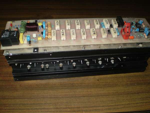

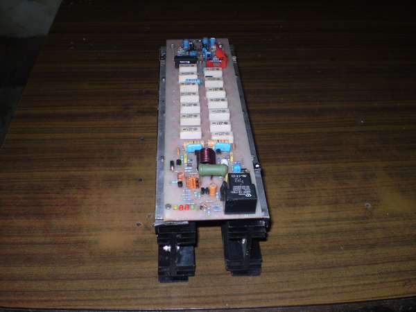

greeting nc normally closed no normally open are both short on pcb
so pcb track has to be cut otherwise in case of fault relay wont cut after making pcb populate dc protector parts after applying 12 volts dc see there is on delay apply 12 volt dc on speaker output see relay energises and red led comes on if this happens your dc protector is working then put all parts so when testing if you have made any mistake in assembling amp it will cut off saving your speakers use 100 watt bulb in SERIES while powering on

thanks andrew lebon for ur explanation.
cheshtap said that two kind of relay can use.so which is good relay?
what is the ampere of the relay and voltage?

greetings work in progress tell you result today
