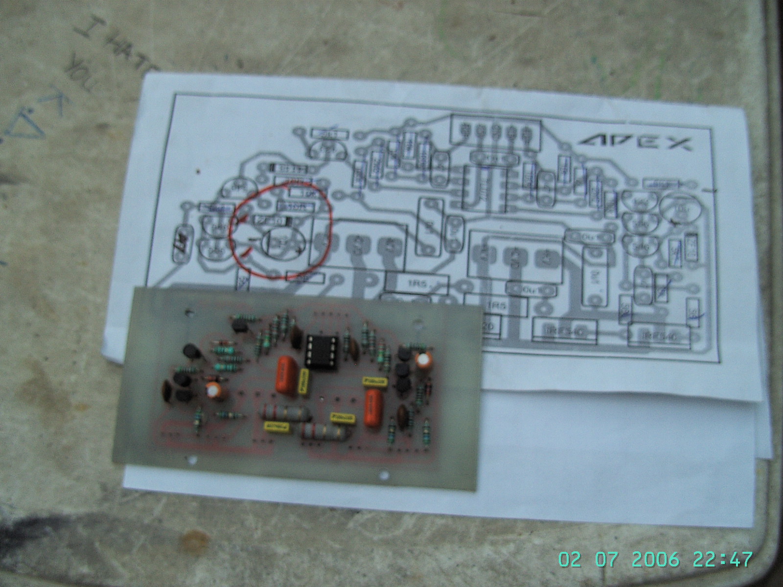

greetings yesterday i tried tlo 72 step driver on opening volume
negative 55 volt condesers blew changed condensers again same problem
is it a case of rail sticking any tips how to solve problem no part of output section was damaged and no abrnormal heating

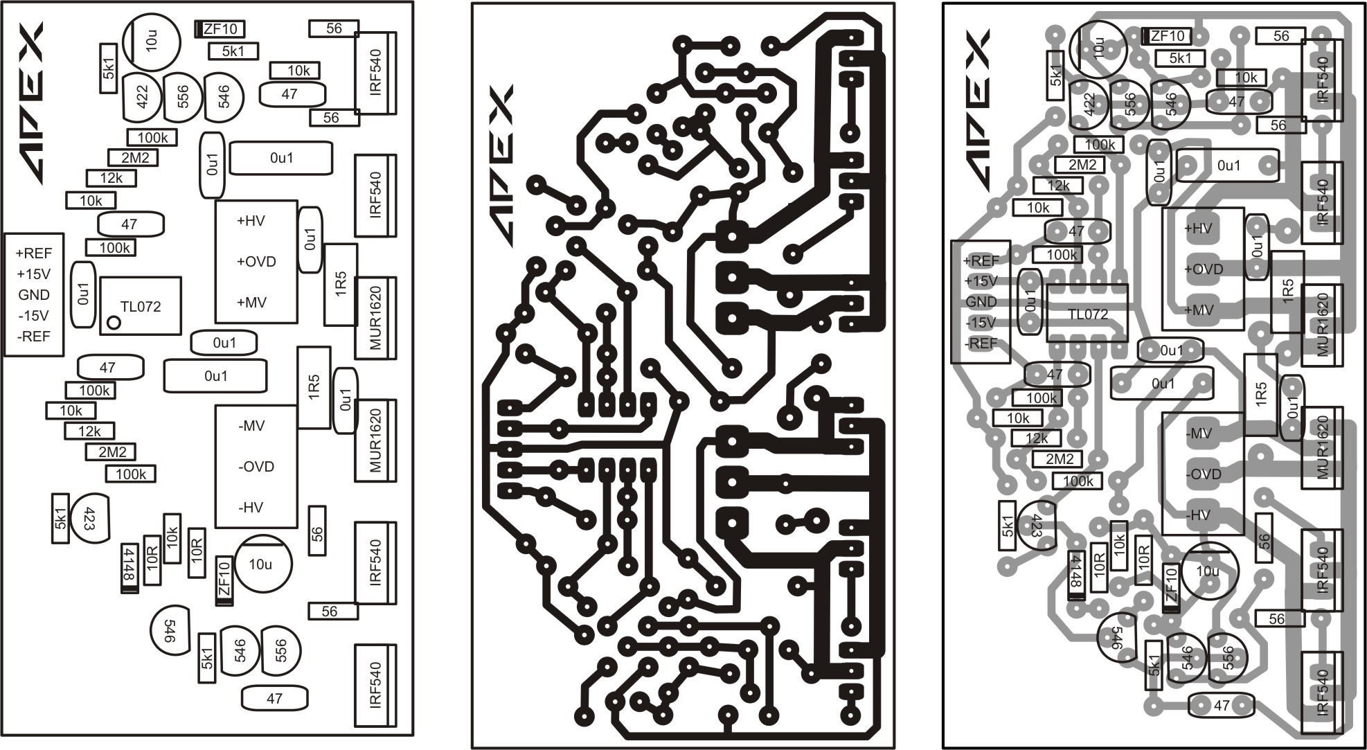

Do you have stabil voltage +/-15V on TL072, do you post clear pictures of step driver? Do you revert wron polarity of 10uF and ZF10 on negative side (mistake on pcb component layout)?

hi apexaudio
greetings picture of step driver pcb and component insertion layout
this is what i have followed are the components circled in red zener 10 volts
and 10 uf polarity wrong

hi apexaudio
greetings thanks once again after revesing polarity of zener and 10uf no smoke tested amplifier on full volume 4 ohm load for 3 hrs amp and step
driver performed flawlessly tomorrow i will start 3 step pcb inserting components hope i succeed
