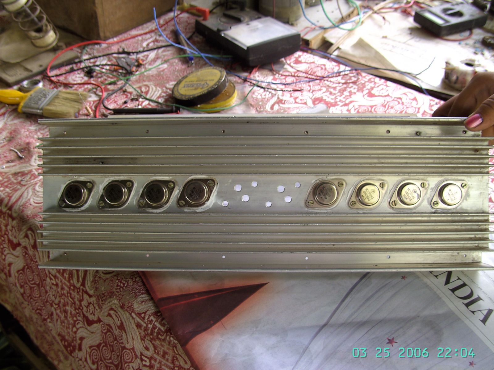

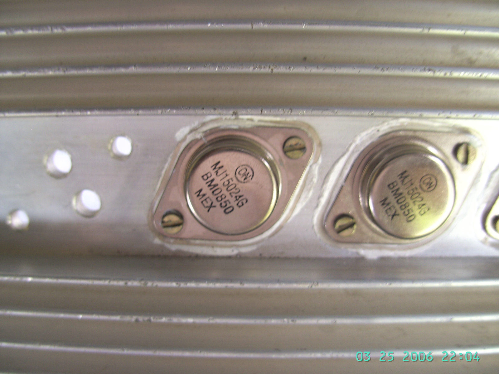

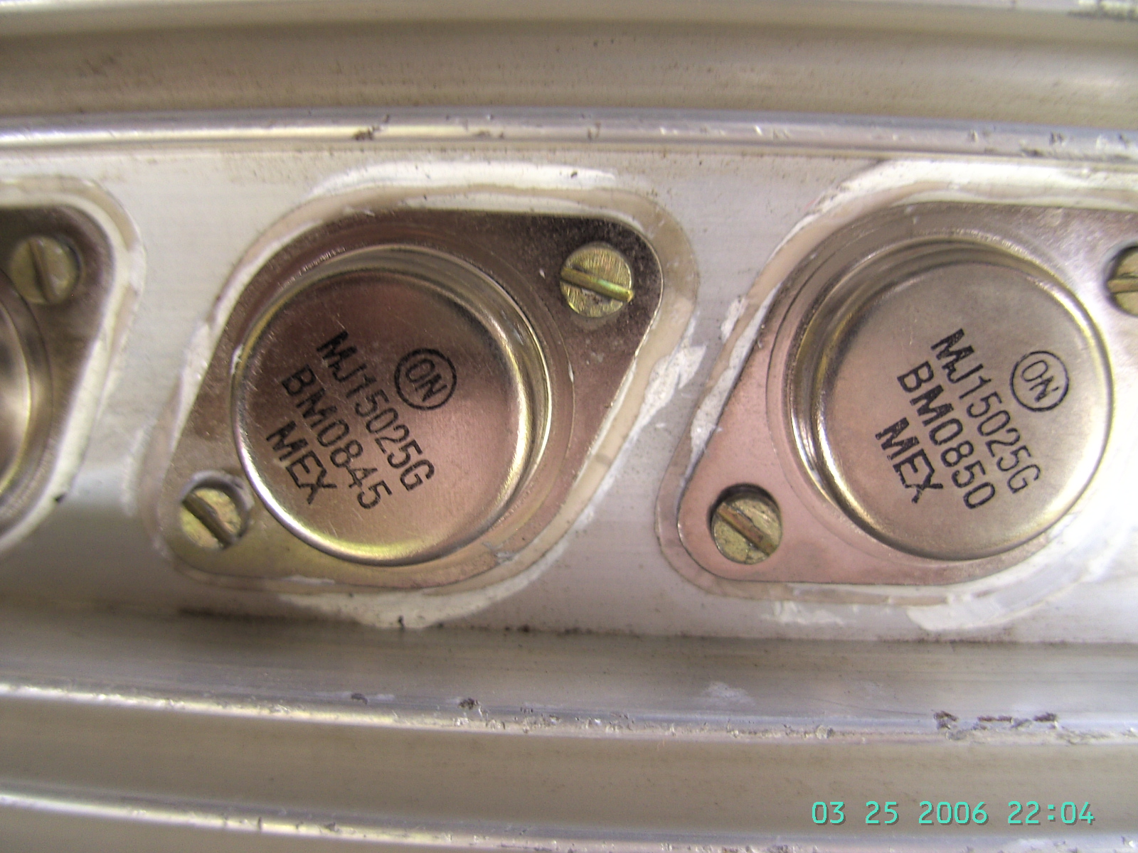

hi apexaudio
greetings H900 with mj15024 and mj15025 is heatsink OK weight is
1.8 kg should i use 4 IRF2807 for full power
thanking you
Andrew lebon
thanking you
Andrew lebon
Hi andrewlebon,
hm, someone with colored finger nails is holding that heatsink. Girlfriend, wife? 😀
Heatsink is OK, and you use IRF2807 for any power if you can get it,hi apexaudio
