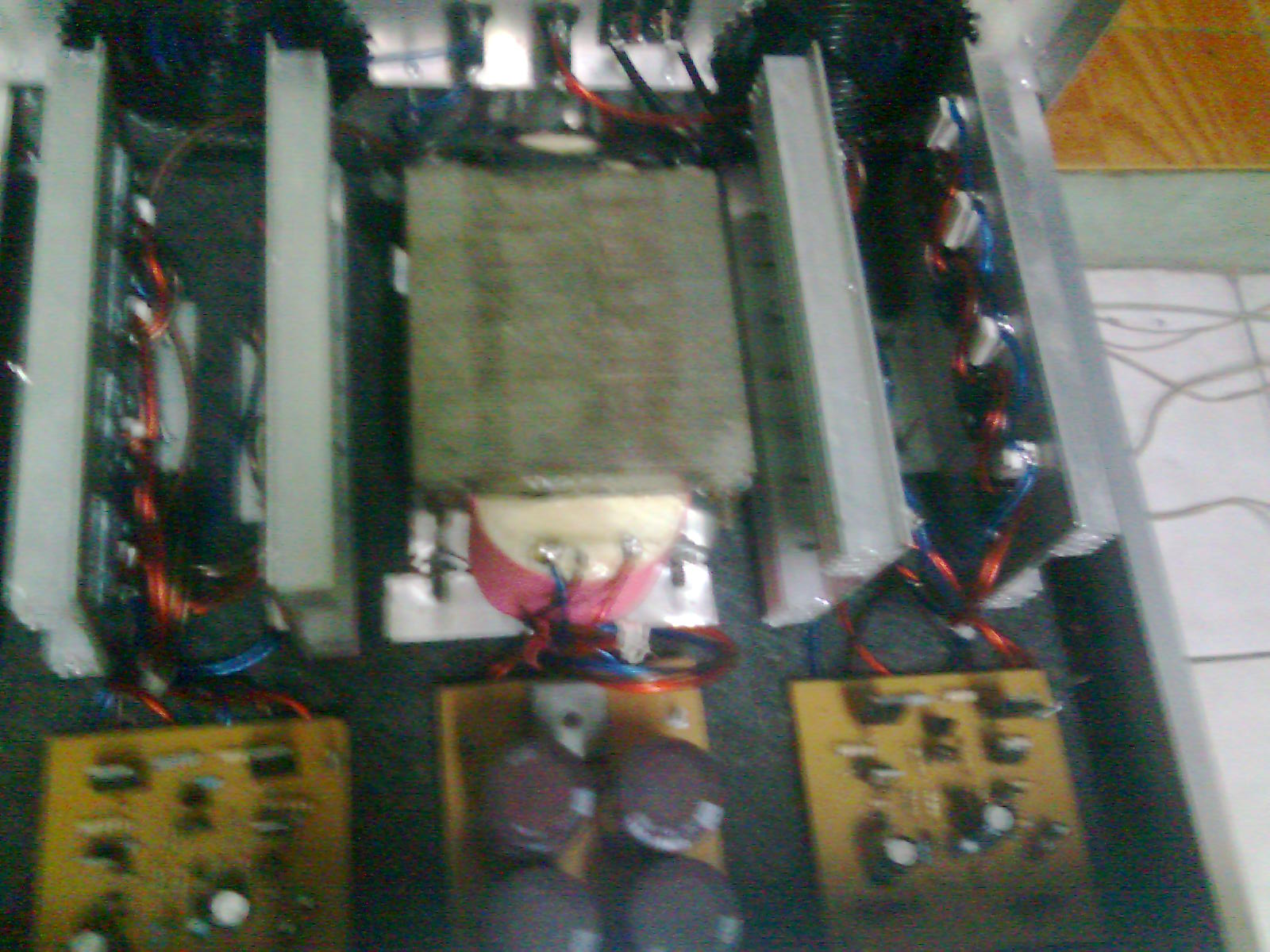

here is one of my DIY amps...

Nice clean work. I can't see is there any protection in this amplifier?ok then...

tnx for the complement...
there is actually no protection circuit built in to it...
only a fuse was attached to it on the output terminal... 🙁
I suggest you to add DC protect with triac after fuse.tnx for the complement...
ok then...tnx...
i already have your schematic diagram bout it...
it's such a poor amp...
no protect, no limiter, only the power amp itself... 🙁
Not poor 4 heatsinks, 2 fans... if it is in use than you add protect for speakers safety.ok then...tnx...
i see...
that would be nice...
but i don't have any protection circuit that matches this amp...
I think there are many protect circuit matches with this amp, here are simplest with triac.i see...
http://www.diyaudio.com/forums/solid-state/164093-100w-ultimate-fidelity-amplifier-9.html
Regards
If you have no "bump" from speakers when power on your amplifier then I sugest DC protect with triac.ok tnx...
i'll check it out...🙂
i dont get what you mean by "bump"...what does it mean???...tnx
No, the "bump" is a turn-on transient. You can't use a triac clamp on an amp that makes a "bump" when you turn it on, because it will activate. On an amp that comes up quiet, you can.
is that the sound produce when i turn the amp on???...clicking the power switch on makes my speakers sound like "toobbb", even if the volumes are zero...tnx
Any sound "toobbb", "twak", "bump"... anti-click on DC protect turn speakers on with 5sec delay becouse of that.is that the sound produce when i turn the amp on???...clicking the power switch on makes my speakers sound like "toobbb", even if the volumes are zero...tnx
