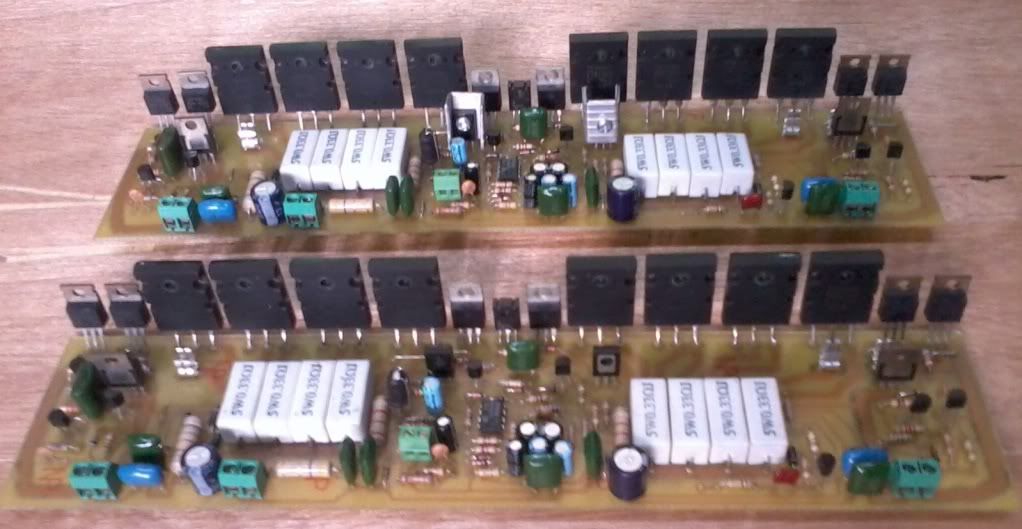

sorry that I ask too much here I was reading through most of this design H900 other members experience building this H900 and I don't have doubt in my mind if I decide to build it I will not regret it I think I over think this way too much I'm just gonna follow the schematic and original layout design and try out if I fail I don't mind at least I'm trying and I'm not gonna post here any more till I got something done ok vargasmongo3435 sign out till I got something that is done not typed 😉

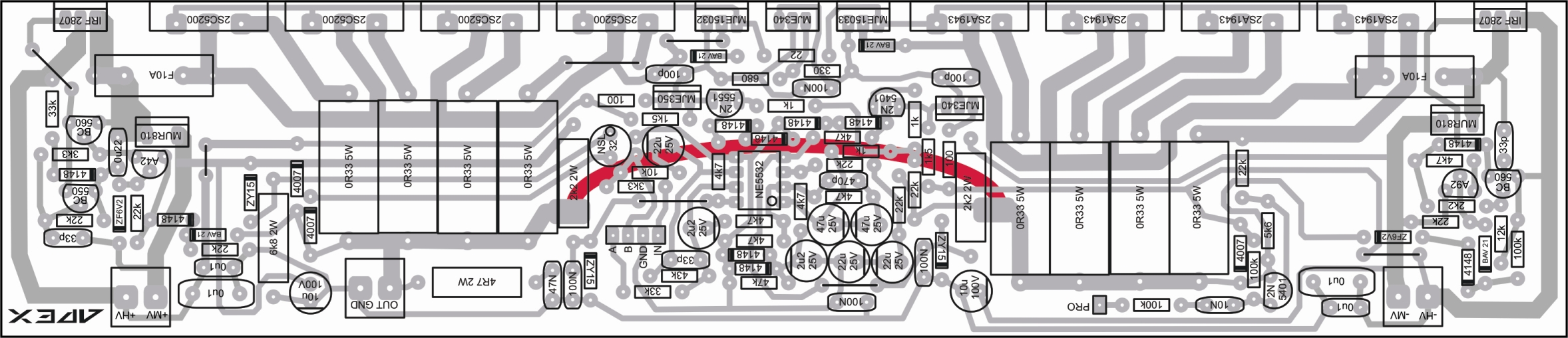

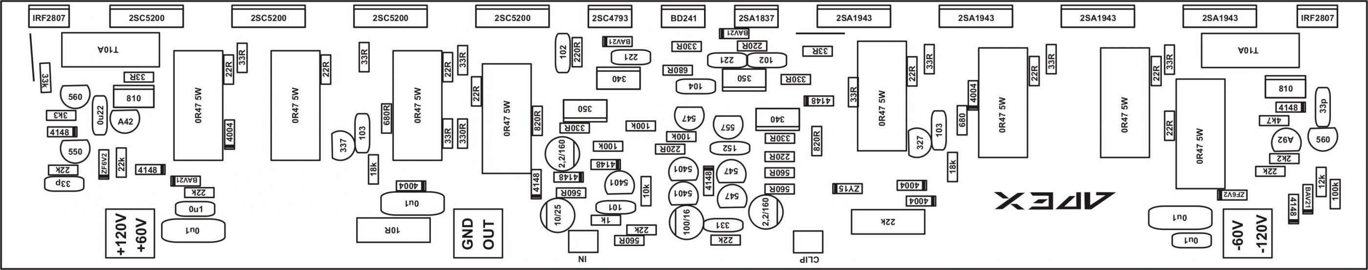

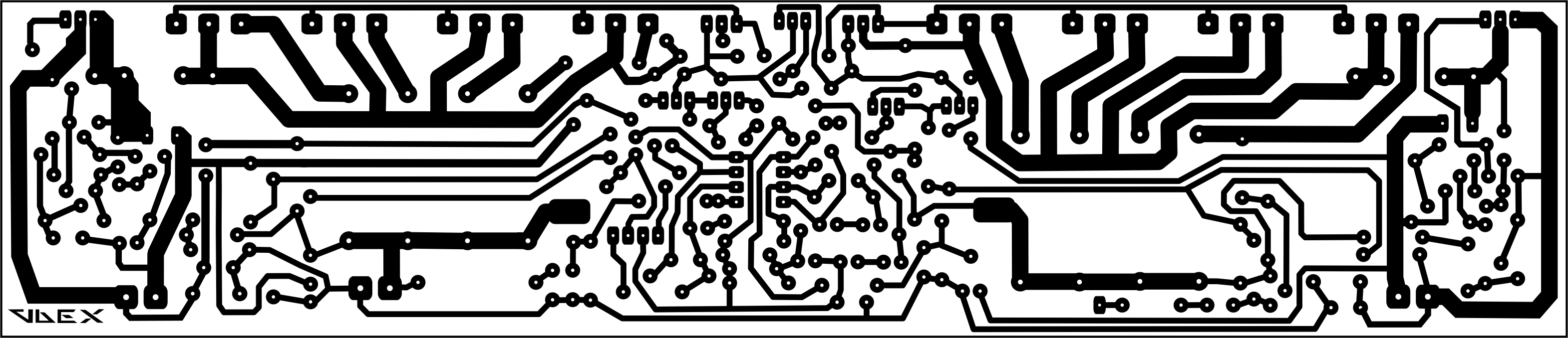

hey guys for those who are using Sprint Layout 6 let me know if you need the Apex H900 file I just re-draw it for my collection if some one need it let me know 🙂

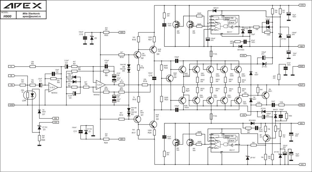

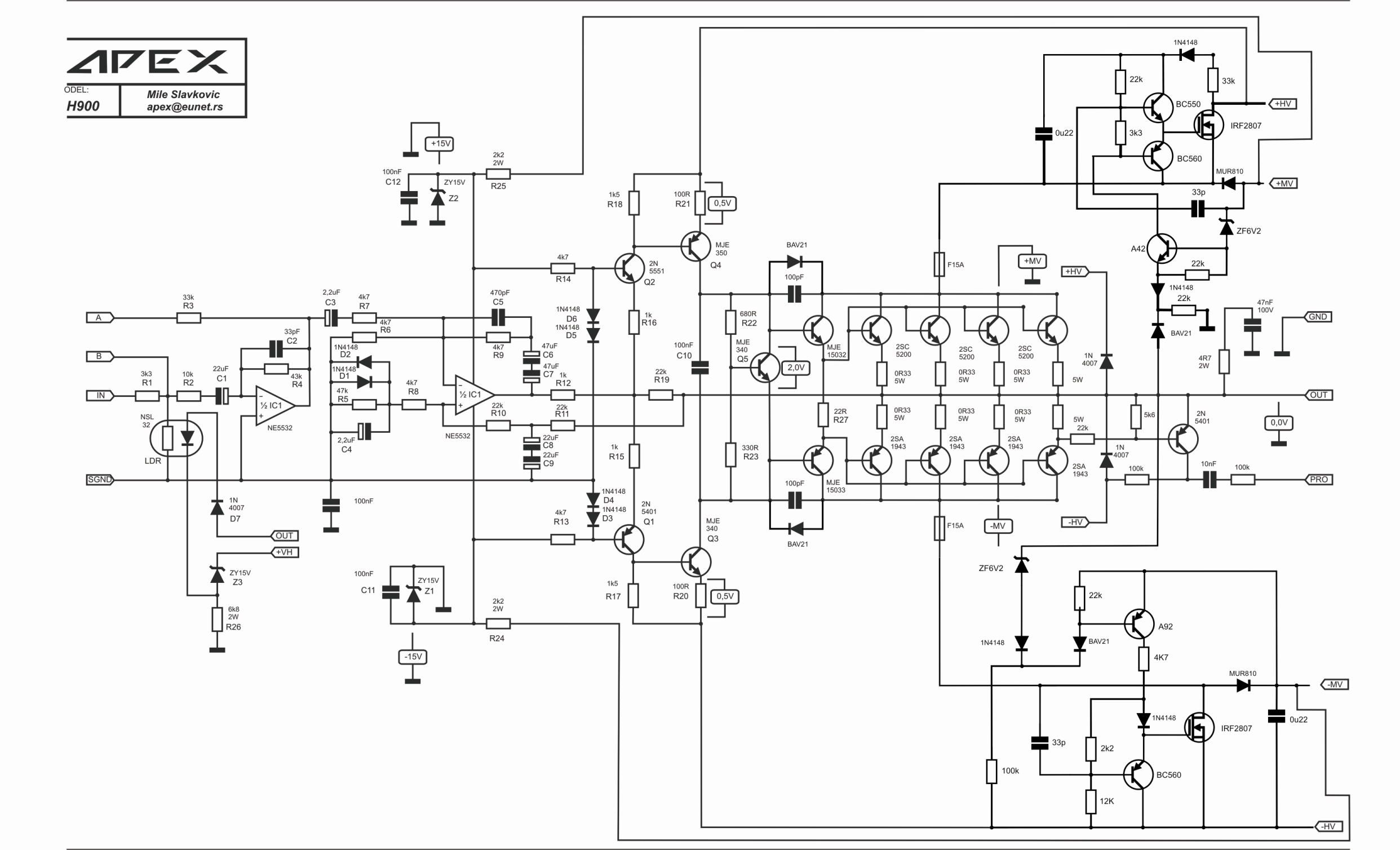

I did this project, but I also have a small problem, the amplifier works perfectly but only on the small RAIL voltage 55v , output only 33v RMS 8 ohm
I measured each piece separately, and it's ok
where is the problem thank you

please ?? where is the problem .. is in the rail mosfet high voltaje ????
The Mosfets, for some reason are not turning on. There are many things that could be responsible for this, even if they seem highly unlikely. Try testing the commutator circuits individually, with a DC voltage instead of the audio signal. Makes fault finding a bit easier.

Have you checked if the output stage sliding voltage tracks the signal good enough? Do you get any visible distortion on the scope when testing with sine tones?

I've tried simulating a minimal version of the circuit and it does not look that promising. The down-converters do not track the signal very well and sine testing at 20kHz and full power may damage the output transistors as the blocking output transistors will get the sum of both rail voltages across them. Distortion performance is not very good either.
However it remains open if that is just related to the simulation or if a real amplifier will behave exactly in the same way.

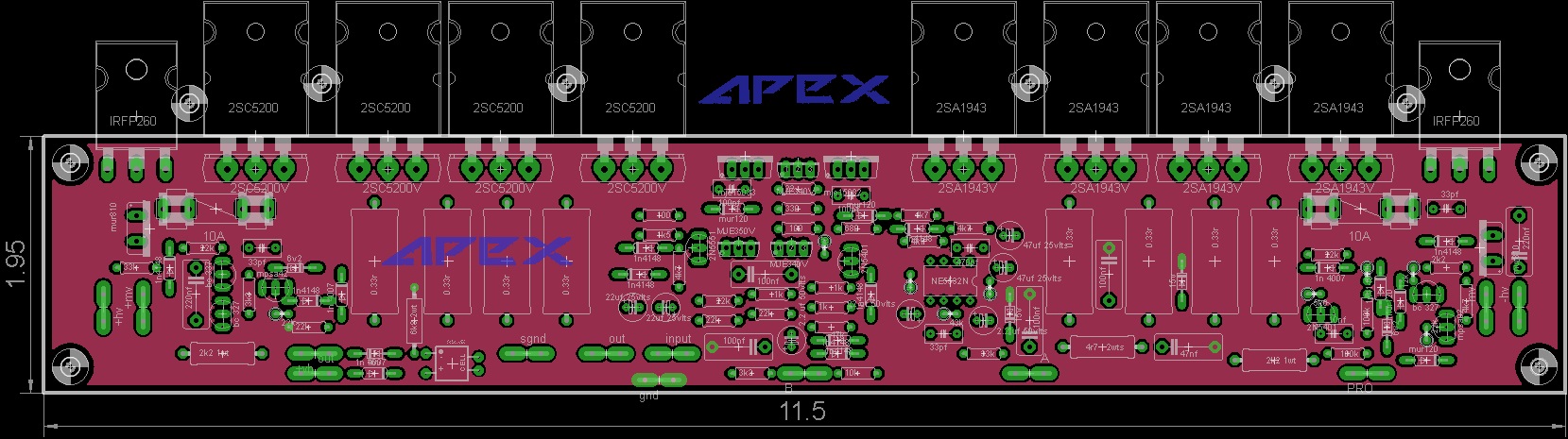

it is apex design , but i redesigned the pcb to suit my needs😀.
check the below files and also go to post #1680 , #1996 , #2578 , #1346 and #3597 #3598
