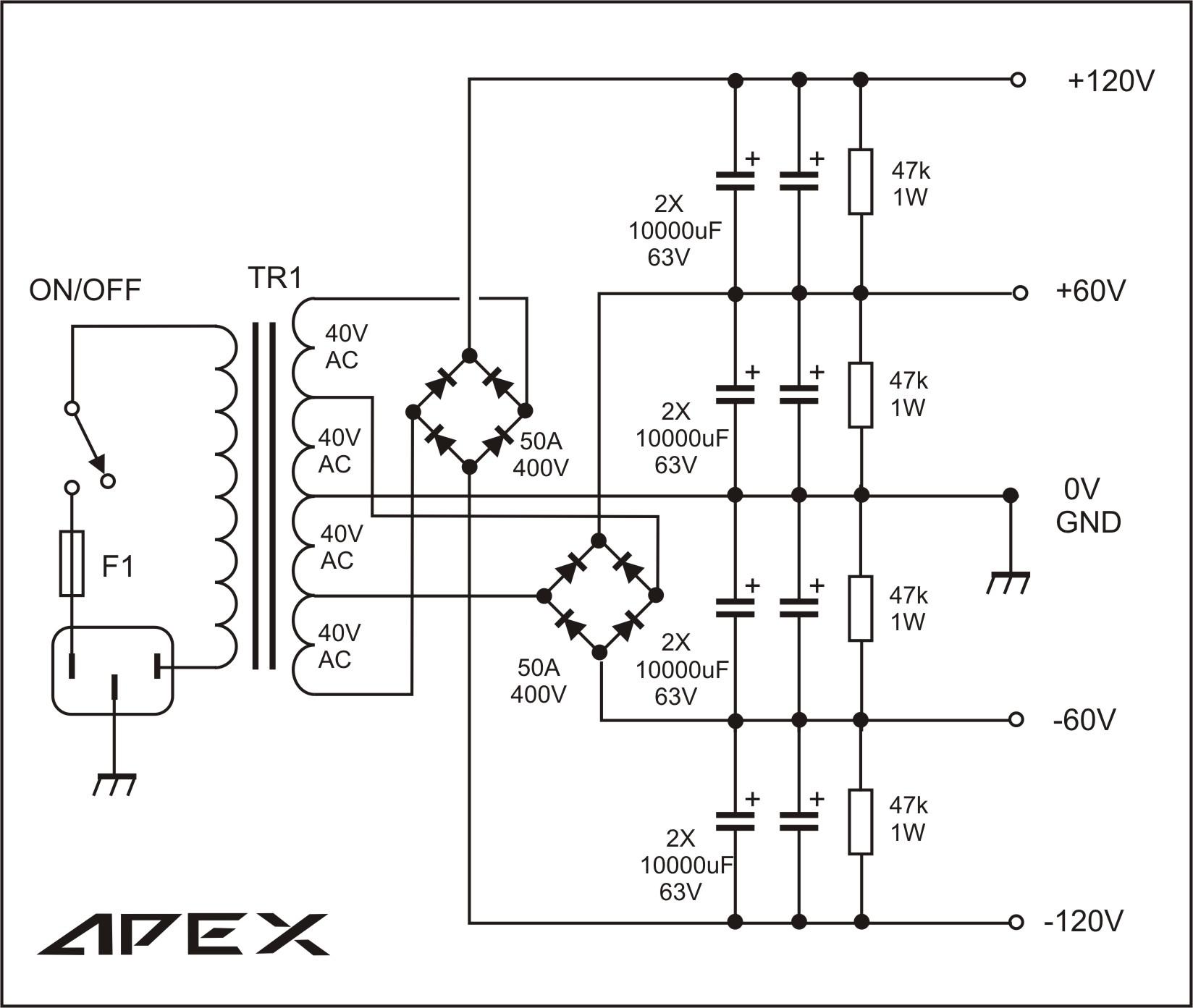

Hello Apex audio, can i built this H900 with supply 40VAC and 45VAC ? With 8x10.000uf how much result of VDC?

Hello Gantex,
That's gonna be 56.56VDC and 63.63VDc respectively.

thanks for your replay neil, is that single rail? can i use it?
if i use this apex psu class H. How much result VDC? Its same or not? I see some defferent here, please check this?
In my APEX H900 I am using 4x45V AC, and it works fine!

hello antonamp, thanks for comment. How much VDC u get if use 4x45VAC. I mean for HV and MV ?

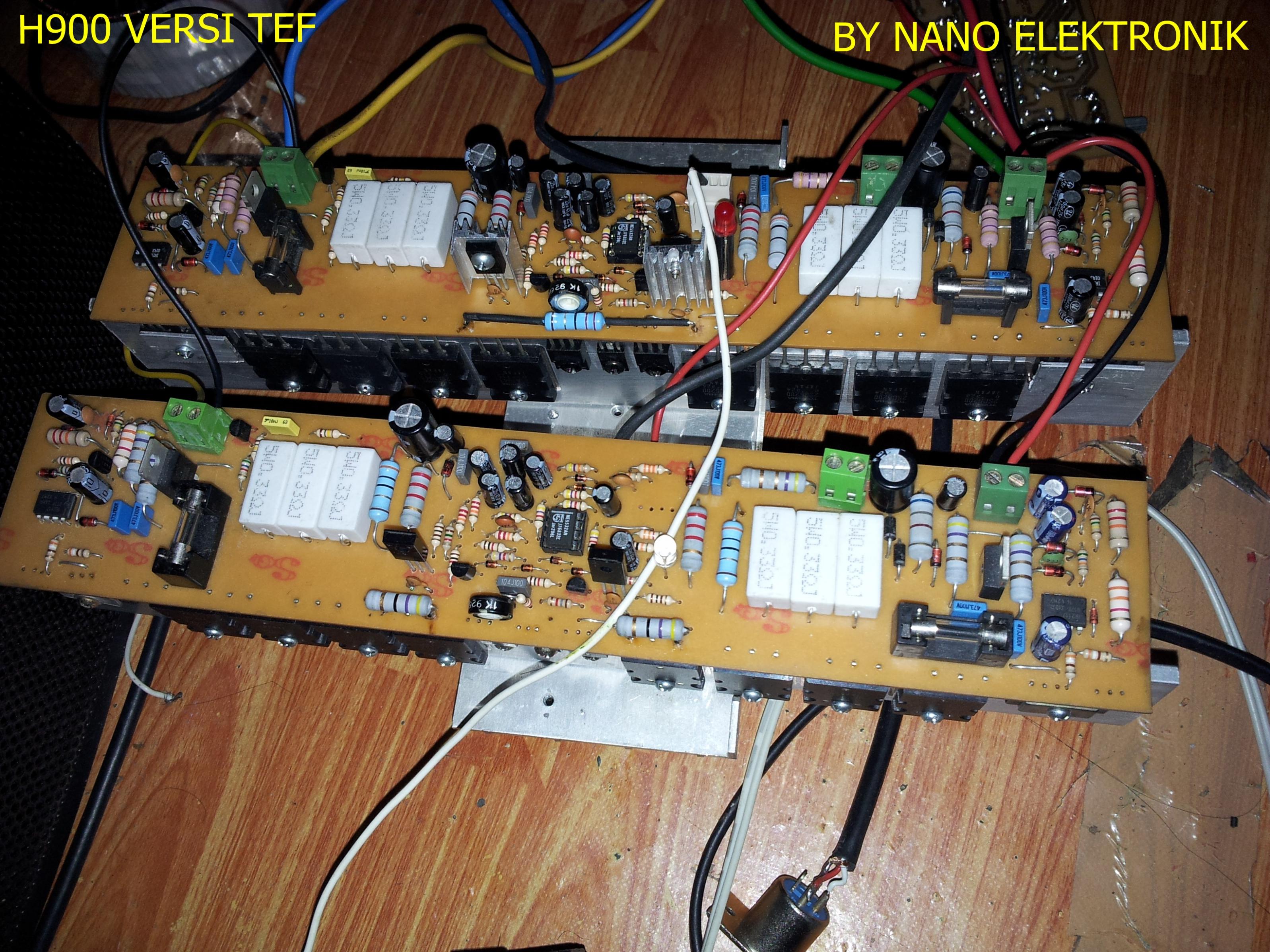

hi to all i need your expertice i have problem with my h900 version2 ..my High Voltage not working always in mv ,but sound good.. i used mur1640 instead of 1620 and ksp92 instead of bf421. pls check picture above. thanks..

even u check your ksp92 is different pinout, ksp (EBC) bf(ECB).

yes .. is this correct??
and how i know that my step voltage are working? i have only DMM thanks morning.
U can check HV on final supply, HV result can work if u change the volume. Change volume step by step, and u can see HV depend ur volume control. Sorry for my laguage 🙂.

can u share of pic bottom layout.?
Proper connection of driver collector is to step rail.
Regards
he mean is MV. Coz driver is part of final rail. Sorry if iam wrong.

I have 125,4VDC,-62,5VDC,-0-, +62,5- ,+125,4VDC

Connect LED+10k resistor parallel with the MUR1620. It will be no light without signal, but it will flashing if the step driver is working.
I can give the schematic if you need it.
