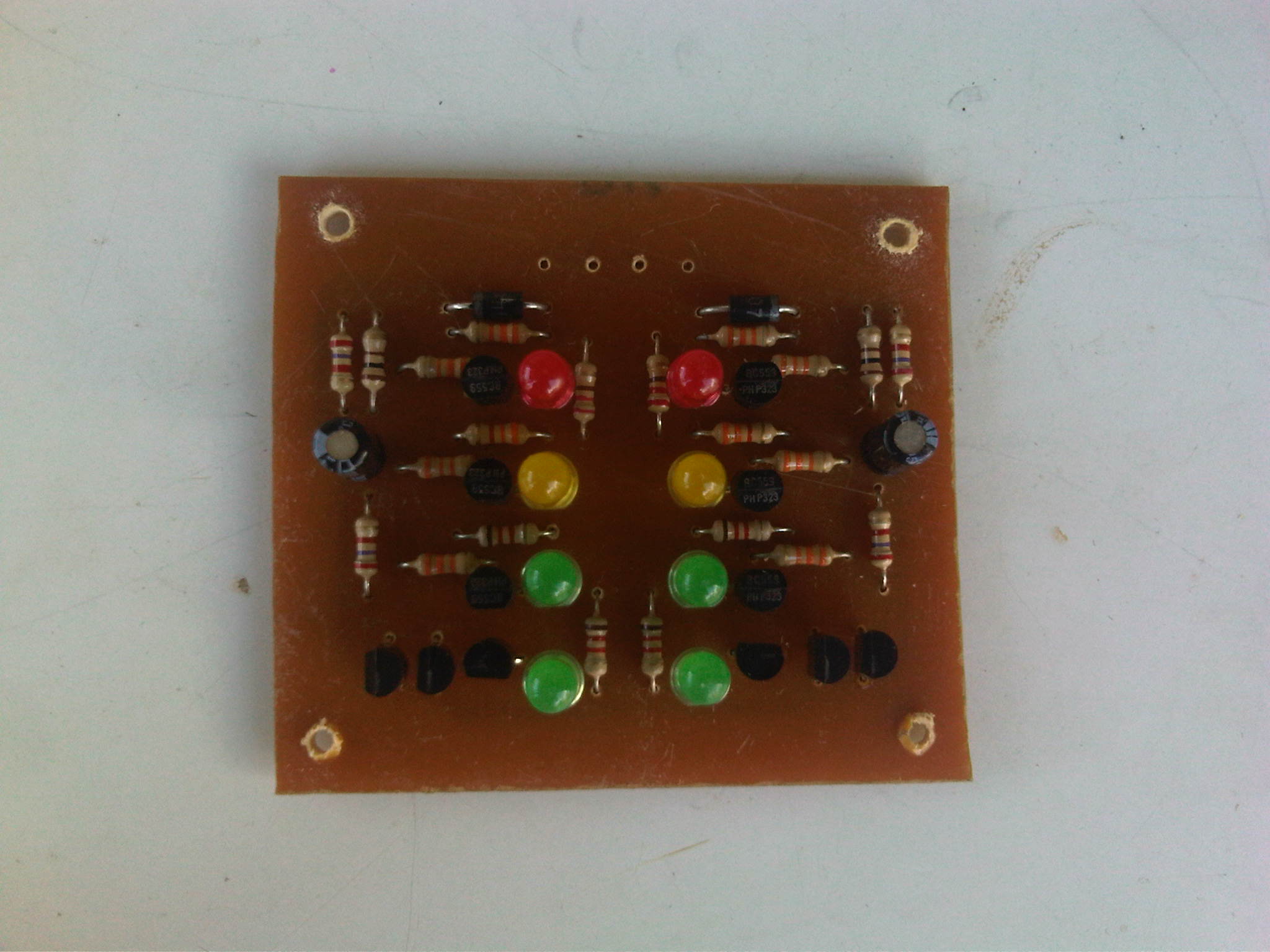

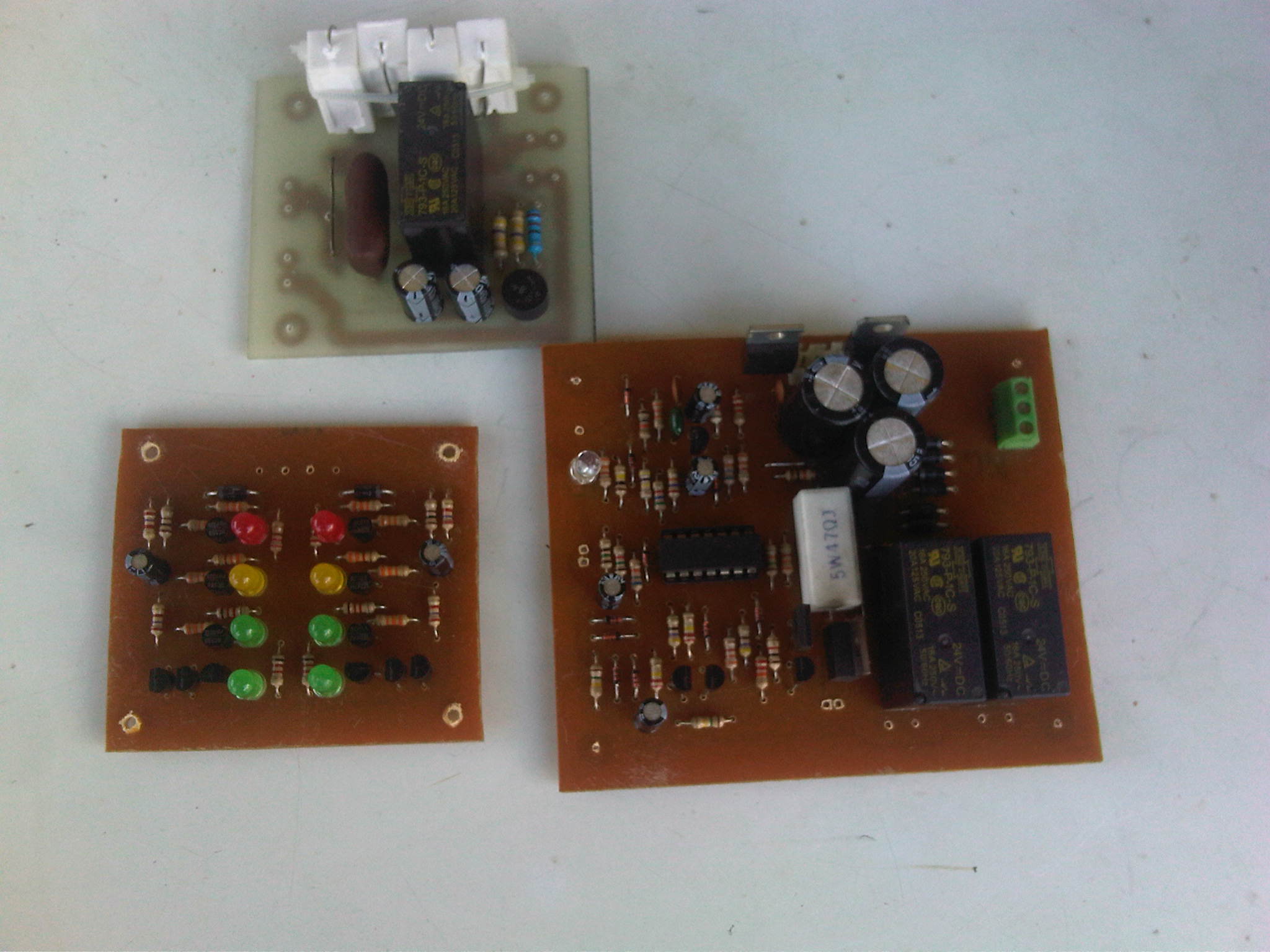

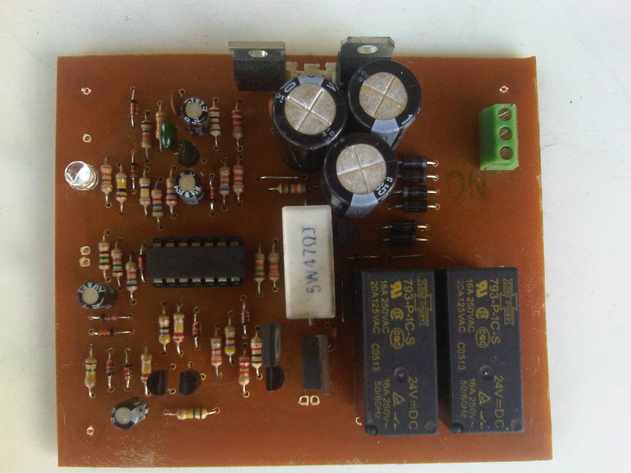

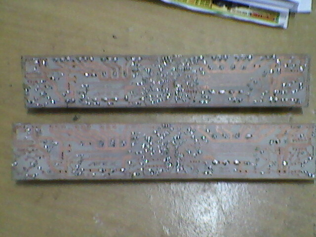

It's..PCB H900TEF design by Soerjanto.......

Hello Rizqi,
Thanks.. This design have not been tested yet i'm still trying to find some error before i etch, but you can also review and let me know if you found any mistake so i can correct the error.
Send me your email add so i can forward you the sprint layout file.
Regards
Your layout is correct but adjust as the distance between the10uF160v 10uf63v...still less loose... nice😉

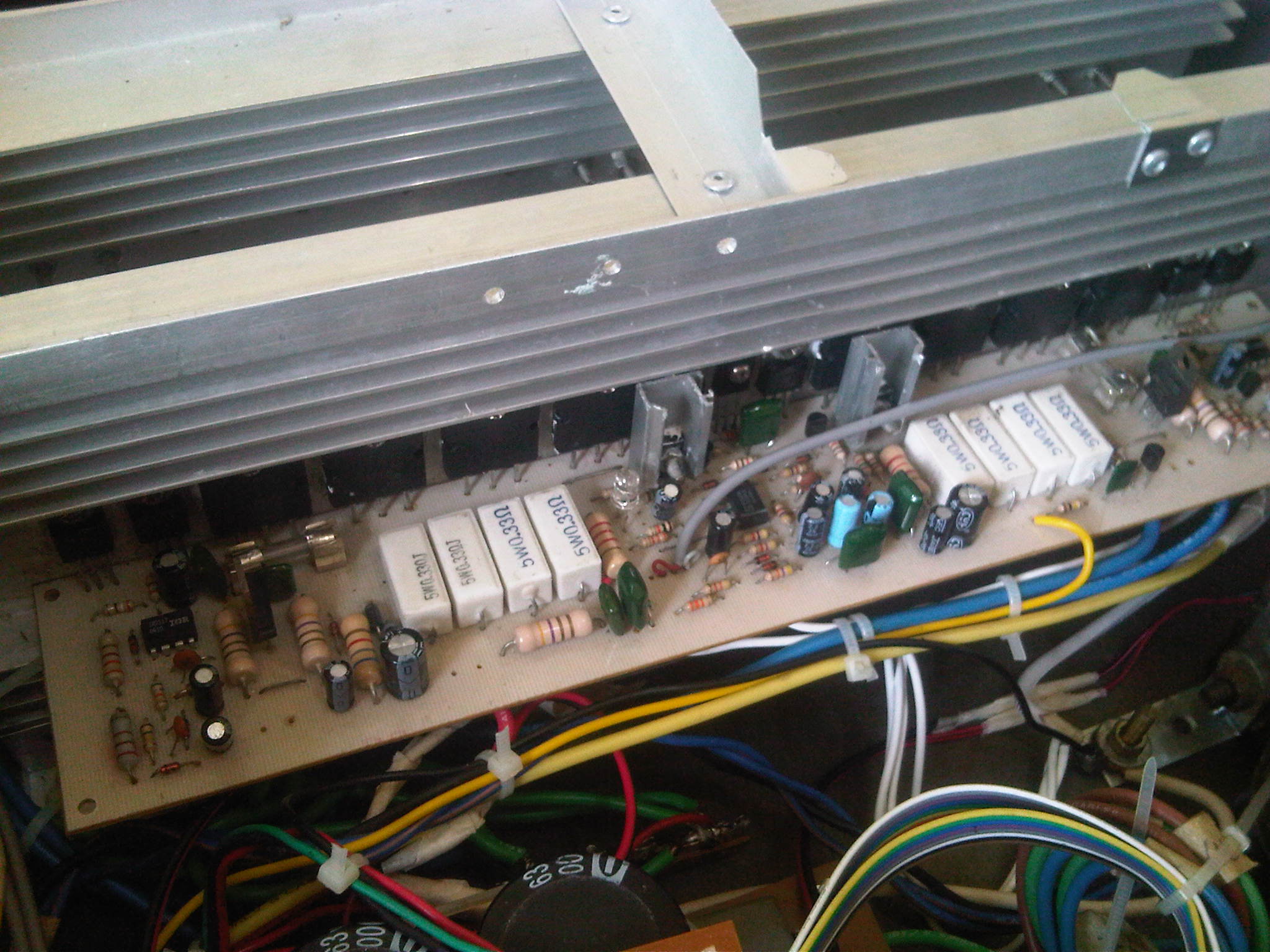

It looks very very nice! How much power have you acchived and how good do those heatsinks cool it down? I am asking because i am trying to build one 500W amp so i need some guidance,clue how big the heatsink should be for that power.

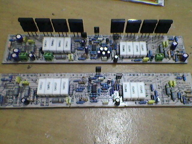

Hi mr. Mile .... I have built 2 units of Apex H900
and now I am building a 3rd H900 apex with two transformer-30 Amphere 55vac-47vac-0-47vac-55vac. and 4x10000uf 75V (Sprague).
My question is: can use 95vac-47vac-0-47vac-95vac?
output transistor using original MJLJL3281A (NPN) MJL1302A (PNP) ...
thanks and regards.

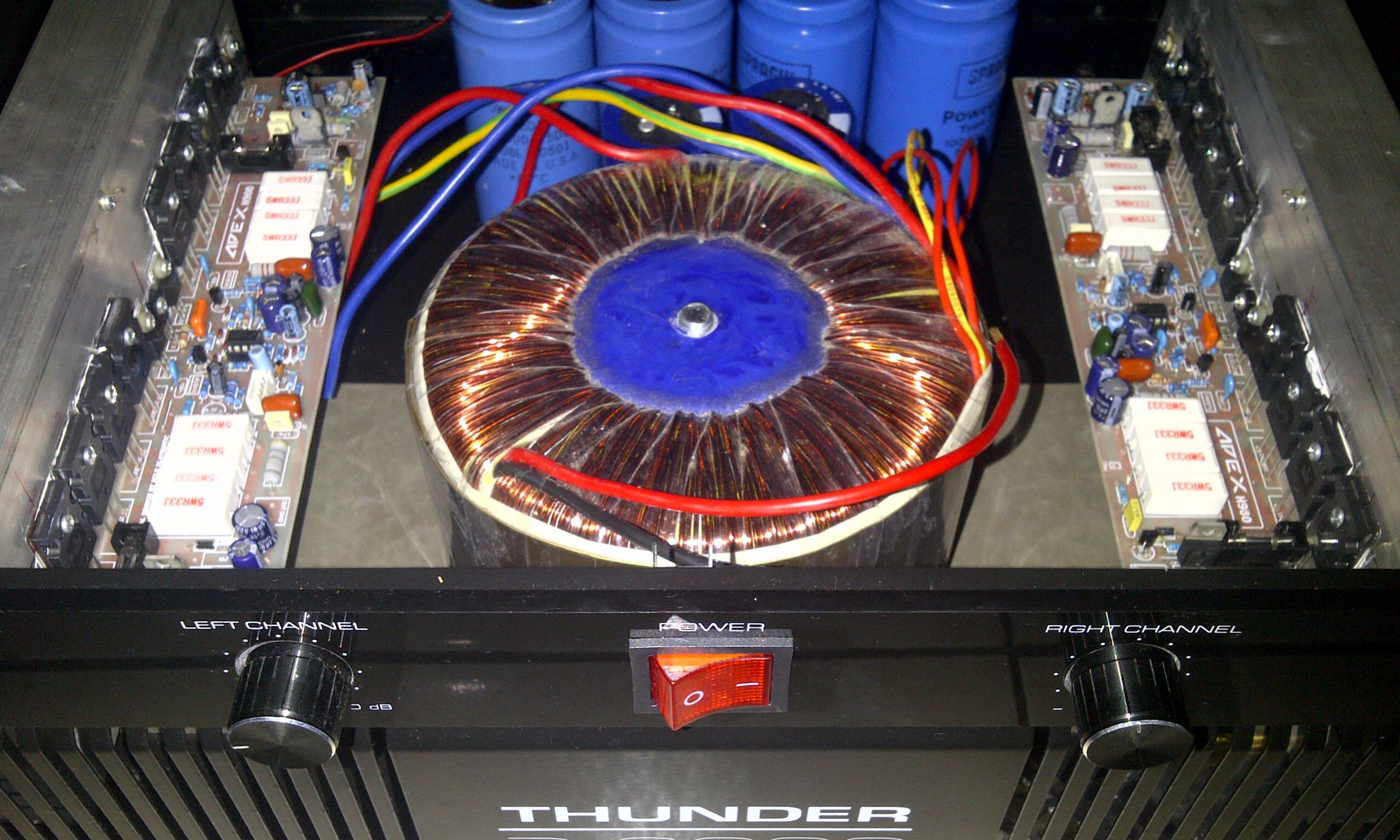

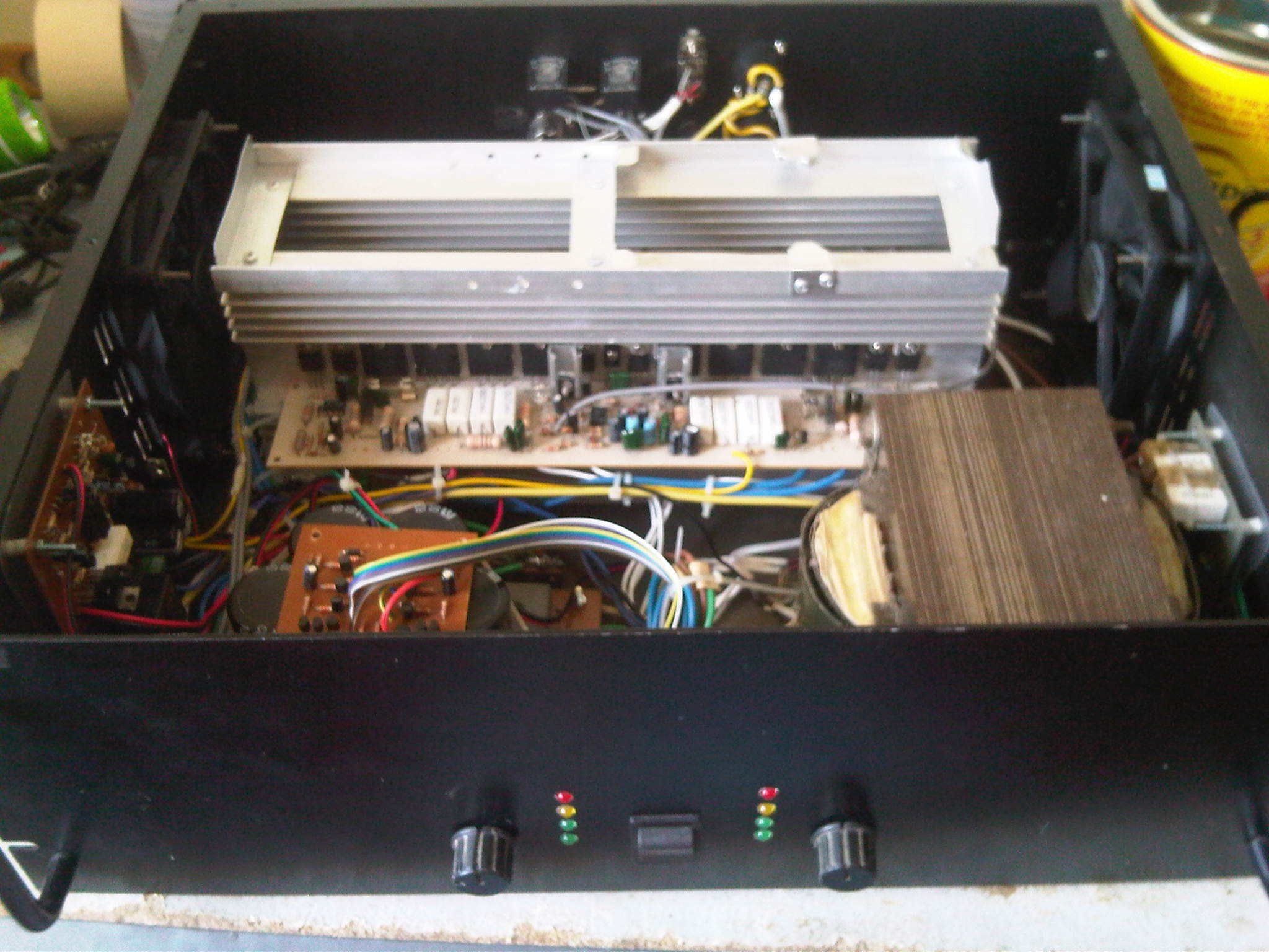

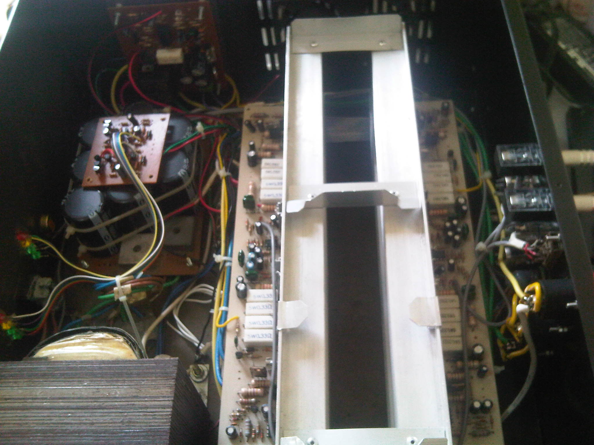

3rd H900 - my Project 😉
30A transformator 80vac- 40vac-0-40vac-80vac
output transistor using original MJL3281A (NPN) MJL1302A (PNP)

Nice work, I sugest to rotate modules 180deg (heatsinks near transformers.
Regards
Regards
That is good suggestion-even the tunnel would be better formed so more air would go through heatsink(s)!
