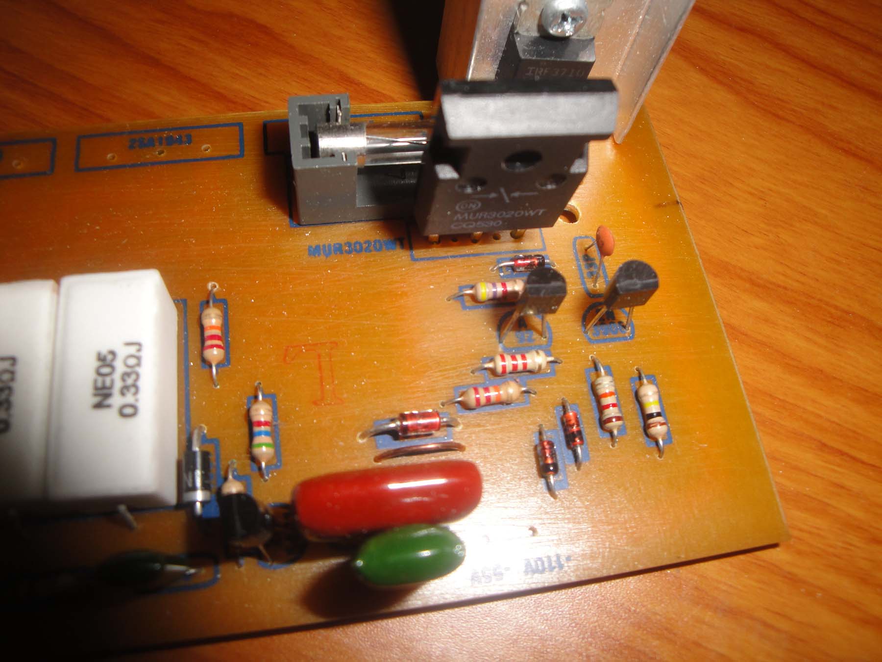

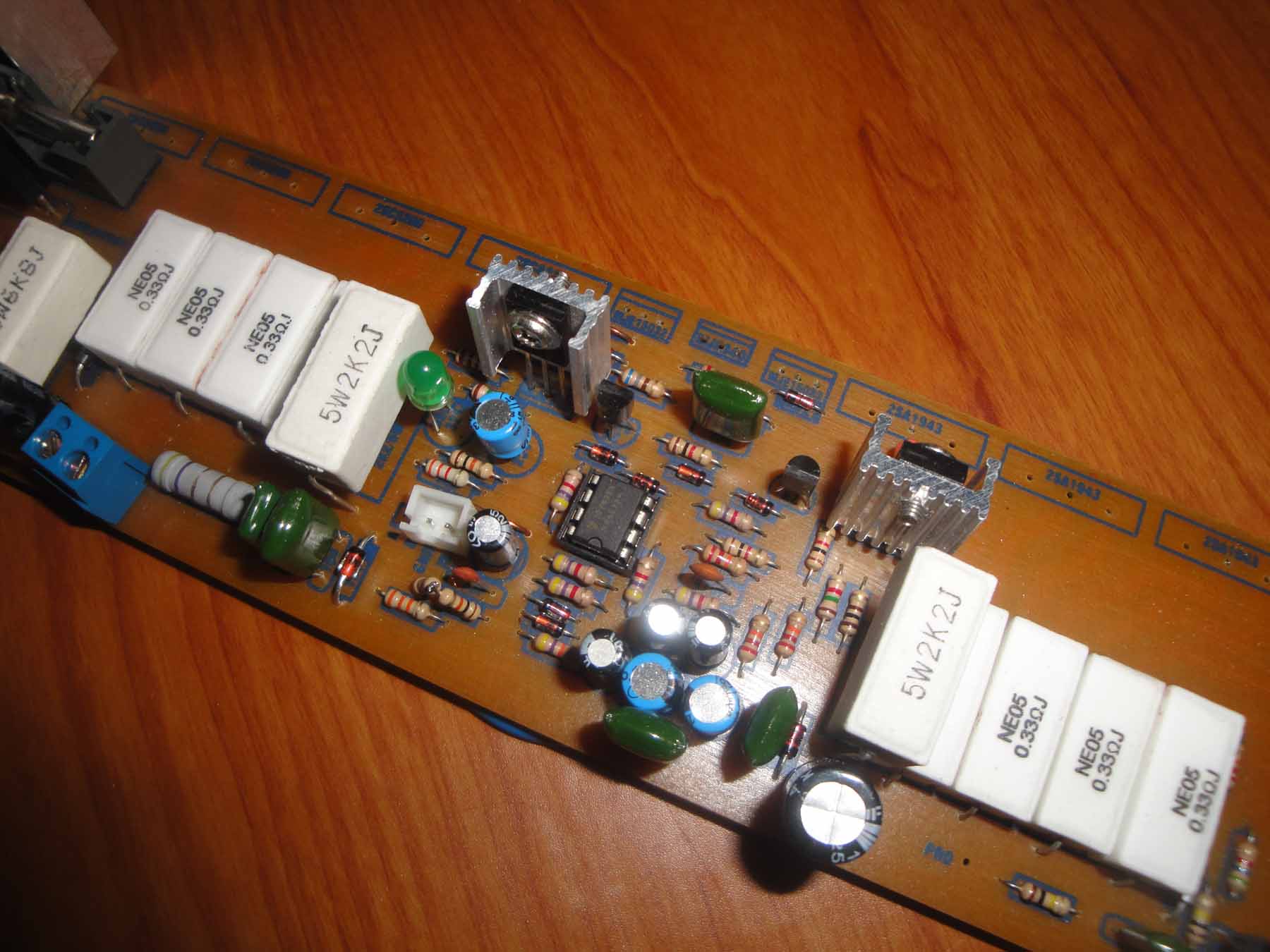

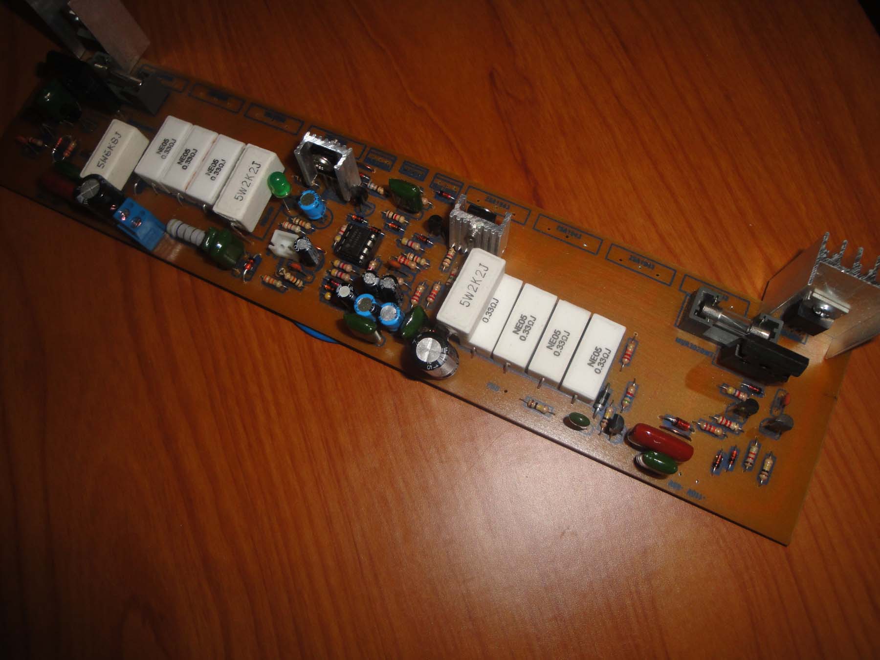

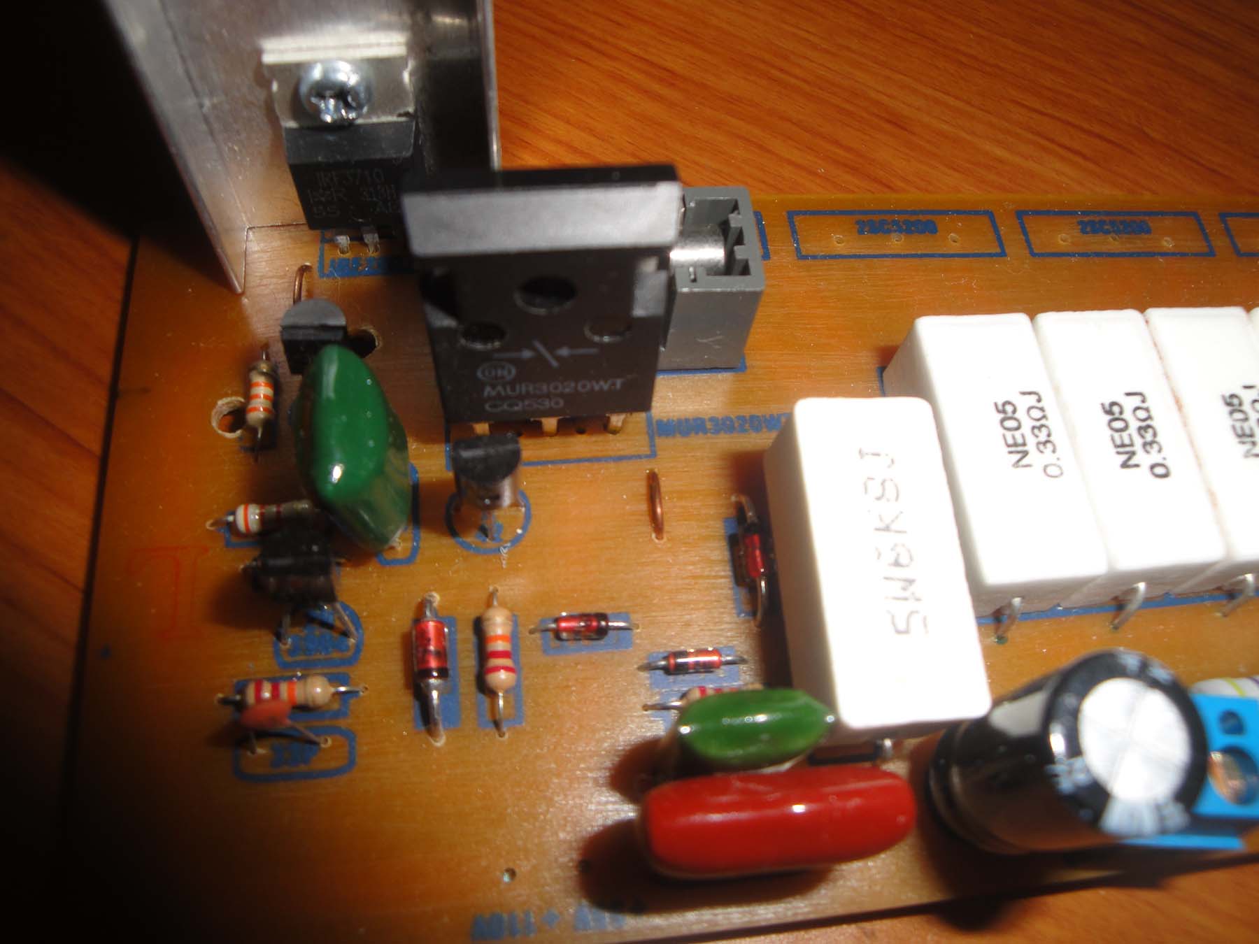

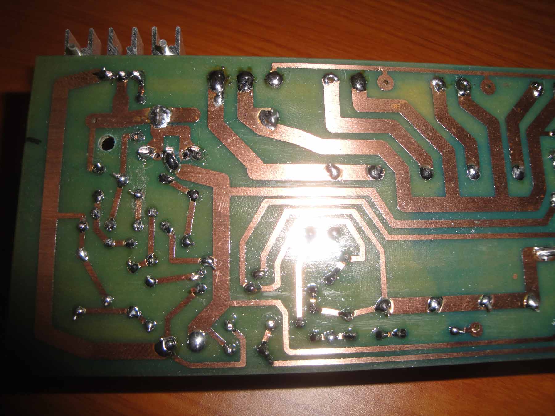

hi ser apex
i try to creat H900
i use + -25 and + -50 VDC for test
it was worked wen i conect low voltage but when i conect Hi voltage the 100 ohm ressistor hase jenerate smoke
i linked a picture here
http://img4up.com/up2/08747272294675884912.jpg
please help creat that eror
thanks

Congratulation...😀i was findout solution
i was use rong pcb and layout
thanks boys

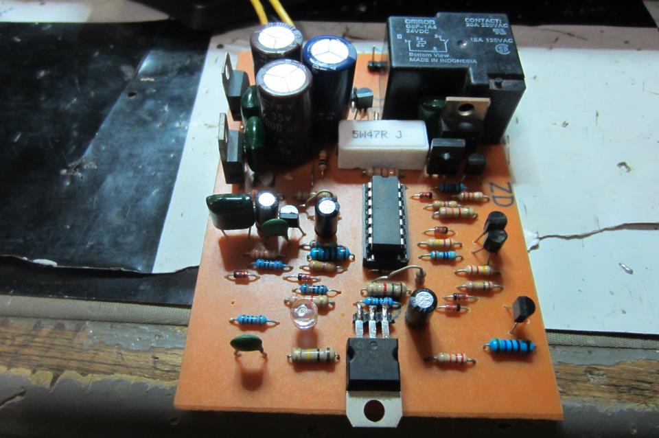

finally finished also protect the speakers that I created using APEX design, thanks Mr.Mile has given a good component layout, I just change the model of the relay without any change. relay works fine. IC 7912 and R 5W 47R hot, is there a problem? beg the help sir.
http://sphotos-c.ak.fbcdn.net/hphotos-ak-ash4/407695_4880626299016_1734733296_n.jpg
measure the voltage across that 5W 47R resistor and than calculate power disipated on it by the formula P=R x I^2. if the power calculated is larger than 2W than you should use 7W resistor.
power disipated by 7812 is also easy calculated by measuring voltage between in/out pinouts and multiplying it with current flowing through it. if the power calculated is smaller than suggested by manufacturer than just add a heatsink on it.
